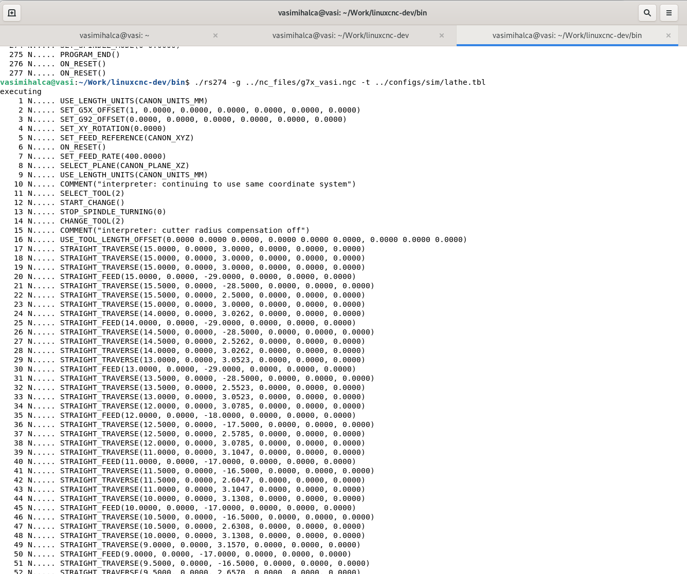

It is not clear to me yet how did you handled the displaying of the gcode in your JCNCScreen.
What interpreter are you using to get the data that you need to render?
Would the same approach work for me?
The way I understand this is the following:
- interpreter takes the gcode file, and based on the ini, tbl files it inteprets the file and produces a set of lines and arcs that can be drawn.
- using the position info from the status channel, you render the tool inside that plotting at the correct coordinates.
- by not using exactly the same interpreter as linuxcnc does internally, we can't be sure that what we see rendered is what will actually look like.
- if the linuxcnc standalone interpreter would work, is that the same with the internal interpreter?
Sorry if I am asking silly questions, but just by reading your comments I can clearly see that you have waay more knowledge depth that I can imagine for now.
I have noticed that the stand alone linuxcnc interpreter documentation was updated in 31th of january this year, so literally yesterday.
Is this the standalone interpreter that you were trying to use and has hardcoded units?
linuxcnc.org/docs/html/code/rs274.html
I have not yet pulled & built the last sources of linuxcnc, but I've made a test run for the standalone interpreter and I got the result in the screenshot below. Are you using something similar to render your plot? Can you please give more details about that?

As said, in the java app I use the provided interpreter executable from linuxcnc. Similar commandline than your log.
I started the interpreter in a new process and parsed the textdata from pipe.
I struggled several times with different output between axis (my reference) and my code. Then I found out, that the standalone interpreter is different from the one that is used by backend (taskmanager).
Just compare src/emc/sai/saicanon.cc with src/emc/task/emccanon.cc
I had to realize, that standalone interpreter is hardcoded to imperial units. If your machine works with imperial units, that might work for you. I'm used to mm, so position calculations where wrong. Another difference is, you don't get the line number in interpreter output. But my progress calculation during auto processing is based on line numbers.
Therefore I had to patch gcode input with sequential numbers N# - which the interpreter tells in output. Some commands lead to multiple steps with the same line number.
You can have a look at class RS274Reader to see, whether it might be useful for you.
I stopped frustrated development of my java app, when I realized, that there's too much missing in output from provided executable. That was one reason, why I started my Qt project.
In the beginning I had both paths available: using standalone interpreter and parse the output or create an internal instance of interpreter. The differences where too big so I stopped using standalone interpreter. Additionally the parsing of the textoutput from standalone executable was about 100 times slower, than internal interpreter.
The drawback of the internal interpreter - I had to care for all the data and function callbacks to satisfy interpreter.
That was another period of frustration and headbanging - but meanwhile it works. As far as I can validate it.
In the mean time FalconView has more functionality than the JCNCScreen.
No! I don't do that.
I create the graphic objects on parsing output from interpreter, so when the interpreter is ready, my workpath is already painted to canvas.
When the automatic processing runs, I select the graphic objects based on the line number. Only the tool is advanced based on the position from status area.
