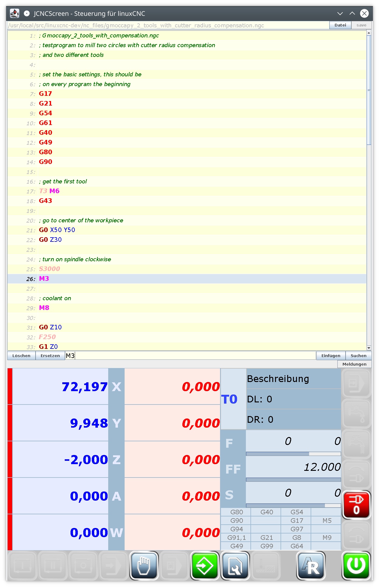

16 Jul 2021 02:45 #214999 by vmihalca
Replied by vmihalca on topic Java UI for linuxcnc
I have switched to master-gtk3, successfuly ran
./configure --with-realtime=uspace --with-python=python3 --with-boost-python=boost_python3-py37
make
sudo make setuid
If I type linuxcnc it opens, the configuration selector.
In the JCNCScreen folder, I have made sure I have the latest sources, ant dist, then switched to native and tried to make TestNML, but unfortunately, I have the same error as before.
vasilemihalca@INV1047:~/Geeking/JCNCScreen$ cd native/
vasilemihalca@INV1047:~/Geeking/JCNCScreen/native$ make TestNML
g++ -DLOCALE_DIR=\"/usr/share/locale\" -DPACKAGE=\"linuxcnc\"  -L/home/vasilemihalca/Geeking/JCNCScreen/native/lc/lib /home/vasilemihalca/Geeking/JCNCScreen/native/lc/lib/libnml.so.0 -Wl,-rpath,/home/vasilemihalca/Geeking/JCNCScreen/native/lc/lib -Xlinker -Map=libLinuxCNC.map -L/usr/X11R6/lib -lm -lGL -o TestNML TestNML.o /home/vasilemihalca/Geeking/JCNCScreen/native/lc/src/objects/emc/nml_intf/emc.o /home/vasilemihalca/Geeking/JCNCScreen/native/lc/src/objects/emc/nml_intf/emcops.o /home/vasilemihalca/Geeking/JCNCScreen/native/lc/src/objects/emc/rs274ngc/modal_state.o /home/vasilemihalca/Geeking/JCNCScreen/native/lc/src/objects/emc/tooldata/tooldata_common.o /home/vasilemihalca/Geeking/JCNCScreen/native/lc/src/objects/emc/tooldata/tooldata_mmap.o /home/vasilemihalca/Geeking/JCNCScreen/native/lc/src/objects/emc/tooldata/tooldata_db.o

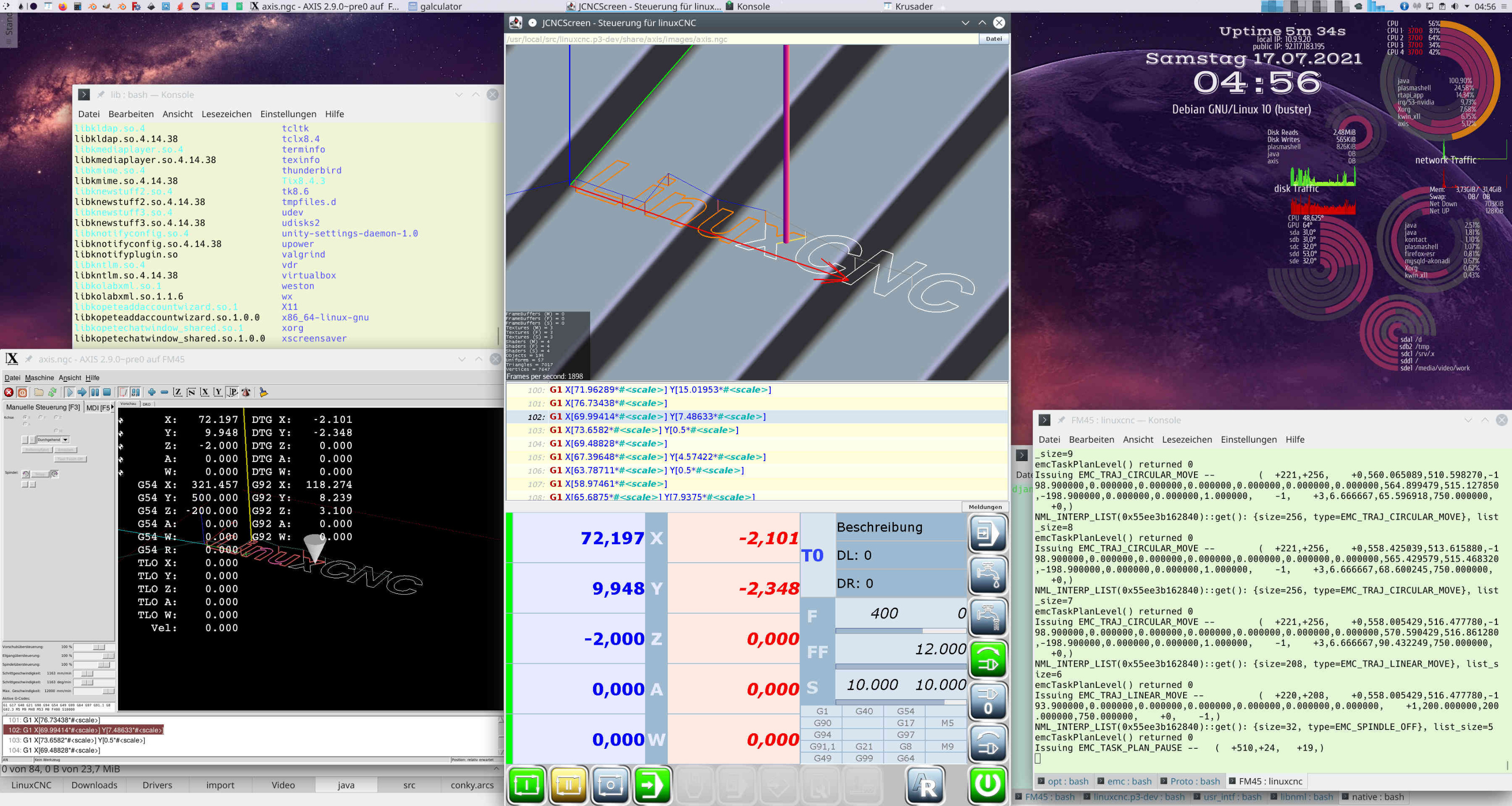

Here a picture of my test-setup in action:
I call the rip-environment script from my home directory and then I started linuxcnc with axis and a simulated 5-axis mm machine. On the second workspace runs eclipse ide, from where I started JCNCScreen.
Axis runs synchronously with my app and I used my app to turn machine on and start executing gcode script.

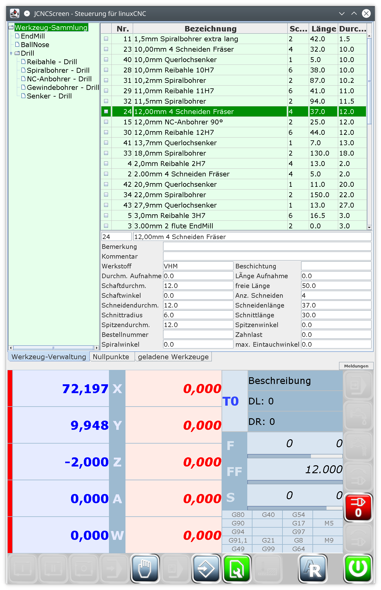

Here you see the tool-manager:
it uses a database and you can order your tools at your will. Create the categories you like and then add the tools. I idea was, that if you have a toolchanger, you might have more tools in collets than your toolchanges has pockets. You might want to save the tool-parameters of tools not actually loaded into machine.
And you might want to have a single database, where all your tools are defined.
With the different export-handlers I actually can export (selected) tool definitions for
  • linuxcnc
  • CamBam
  • DeskProto.

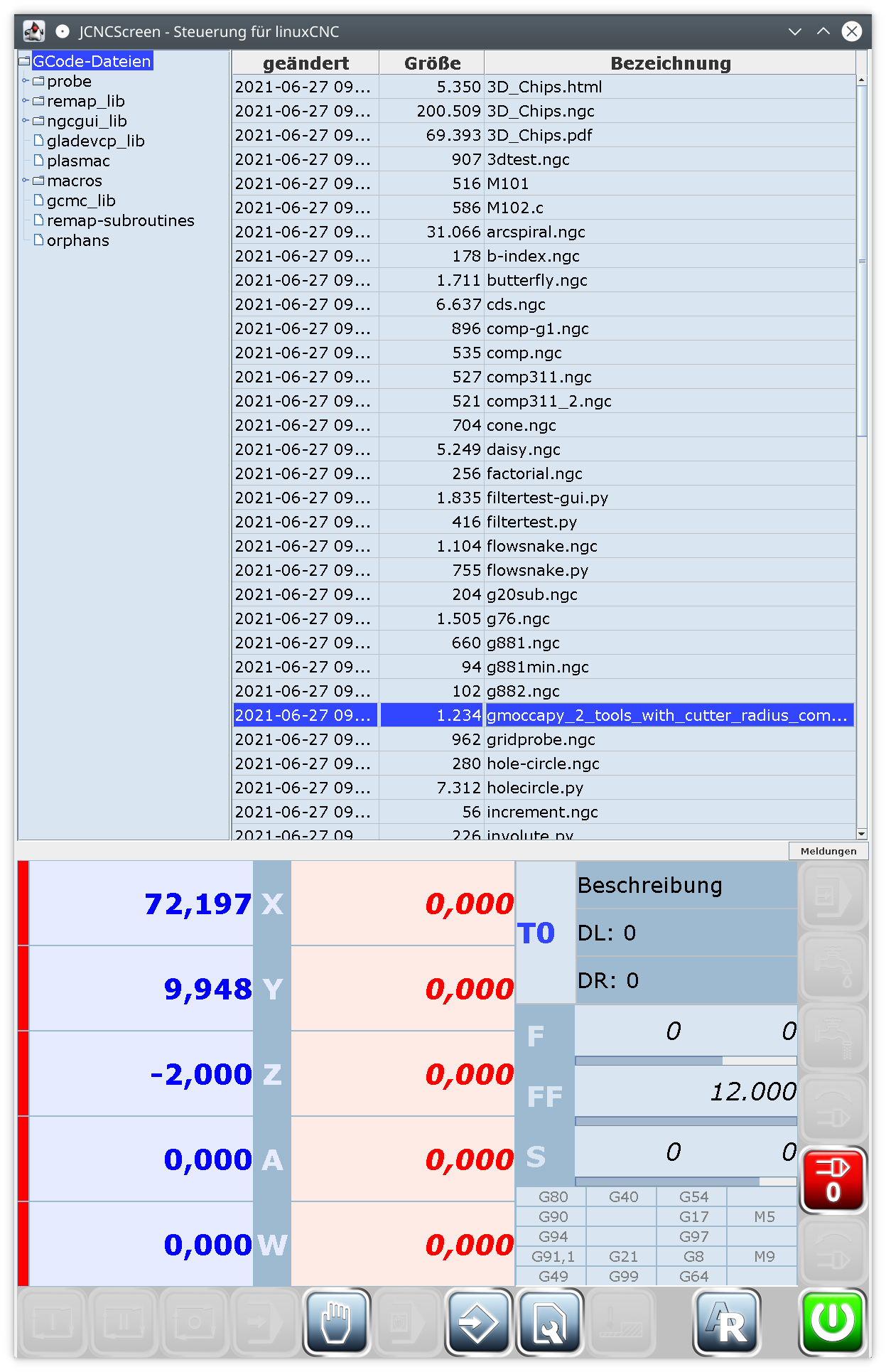

Another goal of my app: I wanted to reduce popping dialogs, so I created a filemanager as part of my app (similar look of Heidenhain ;) ):
and as I work on a cnc at job, where I have to programm gcode based on printed cad drawings, I wanted an integrated gcode-editor. It has only limited editing features, but already more than on my machine at work ;)
