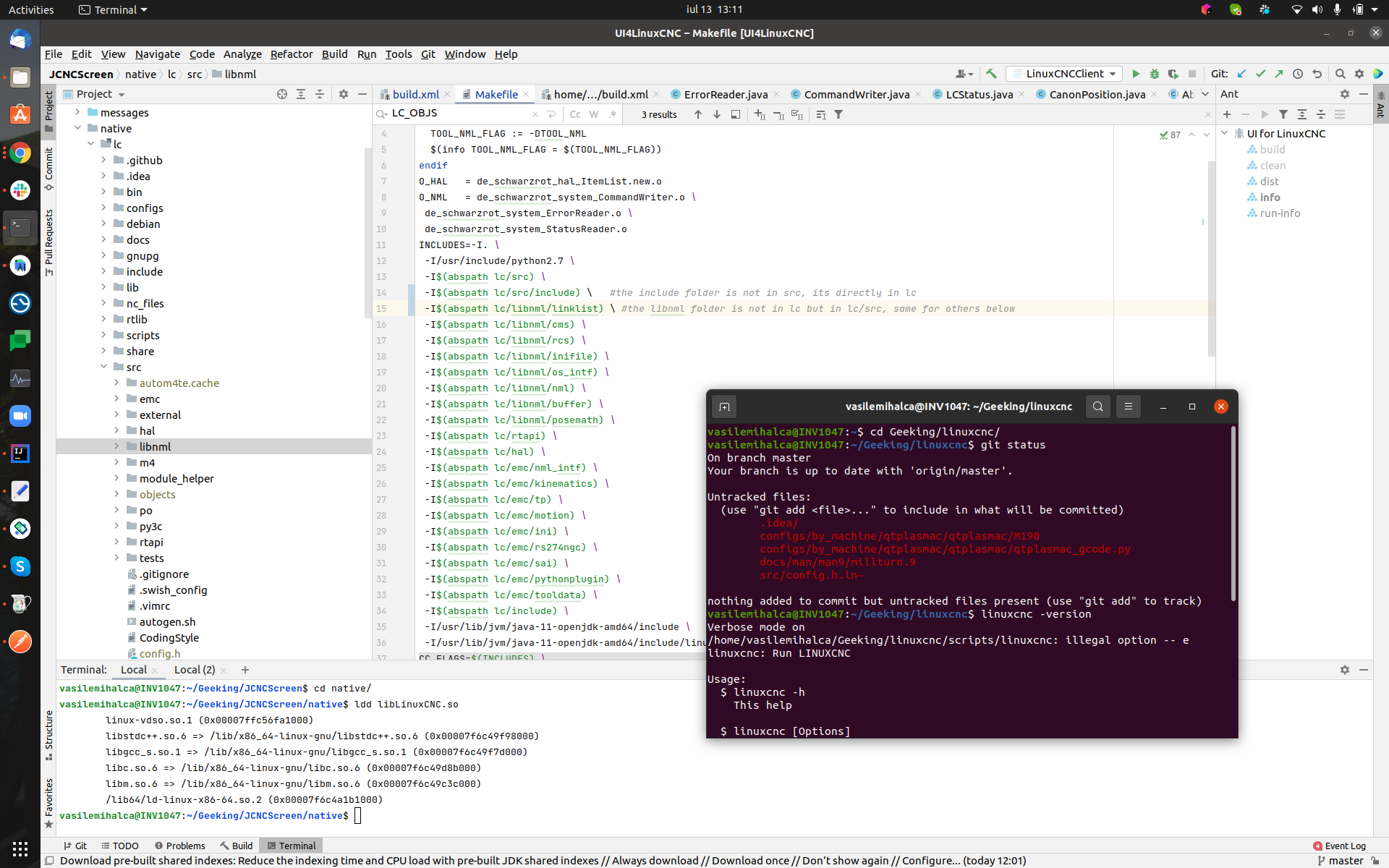

- vmihalca
- Posts: 346
- Thank you received: 22
13 Jul 2021 05:22 #214532
by vmihalca
Replied by vmihalca on topic Java UI for linuxcnc
I've made a git pull on branch master of linuxcnc, then ran "make" and "sudo make setuid"
I've made a git pull on your repos, ran ant dist on the export handler and on the jcnc screen
Then I tried to run the ldd command, and the results are not like yours.
From what I can see by inspecting the make file, is that the paths that I have under my lc folder, are not matching the ones specified in the makefile.
This leads me to conclusion that we're not using the same version of linuxcnc? How come we can have different folder structures if we're both on linuxcnc master?
See attached a screenshot with the relevant informations:
The tree structure in lc folder, a comment in the make file with the paths that are not correct for me, the embedded ide terminal with the result of ldd command, and the external terminal that shows on which branch I am with linuxcnc.
Please let me know your thoughts on the different lc folder structure.
- Reinhard
- Posts: 508
- Thank you received: 94
13 Jul 2021 08:36 - 13 Jul 2021 08:37 #214582
by Reinhard
Replied by Reinhard on topic Java UI for linuxcnc
if you place a softlink into native directory, called lc pointing to root of linuxcnc, then everything is fine, even if the absolute paths are different.
Last edit: 13 Jul 2021 08:37 by Reinhard.
- Reinhard
- Posts: 508
13 Jul 2021 08:52 #214585
by Reinhard
Currently I have problems with internet - so I wrote from mobile phone without looking at your picture.
Your right of cause! The include paths are wrong.
I have no idea, why it compiled without problems.
Anyway - change your Makefile and I push a changed variant as soon as I can connect to github.
Thank you for your feedback!

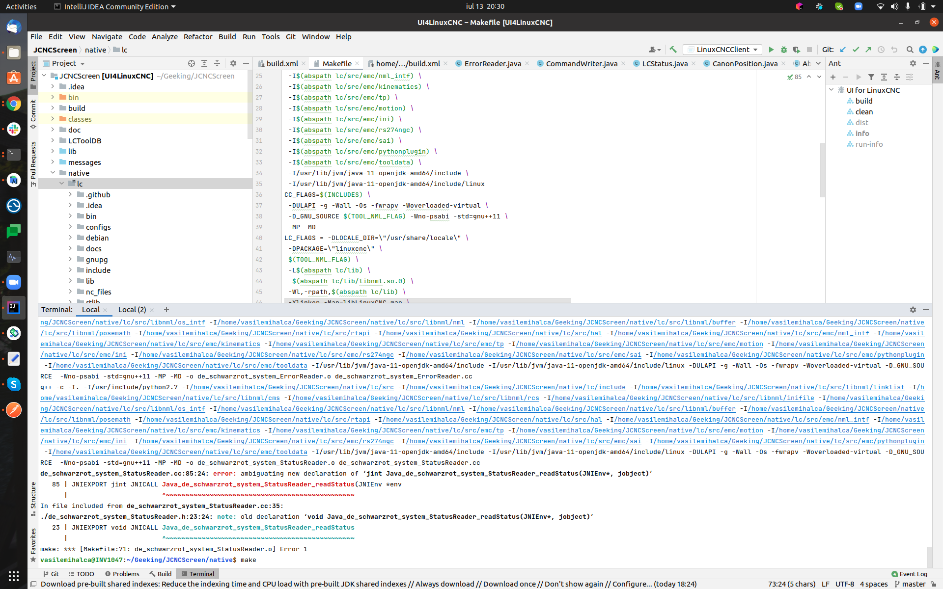

- vmihalca
- Posts: 346
13 Jul 2021 12:33 #214626
by vmihalca
Are you sure that your code really gets compiled? I think you may have a cache or smth.
If I move to native folder and I try to run a make command, I get the following error.
The signature from the header file does not match the signature in the c file.

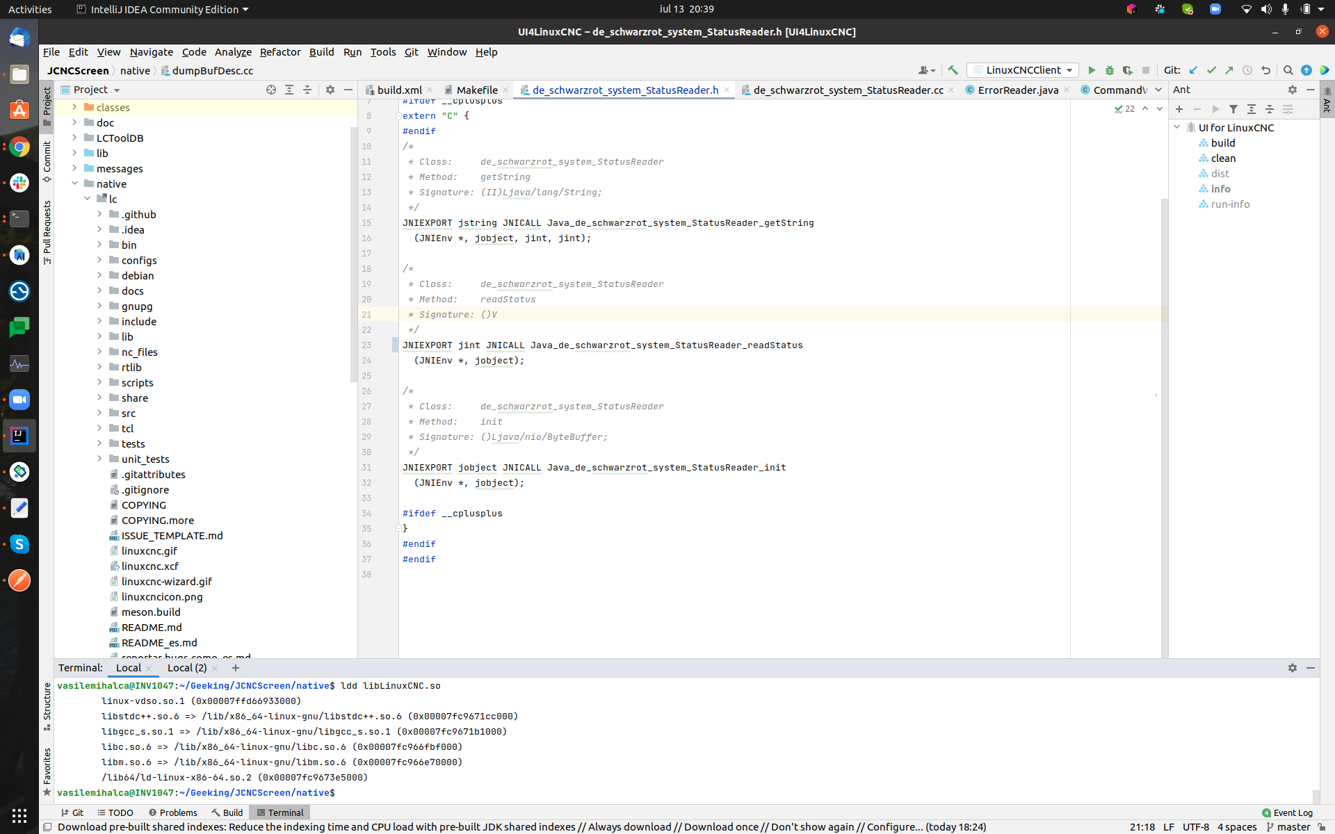

- vmihalca
- Posts: 346
13 Jul 2021 12:41 #214628
by vmihalca
Changed the signature in the header file, then ran an ant dist.
After that I checked the ldd command but still no linuxcnc libs....
The softlink is there..no idea what I'm missing :/
