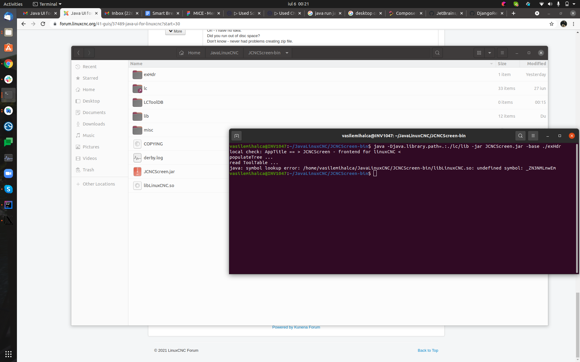

From what you are saying, I understand I should have an exHdr directory inside JCNCScreen folder. I don't have it. I assume that the build script of LCExportHandler module should also create that folder and then copy the LCExportHandler.jar into it.
I have made a git pull on that module and it says its up to date. Did you forgot to commit some changes on that repo?
Starting from the assumption that there should be an exHdr folder inside JCNCScreen, I have created that folder and copied the LCExportHandler into it, then ran again ant dist.
This time it worked and the JCNCScreen-bin.zip was created.
I took that zip, I extracted it, created the symlink to the linuxcnc library, then tried to run the jar with the following command:
java -Djava.library.path=.:./lc/lib -jar JCNCScreen.jar -base ./exHdr
The error I got is:
vasilemihalca@INV1047:~/JavaLinuxCNC/JCNCScreen-bin$ java -Djava.library.path=.:./lc/lib -jar JCNCScreen.jar -base ./exHdr
local check: AppTitle == > JCNCScreen - frontend for linuxCNC <
populateTree ...
read ToolTable ...
java: symbol lookup error: /home/vasilemihalca/JavaLinuxCNC/JCNCScreen-bin/libLinuxCNC.so: undefined symbol: _ZN3NMLnwEm
See the attached image for the folder structure.
I feel I am close...still missing out something..
Thanks for your support so far!
Yes, I had similar errors too. I have no idea, where they come from. The headers are resolved and the libraries got loaded at link stage - so "normally" those messages should not appear.
But ok - linuxcnc has heavily nested dependencies, so it might not be the original error, but the first succeeding error, that raises a message.
I removed anything unneeded from the native layer and with LC from git-master I can run the app without such dependeny errors.
But that may be by occasion, not by knowledge.
Currently I run out of ideas, but I keep on testing.

as I already wrote, I don't believe, that this error is the real error. Its just a consecutive error, that vomits a message.
When this kind of error happened first, it was about emcFormat. That time I cloned emcFormat to a renamed function in my code space.
Then it was constructor or EMC_STAT. After recompiling linuxcnc it was constructor of StateTag.
Then I stripped down the native code to the absolute minimum and it worked without error.
In your case its now the constructor of NML.
I suspect a problem could be the name mangling / mixing c++ and extern "C" - but I don't know, how to narrow the real problem.
I found some strange code in LC that wipes out instance space with memset - may be such code writes wrong space? Don't know. There are so many unthinkable things that could happen ...
