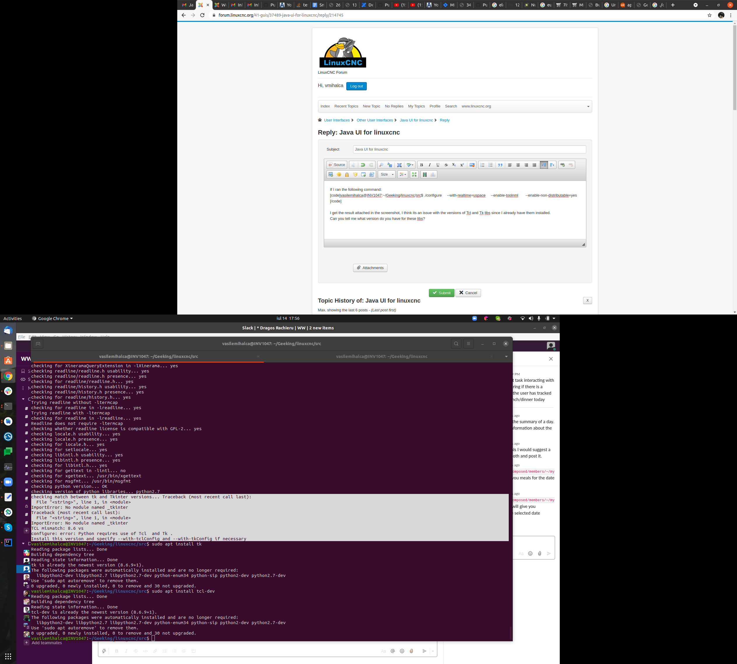

14 Jul 2021 02:03 #214680 by vmihalca
Replied by vmihalca on topic Java UI for linuxcnc
Tried to run make TestNML but it completes with error...can.t figure out the cause.
See attached log:

vasilemihalca@INV1047:~/Geeking/linuxcnc/src$ ./configure     --with-realtime=uspace     --enable-toolnml       --enable-non-distributable=yes
I get the result attached in the screenshot, I think its an issue with the versions of Tcl and Tk libs since I already have them installed.
I wonder - how did you compiled linuxcnc last time? Strange ;)
I don't know slack or its package system.
On debian system there's a package called "python-tk" (for python 2.xx) and "python3-tk" for (python 3.xx)
You shouls search your package system for the appropriate package for python 2.xx and install that.
