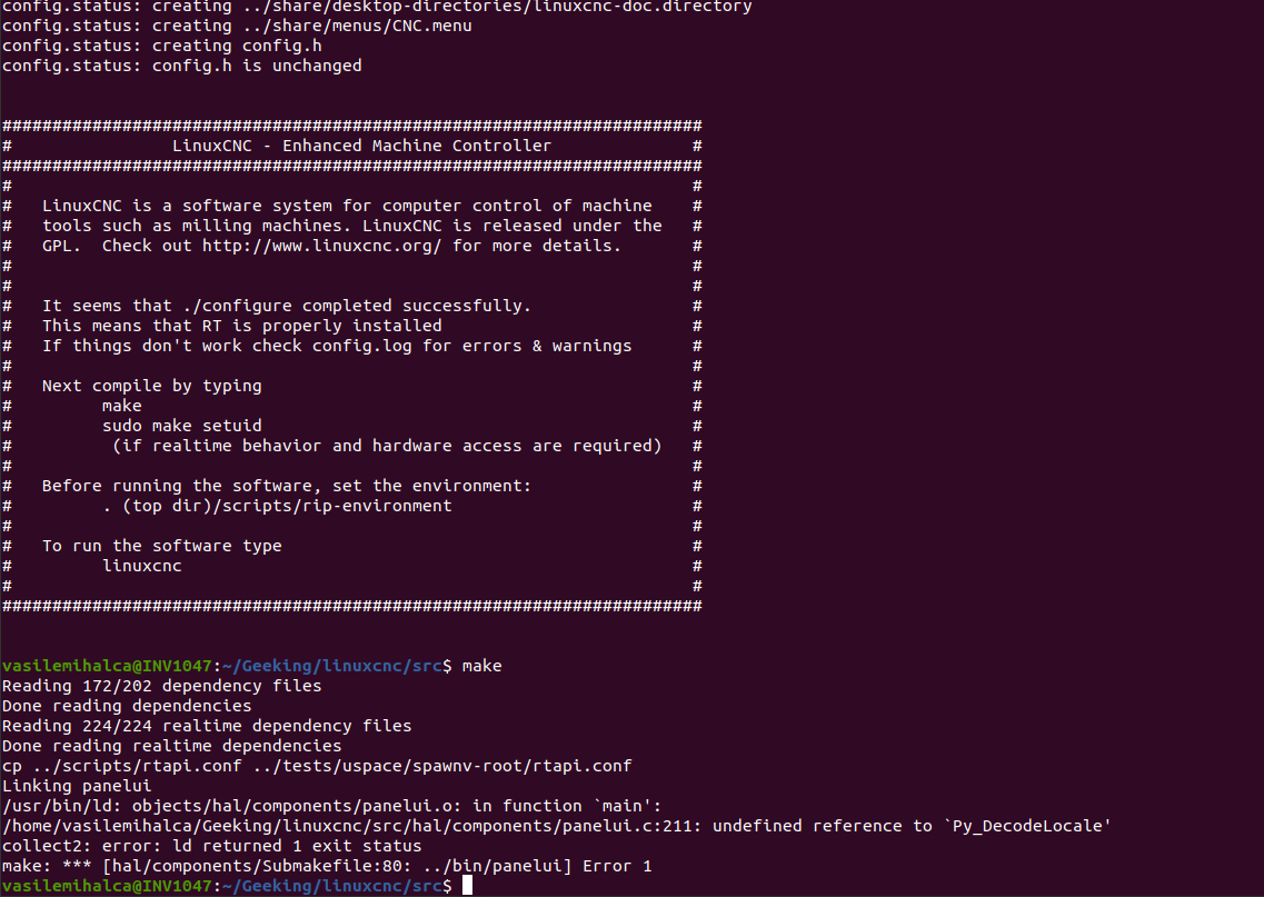

15 Jul 2021 21:11 #214934 by vmihalca
Replied by vmihalca on topic Java UI for linuxcnc
Finally I won the battle with version libraries and I have managed to successfully run
[b]./configure --with-realtime=uspace[/b]
Now when I try to run make, I get the following error...can't figure out yet how to fix it.
16 Jul 2021 02:26 #214981 by Reinhard
Replied by Reinhard on topic Java UI for linuxcnc
Just entering py_decodelocale in duckduckgo shows, that you are using python3 but compiled linuxcnc for python2.
So checkout your python installation.
On my system python --version says something like Python 2.7.xx, which is the same output like python2 --version - whereas python3 --version tells Python 3.7.xx.
looking at /usr/bin shows:
ls -l /usr/bin/python*
lrwxrwxrwx 1 root root       7 Mär  4  2019 /usr/bin/python -> python2
lrwxrwxrwx 1 root root       9 Mär  4  2019 /usr/bin/python2 -> python2.7
lrwxrwxrwx 1 root root       9 Mär 26  2019 /usr/bin/python3 -> python3.7
If on your system /usr/bin/python points to python3, you might want to write a wrapper for linuxcnc/scripts/rip-environment, where you add a directory to the system path variable, which contains a link to python2 called python.

16 Jul 2021 07:10 #214994 by phillc54
Replied by phillc54 on topic Java UI for linuxcnc
You can configure master branch for python3 with:
./configure --with-realtime=uspace --with-python=python3 --with-boost-python=boost_python3-py37
An alterntive is to use master-gtk3 branch which I think defaults to python3
16 Jul 2021 07:13 #214995 by vmihalca
That is what I had initially, but I thought that JCNCScreen only works with master & python2.7
