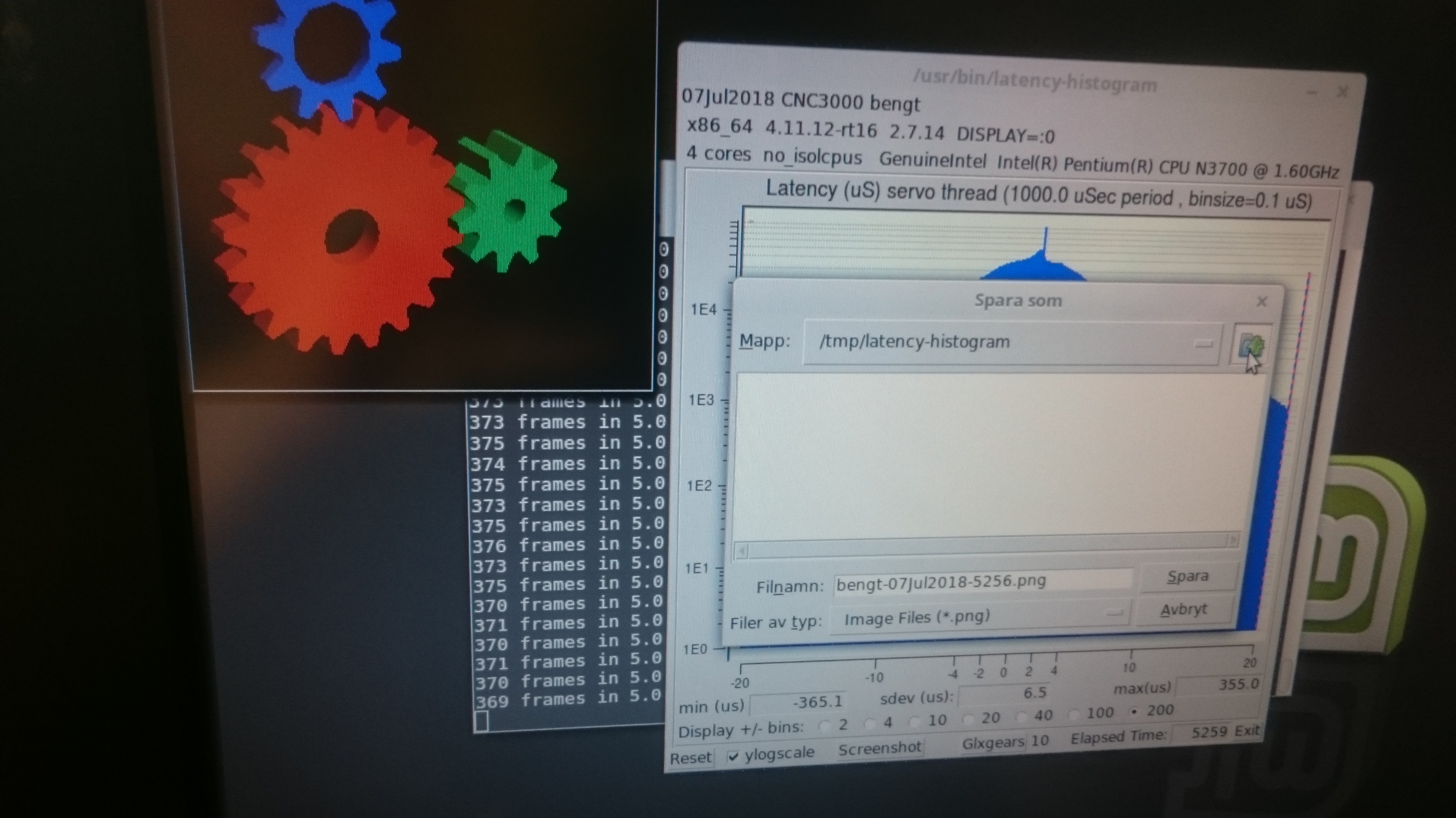

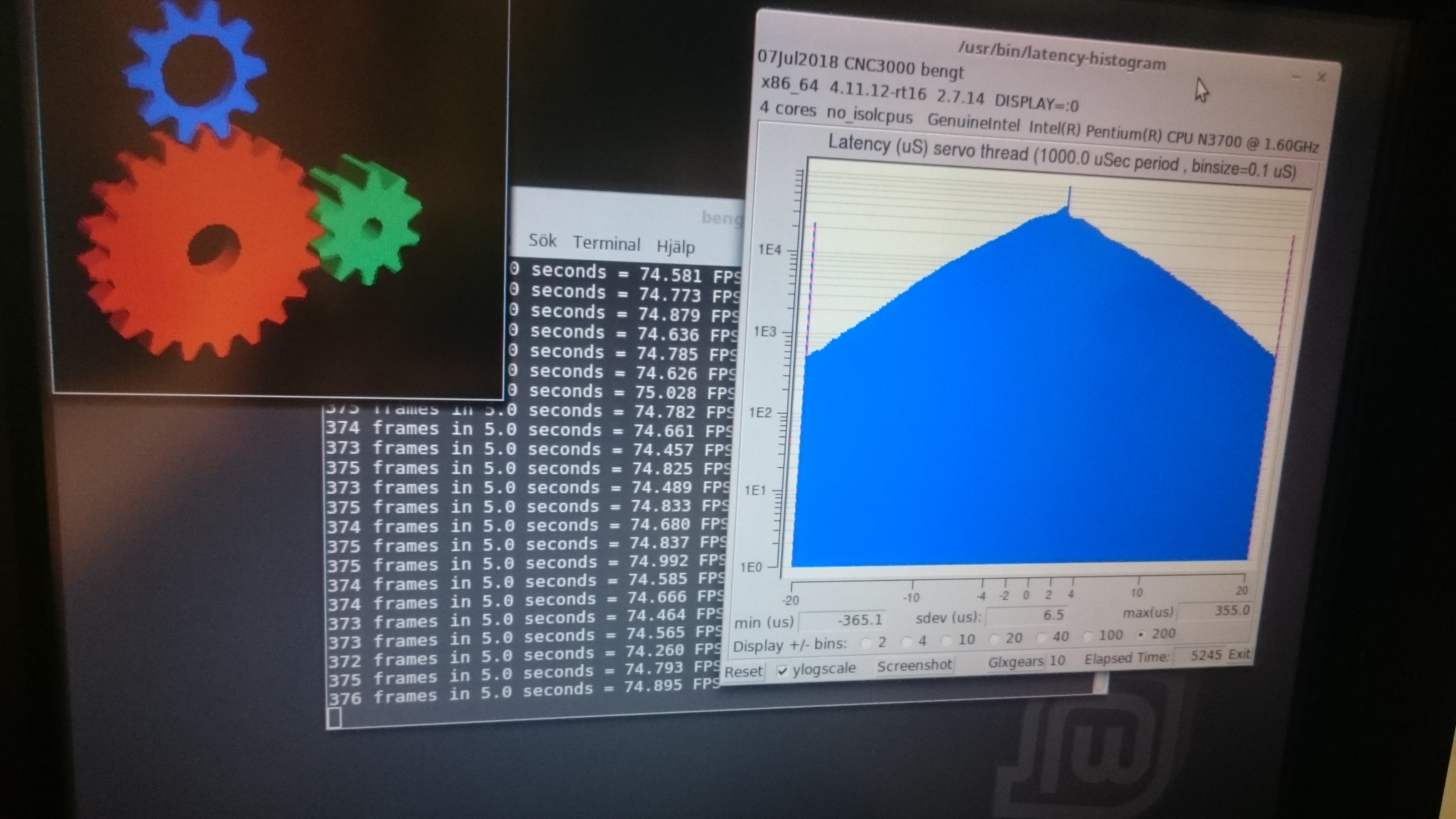

So here my finding as regards latency test.
Here it has been running about 1½hours with 10 GLX Gears and still OK.
I can move the window still OK, but...
When I want to save a screenshot the PC FREEZE´s
Restart and I am running LCNC without any problems, so I take it that latency test with 10x GLX gears is way way more than LCNC really needs to run at.

So now I got a freeze again but this was not easy to get!
Running Latency test and earlier I could not take a screenshot, now I could do several, but wanted to take a full screenshot, opened main menu to open screen dump and boom there it was again with a total freeze.
Looks like I can run LCNC without any problems but I will be limited to do one task only = LCNC and will have to do *housekeeping* before or after. OK by me.

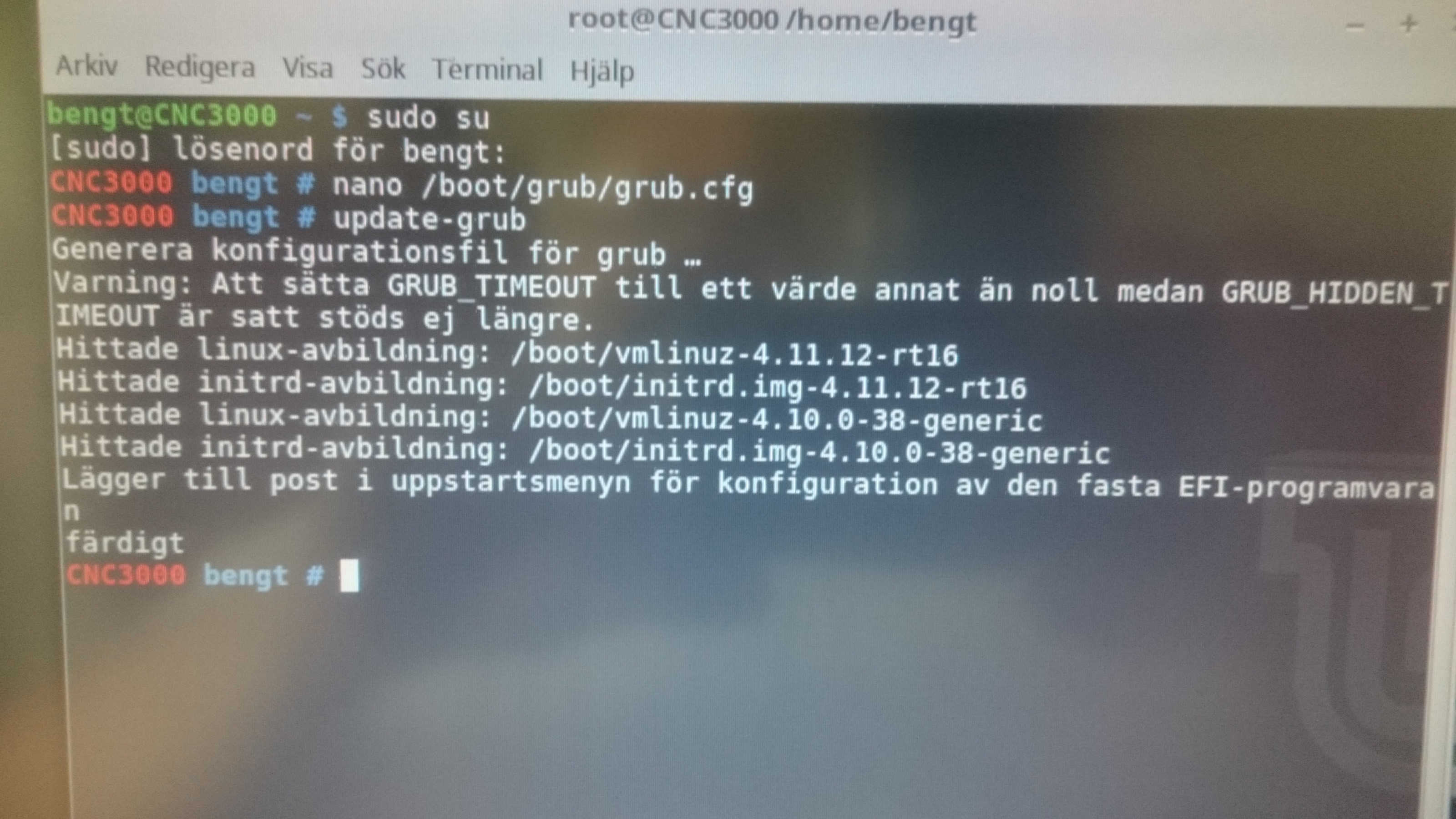

Back to FREEZE again so I decided to edit grub.cfg and add isolcpus= 2,3 but my edit will not take! ?? !
This is the code I want to have again as it did not survive the last update-grub as per PCW advice.
isolcpus=2,3 intel_idle.max_cstate=1 i915.enable_rc6=0 i915.enable_dc=0
This is what I do after edit and save of grub.cfg
So obviously I am doing something wrong here as my edit of grub will not update, but what am I doing wrong?
First I would like to add this intel_idle.max_cstate=1 i915.enable_rc6=0 i915.enable_dc=0 and let isolcpus be

}This is the code I want to have again as it did not survive the last update-grub as per PCW advice.
bengt@CNC3000 ~ $ sudo su
[sudo] lösenord för bengt:
CNC3000 bengt # update-grub
Generera konfigurationsfil för grub …
Varning: Att sätta GRUB_TIMEOUT till ett värde annat än noll medan GRUB_HIDDEN_TIMEOUT är satt stöds ej längre.
Hittade linux-avbildning: /boot/vmlinuz-4.11.12-rt16
Hittade initrd-avbildning: /boot/initrd.img-4.11.12-rt16
Hittade linux-avbildning: /boot/vmlinuz-4.10.0-38-generic
Hittade initrd-avbildning: /boot/initrd.img-4.10.0-38-generic
Lägger till post i uppstartsmenyn för konfiguration av den fasta EFI-programvaran
färdigt
CNC3000 bengt #So obviously I am doing something wrong here as my edit of grub will not update, but what am I doing wrong?

08 Jul 2018 09:00 #113808
Replied by PCW on topic Upgraded to 2.7.13 -- W T F --
You are editing the wrong file
you should edit /etc/default/grub
grub.cfg is overwritten every time you run update-grub
