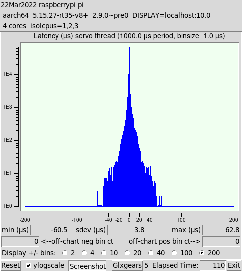

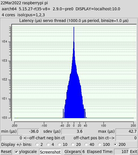

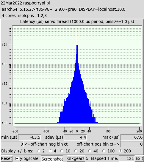

The first tests of operation gave good results.
In particular, these are the graphs obtained through the
latency-histogram --nobase --sbinsize 1000 --show
a)
b)
c)

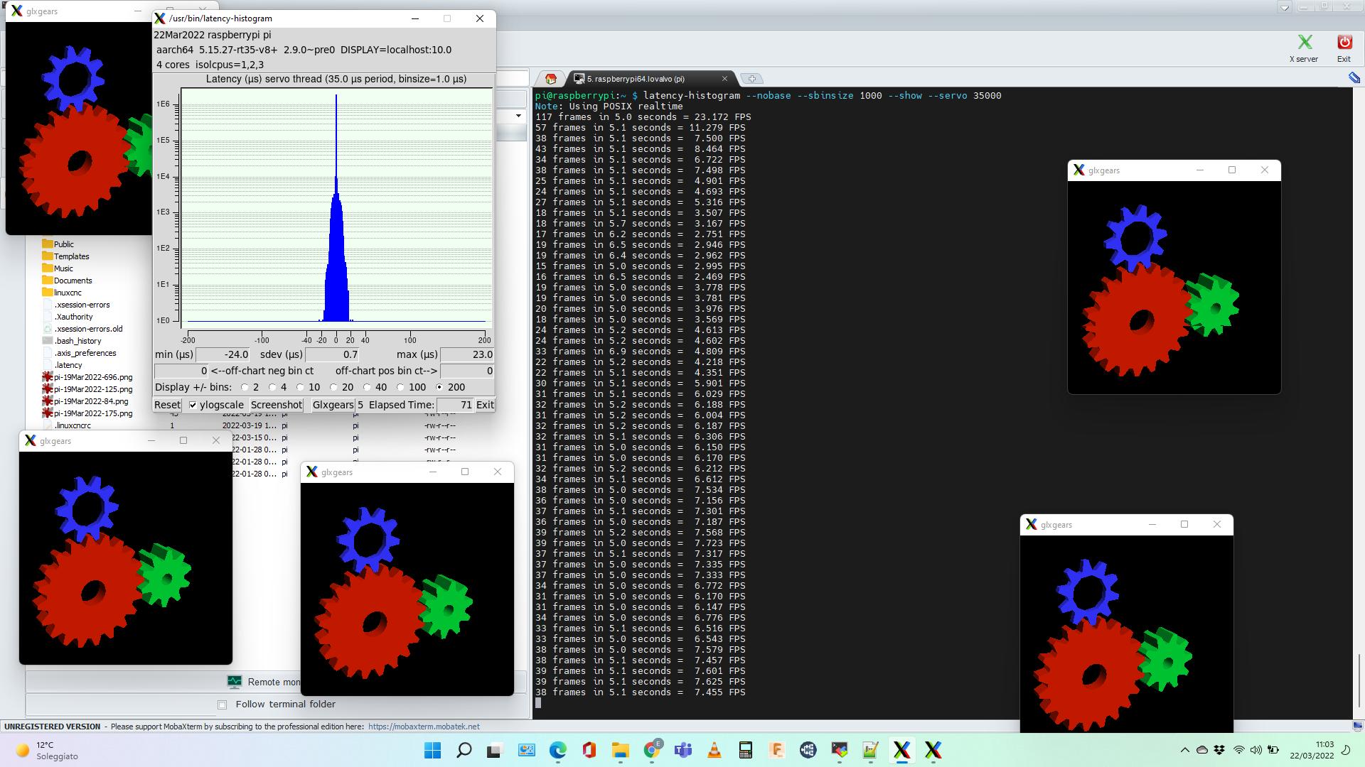

Also in the case of the Pi 400 it is possible to reduce the servo cycle up to 35us without generating the 'Unexpected realtime delay' error.
a)
b)
c)
