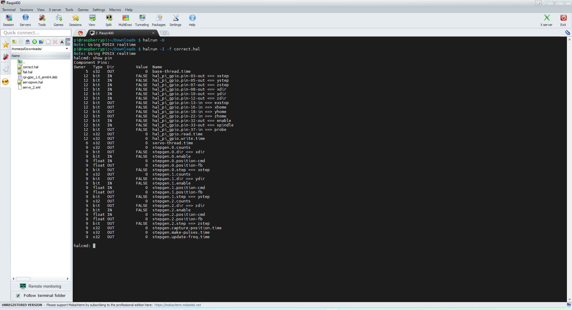

I never made it to a complete .ini file, but I tested many settings (the I86 system that died had an earlier LinuxCNC version. and it got 'converted'. I started from scratch and it took some time to understand the hal file requirements, which I documented first. It was my intention to post one complete working configuration, but after many hours I did not make it that far.
Elco
I Attached is the linuxcnc.report I ran just now on the RPI as well as my .hal and .ini file.
Elco

Meanwhile, there are a number of problems in the .hal file.
In fact, in the instructions hal_pi_gpio.pin-xx-out and hal_pi_gpio.pin-xx-in the parameter xx refers to the physical pin number of the Raspberry and not to the gpio number.
Furthermore, there is no variant -not used for the estop signal In some lines the command hal_pi_gpio.pin-xx-out (xhome and following) is misspelled.
Attached is the correct version of the commands for the .hal file.

elovalvo,
Thanks a lot for clarifying and fixing the gpio assignments.
Regards,
Elco

I am trying to debug at the command line why LinuxCNC does not want to start. I found that when in [EMCMOT] the COMM_TIMEOUT is set to 10 (5 is too short) the following errors disappear:
USRMOT:ERROR: command timeout
emcMotionInit:emcTrayInit failed.
RTAPI then tries to load milltask. However, it fails to find milltask.so in linuxcnc/modules, upon which waitpid times out.
This is with the Linux Raspberry 5.10.74 rt54-V8+ #1 SMP PREEMPT_RT Fri Oct 22 10:15:42 PDT 2021 aarch64 GNU Linux version
LinuxCNC 2.8.2 . The hardware is a RPi 4B 8 GB
All from this file:
Linuxcnc_2.8.2_arm64deb.zip
Elco
All from this file:
Elco

Is the file actually there?RTAPI then tries to load milltask. However, it fails to find milltask.so in linuxcnc/modules, upon which waitpid times out.

no, milltask.so is nowhere in the system; only found /usr/bin/milltask.
I used the complete SD image for installation. I'll reinstall the Linuxcnc deb and see what happens.
Elco
Edit: Reinstalling the OS and LinuxCNC cleared up the problems, LinuxCNC starts, the axis demo not yet. One error message: unexpected realtime delay on task 0 with period 100000. Setting the value to 200000 cleared that up.
Elco

Are you running a base thread? What hardware interface are you using?

Usually build my own interface hardware (retired EE Engineer here). Make them more robust to support experiments. (essentially74HC14's, 6N137's, single UL2003 to drive 3 controllers, DM856 drivers. LM1489's for filtered sensor input)
Currently building new CNC hardware, that takes most of the time. The RPi works, ie produces signals at its pins, and can move steppers. I am more a LinuxCNC user (since many years) than a software engineer, and do not want to spend more time on it for now. For my small CNC that would fit the RPi, I'll be testing a Biostar mini-ITX this weekend.
The RPi is cute, with not so great latency. An RPi compute module with a Remora like I/O board might be a good solution though.
Elco
Elco
06 Apr 2022 15:21 #239447
Replied by andypugh on topic RPI4 Raspbian 64 bit & LinuxCNC
My question was related to whether you were using software step generation or were interfacing the Pi to an external step generator. Whilst there is a driver for the Pi GPIO pins, I don't think that they Pi latency is good enough to run steppers that way (except at lo speed, or to experiment)
The Pi4 can work well with ethernet-interfaced hardware, and I think anything 3 or better can work with the SPI interfaced boards such as the 7C80.
In those cases you would only run the 1ms servo thread, and the latency then is not a signficant issue.
