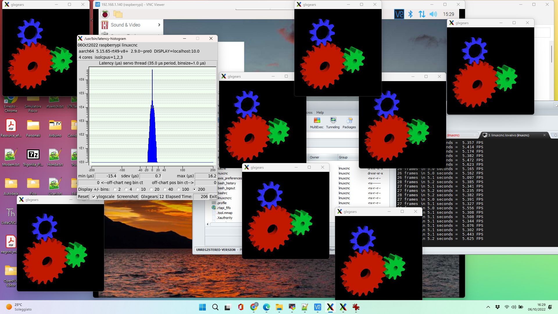

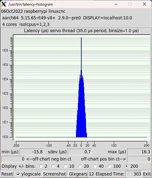

06 Oct 2022 16:08 - 06 Oct 2022 16:26 #253623
by elovalvo
Replied by elovalvo on topic RPI4 Raspbian 64 bit & LinuxCNC
As a new version of both RaspiOS is available
(www.raspberrypi.com/software/operating-systems/)
Release date: September 22nd 2022
System: 64-bit
Kernel version: 5.15
Debian version: 11 (bullseye)
that of the PREEMPT_RT patch
github.com/kdoren/linux/releases
Raspberry Pi realtime Kernel (5.15.65-rt49)
similarly to what has been done in the past
forum.linuxcnc.org/9-installing-linuxcnc...cnc?start=130#238020
I have prepared the microSD image of this installation
Linux raspberrypi 5.15.65-rt49-v8+ #1 SMP PREEMPT_RT Tue Sep 6 18:12:35 BST 2022 aarch64 GNU/Linux
available at this link
linucnc-2.9.0pre-bullseye_arm64rt.zip
user: linuxcnc
pwd: cnc
Again, the first tests of operation gave good results.
In particular, these are the graphs obtained on Raspberry Pi 400 Rev 1.1 4GB
through the command
latency-histogram --nobase --sbinsize 1000 --show --servo 35000
System: 64-bit
user: linuxcnc
pwd: cnc
through the command
