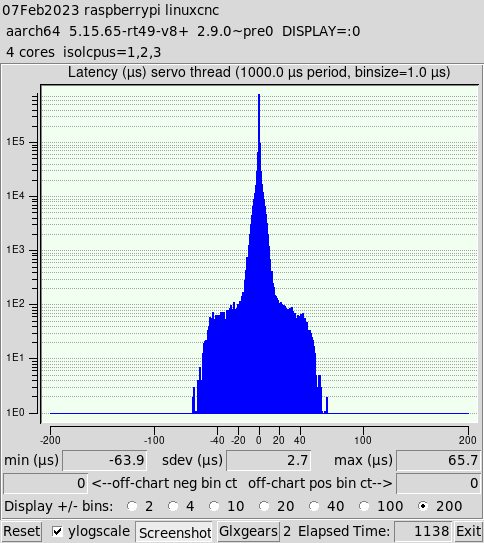

i've recently set up a raspberry pi 4b with a Mesa 7i96S with stepper motors and am seeing multiple problems
after installing linucnc-2.9.0pre-bullseye_arm64rt.zip as posted by elovalvo in:
forum.linuxcnc.org/9-installing-linuxcnc...cnc?start=150#253623
i am seeing multiple errors when running through my gcode:
it's not unusual to get "Unexpected realtime delay on task 0 with period 1000000"
the most common one happening during a run is "joint * following error" (happens on any of the 3 joints)
and most catastrophic: "hm2/hm2_7i96s.0: error finishing read"
as described in Mesa hm2/hm2_7i96s.0: error finishing read
any suggestions would be greatly appreciated!
various diagnostics below, latency plot and hal file attached

--- 10.10.10.10 ping statistics ---
1000 packets transmitted, 1000 received, 0% packet loss, time 1022926ms
rtt min/avg/max/mdev = 0.143/0.165/0.591/0.035 ms
linuxcnc@raspberrypi:~ $ ethtool eth0
Settings for eth0:
Supported ports: [ TP MII ]
Supported link modes: 10baseT/Half 10baseT/Full
100baseT/Half 100baseT/Full
1000baseT/Half 1000baseT/Full
Supported pause frame use: Symmetric Receive-only
Supports auto-negotiation: Yes
Supported FEC modes: Not reported
Advertised link modes: 10baseT/Half 10baseT/Full
Advertised pause frame use: Symmetric Receive-only
Advertised auto-negotiation: Yes
Advertised FEC modes: Not reported
Link partner advertised link modes: 10baseT/Half 10baseT/Full
Link partner advertised pause frame use: Symmetric
Link partner advertised auto-negotiation: Yes
Link partner advertised FEC modes: Not reported
Speed: 100Mb/s
Duplex: Full
Auto-negotiation: on
master-slave cfg: preferred slave
master-slave status: slave
Port: Twisted Pair
PHYAD: 1
Transceiver: external
MDI-X: Unknown
netlink error: Operation not permitted
Current message level: 0x00000007 (7)
drv probe link
Link detected: yes

07 Feb 2023 18:33 #263964
Replied by PCW on topic RPI4 Raspbian 64 bit & LinuxCNC
As a first step, can you try with rx-usecs set to 0?
- Posts: 12156
- Thank you received: 4149
08 Feb 2023 09:01 #264014
Replied by rodw on topic RPI4 Raspbian 64 bit & LinuxCNC
try isolcpus=2,3 as well

08 Feb 2023 20:38 - 08 Feb 2023 21:30 #264073
by beaker152
it returns: 1-3
should it be changed to 2-3?
newbie question: where/how does one change that setting?
Replied by beaker152 on topic RPI4 Raspbian 64 bit & LinuxCNC
when i run cat /sys/devices/system/cpu/isolatedtry isolcpus=2,3 as well
it returns: 1-3
