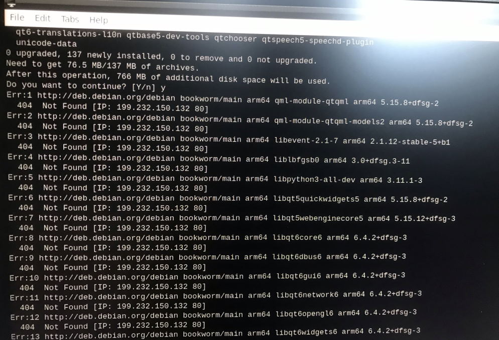

I am a new LinuxCNC user. Over the past weeks/months I read a lot about LinuxCNC, and tried it out on my Windows PC via a virtual machine (with no hardware attached). I really like the software and decided that I am going to use it in my CNC machine. As I don’t have a Linux computer I bought a  Raspberry Pi 4 GB.
It took me a while to get LinuxCNC running on the RPi. The dedicated ISO from the LinuxCNC downloads section didn’t work, but after some frustrations I eventually got it solved by using linuxcnc_book.img. The explanation from Elovalvo was helpful for me. Thank you very much for that!
Unfortunately I soon ran into the next issue, as I have difficulties installing QtPyVCP.
I tried to install the software dependencies with the command listed at the bottom of this page:
www.qtpyvcp.com/install/prerequisites.html
This gave me a list of error messages as attached on the screenshot.
However I continued with installing QtPyVCP, which did not generate any strange messages, but in the end it did not work so I guess it has something to do with the software dependencies.

03 Apr 2023 06:45 #268148 by elovalvo
Replied by elovalvo on topic RPI4 Raspbian 64 bit & LinuxCNC
From what I see I think it's a problem due to updating.
I recommend, before installing the software dependencies, to run these commands:
sudo apt update
sudo apt upgrade
03 Apr 2023 22:05 #268204 by Stef
Replied by Stef on topic RPI4 Raspbian 64 bit & LinuxCNC
Thank you for your input, this did indeed solve the issue.

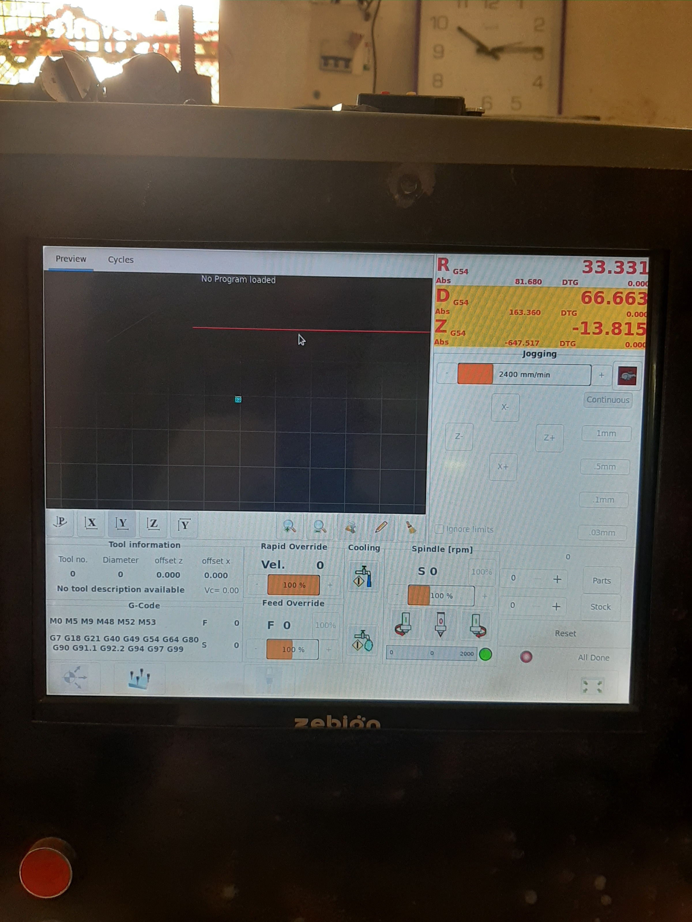

10 Jun 2023 04:39 - 10 Jun 2023 08:55 #273254 by virencq
Replied by virencq on topic RPI4 Raspbian 64 bit & LinuxCNC
I have used your 2.9 version. Running successfully in lathe.
For further enhancement I have used your latest book.zip.
Running smoother than previous one.
But in gmocappy side and lower menu not showing.
Last edit: 10 Jun 2023 08:55 by virencq. Reason: Forgot to add pictures
10 Jun 2023 12:02 #273267 by rodw
Replied by rodw on topic RPI4 Raspbian 64 bit & LinuxCNC
Thats more likely tto be a monitor size issue. Take it up in the Gmocappy section.
