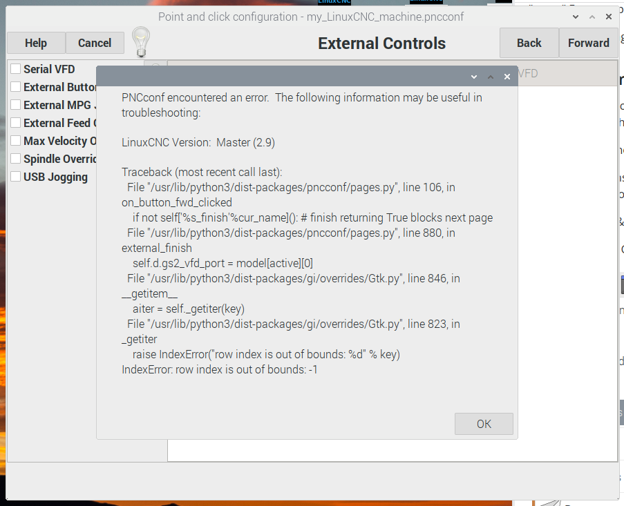

I have installed via the images provided here. I am using a Rpi4-4gb and testing on a 7i92t with the intent of eventually using SPI to a 7i90HD. My intent is to first get everything up and running via ethernet, then start the process of sorting the SPI interface.
I have an error using PNCconf when it gets to the Mesa Card 0 configuration page. I believe there is a missing dependency.

I have burned the "linuxcnc_book" image to an SD, put it into my Rpi4x4gb and tried to open PNCconf. I get the same error as I attached to post #264248.

I've never had a MESA card but I think you can try this:
From terminal run these commands:
Once this is done run the Mesa Configuration Tool with the command
Select the card and download the firmware. Then select the various options.
gnipsel.com/linuxcnc/mesact/index.html
Run pncconf without the "show advanced option pages" option
Maybe something settles down...
sudo apt install mesaflash
wget https://github.com/jethornton/mesact/releases/download/1.2.3/mesact_1.2.3_arm64.deb
sudo gdebi mesact_1.2.3_arm64.debOnce this is done run the Mesa Configuration Tool with the command
mesact

Thank you for the reply, I did something similar but just started with a 32bit RaspiOS and compiled from there.
After some shut-eye today I will attempt a 64bit version.
I will re-build PNCconf on the LinuxCNC_book version too so I can give feedback if it fixes the issue.
