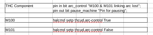

I was thinking about the structure.
If you have a component written. It has the in and output signals we need.
It can interact directly with M codes, user interfaces, etc real time.
So better is to work around the to make M code list, this list is a user friendly list and also reduces the comp file code, a Macro does not have to be compiled, and simplyfies the structure in drastic way. Also users can make a quick modification to a existing Macro and don't have to worry about learning the whole process how to be a top c programmer.
This is how you can do a Macro :
#!/bin/bash
A=$(halcmd getp thcud.enable)
if [ "$A" = TRUE ]; then
halcmd setp thcud.arc-control True
halcmd setp grotius_gui.arc_lost_led True
else
   echo " THC ENABLE is not active "
fi
exit 0
It first looks if the THC is enabled.
It triggers if the arc okey signal is not lost during the cutting process. This real time interrupt model is only done by the component.
So the component handles only the real time interrupts. Logic parts can be programmed in the Macro's themself.

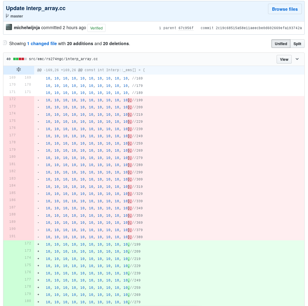

Yesterday i had an issue about the limited M code list. We can go up to M999. We just have to change some things.
These codes are currently undefined in the current implementation of LinuxCNC
and may be used to define new M-codes:
M10
M11 M12 M13 M14 M15 M16 M17 M18 M19 M20
M21 M22 M23 M24 M25 M26 M27 M28 M29 M31 M32 M33 M34 M35 M36 M37 M38 M39 M40
M41 M42 M43 M44 M45 M46 M47 M54 M55 M56 M57 M58 M59 M74 M75 M76 M77 M78 M79 M80
M81 M82 M83 M84 M85 M86 M87 M88 M89 M90
M91 M92 M93 M94 M95 M96 M97 M98 M99
All codes between `M199` and `M999`.
So we can go up to M999. That is nice !! But i think we can go up to M10000 if we want, lets try it.
It is easer to understand M3 is related to M300 and so on.
For today my investegation ended here at line 148 : github.com/LinuxCNC/linuxcnc/blob/master...4ngc/interp_array.cc
At this moment i want a good time with my wife.
For tommorrow i have a new github linuxcnc version to try the exended Macro M999 and also try M10000.
You can see if it is working if it has a star. B)
github.com/michelwijnja/External_offsets...tive_feed_macro_plus

19 Jul 2018 16:52 #114536 by Grotius
Replied by Grotius on topic Useful Plasma Thread
Update :
Expanding the M codes was succesfull in one file after compiling. I expanded the M-code array.
But it still is complaning after compiling and testing in terminal about : Uber 200 is not allowed.
So there is another file that is related to this maximum number.
github file
But now i have to find the other related files. The terminal give's to less information to solve this quickly. Is there a log file
that can trigger every single program step?
So i must look file by file tomorrow. :woohoo:

19 Jul 2018 17:44 #114539 by rodw
Replied by rodw on topic Useful Plasma Thread
Rather than trying to use M300, why not pick a range say M300-M399?
Then you could use M303 to pair with M3 in a logical manner. I don't think its a good idea to hack into the Linuxcnc core model.
