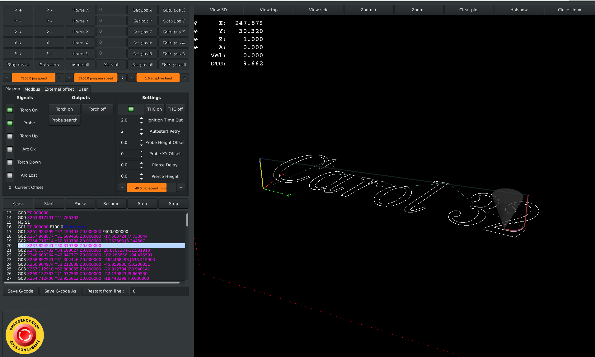

I have worked for 2 day's now on a new plasma hal component compatible with the external offset branche.
It's working on inkscape. Inkscape has only to put out a M3 and M5.
This plasma component is working just like the orginal Toma thc hal code. The difference is, this component is not build in Hal, but
in C program language. My C was not so good when i started building this component, but i am getting better each day, Rod is advising me by e-mail.
So the component does at this moment :
Travelheight
Pierceheight
Piercespeed
Piercedelay
Arc_ok
Coming day's i expand this component with more signals, like torch up and down, restart function, etc.
For the fun i will make a hal schematic from my hal system at this moment. You will see the difference with the Toma hal file.

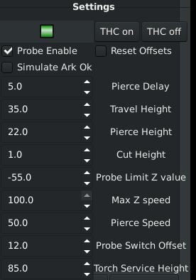

This post is about a new c component i am writing to do a THC function for inkscape with only M3 and M5 as input. Just like Professor Toma did a few years ago in the hal.
The normal thc function without probe function works well. I added a button to my user screen to enable the probe function.
Now i am writing at the probe function. The function is now working. It saves the probe height, and make switch offset and it go's
to pierce height. Tomorrow i will do the rest.

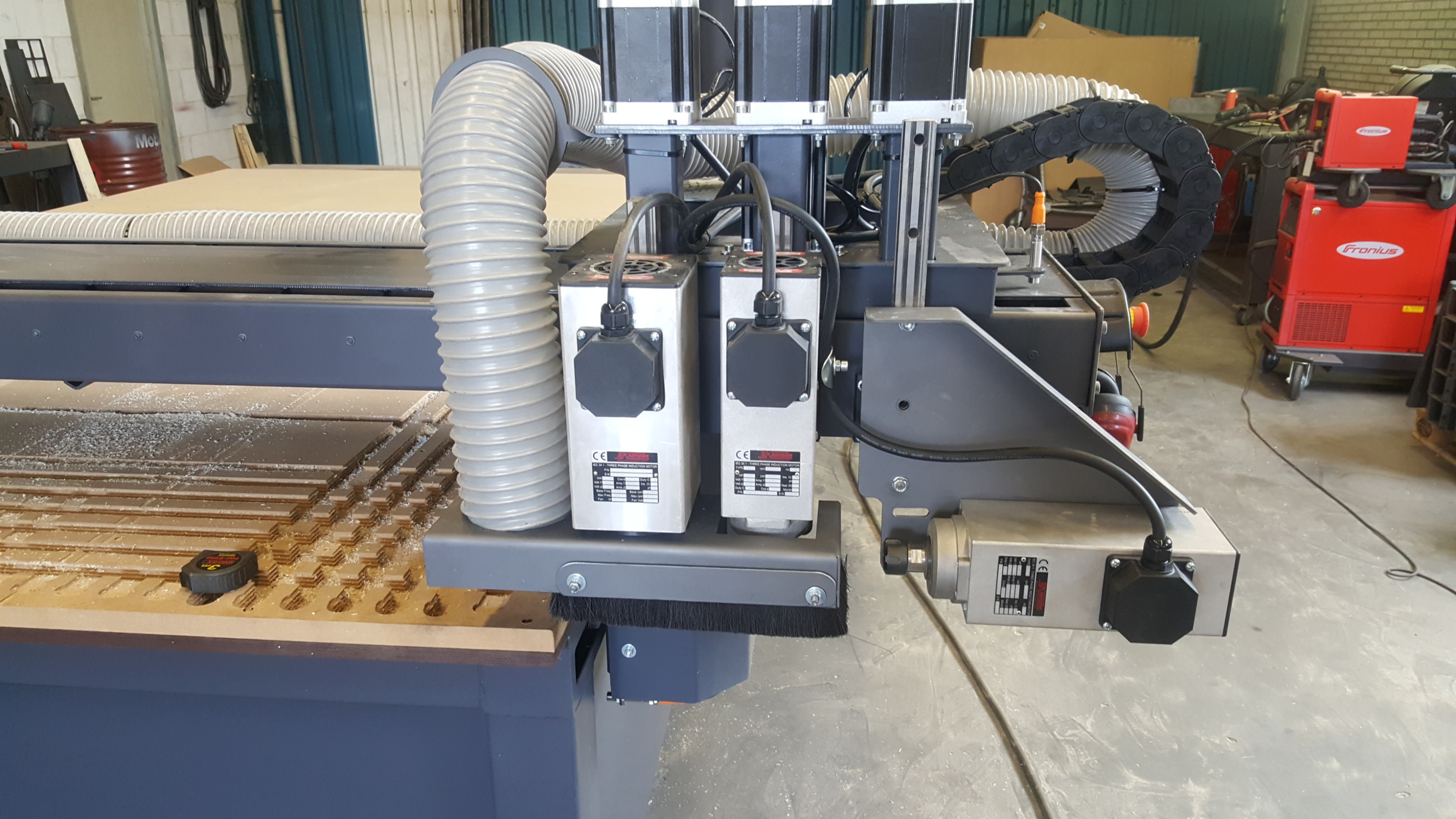

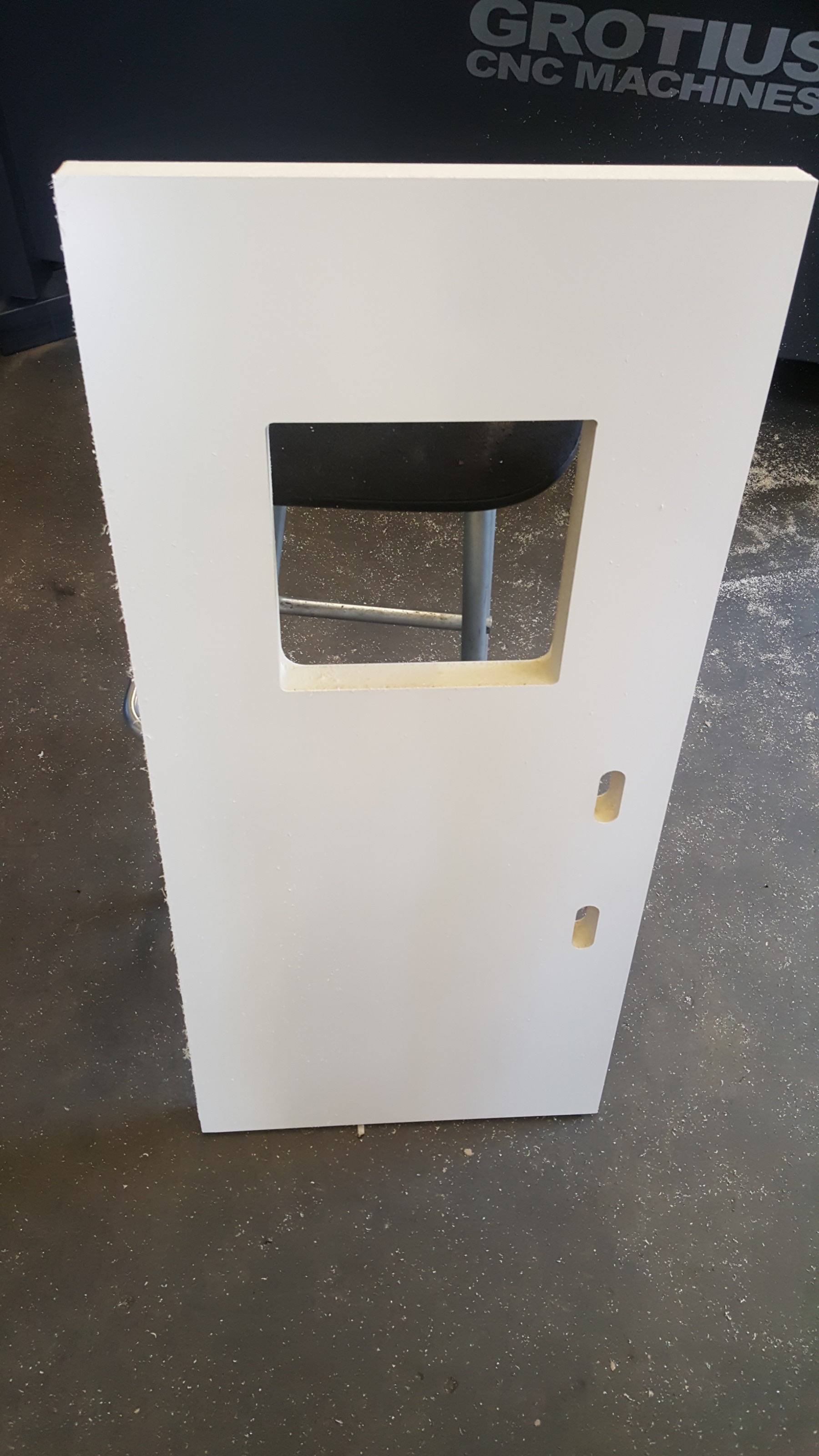

Today is was working at this milling monster :
I made a test for customer :
In steel top plates, no problemo, speed 4000mm/min. :

Hi Rod,
Today i have tested the component on a real plasma machine. It work's realy amazing !
It's real time responding to the user interface ( screen ) input signals, so if you change settings like pierceheight, or travelheight,
you see the machine is direct responding on the input signals. It's always nice to see a machine executing your orders real time. B)
One little issue i had and solved, when i use a glade spinbox and add a value of 2.5mm cut height, the component code was not responding. Machine stayed in pause. When i use full value's for this item, it worked directy. So it is a float signal, but maybe i missed something here. The problem is in fact outside of the component.
I now go further with the probe function, restart function, etc.
For my user interface, i want to make a xml file load in coupled to the component input value's, at this way we can load tool list's.
