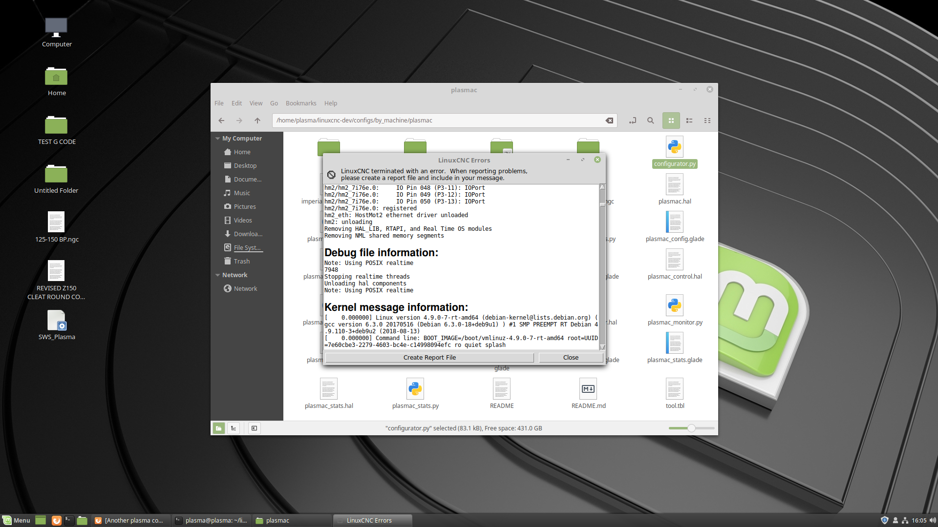

Just did a git pull and get this error on start up,
Last edit: 21 Aug 2019 05:58 by thefabricator03.
  • phillc54
  • phillc54's Avatar Topic Author
  • Offline
  • Platinum Member
  • Platinum Member
21 Aug 2019 06:01 #142681 by phillc54
Could you post your HAL file.

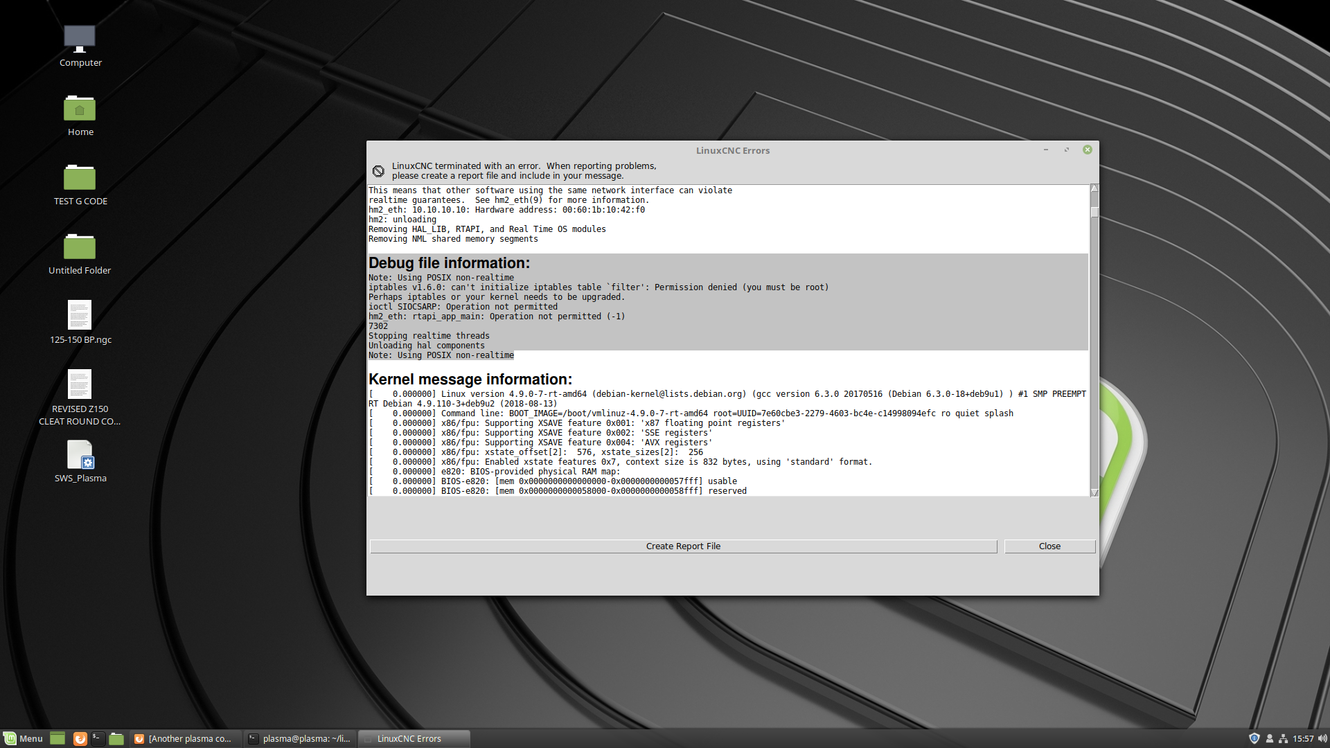

21 Aug 2019 06:07 #142682 by thefabricator03
Replied by thefabricator03 on topic Another plasma component...
I realised I did not run sudo make setuid so ran that and got this error,
Attachment not found
Hal attached.
