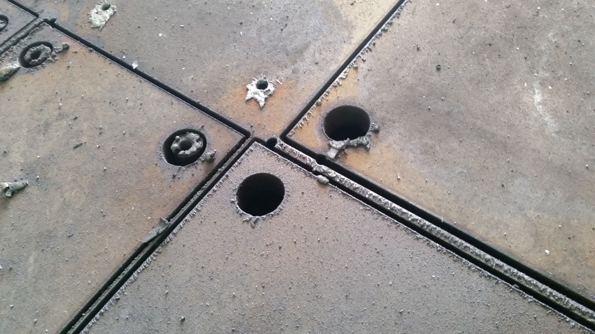

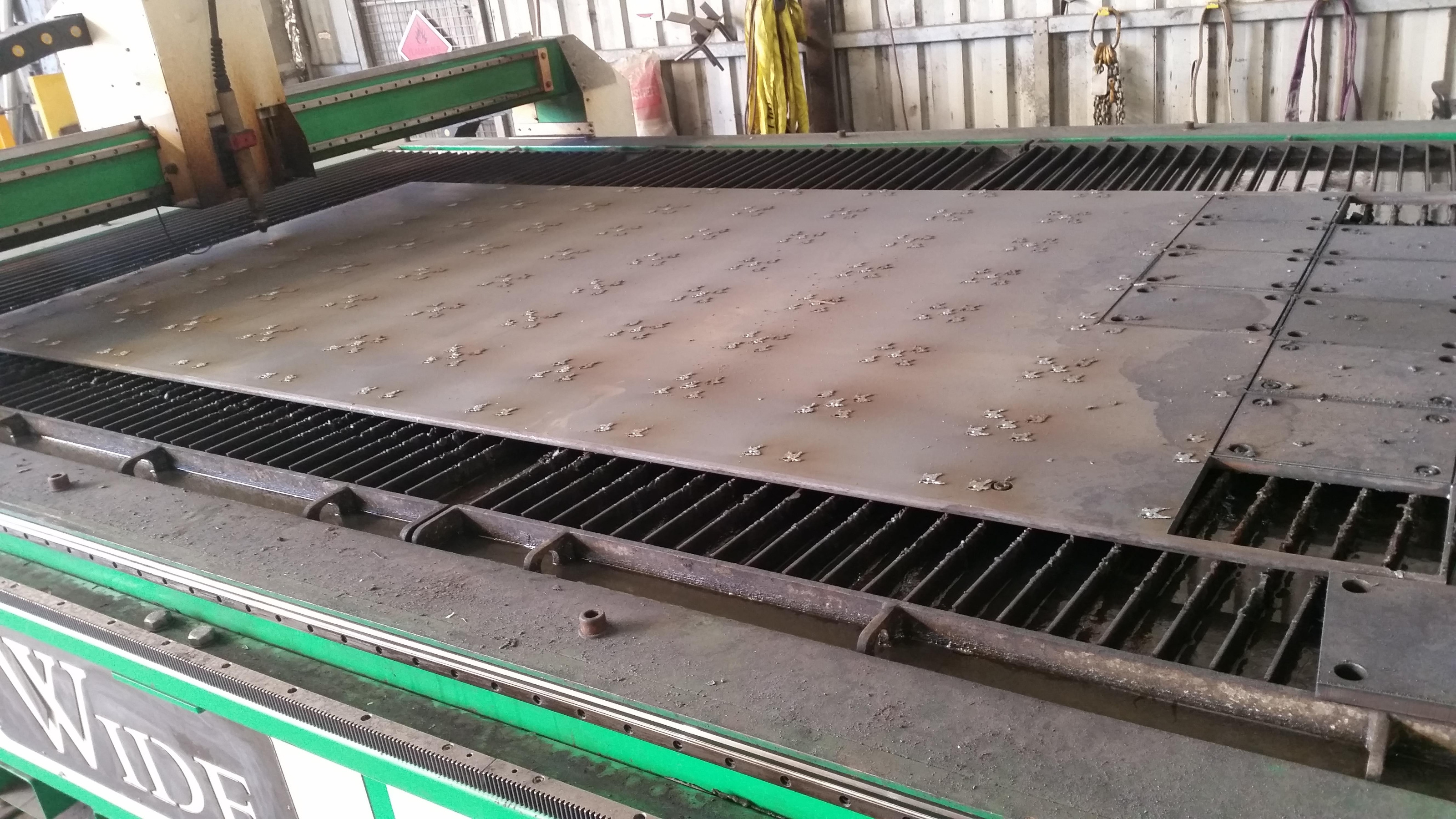

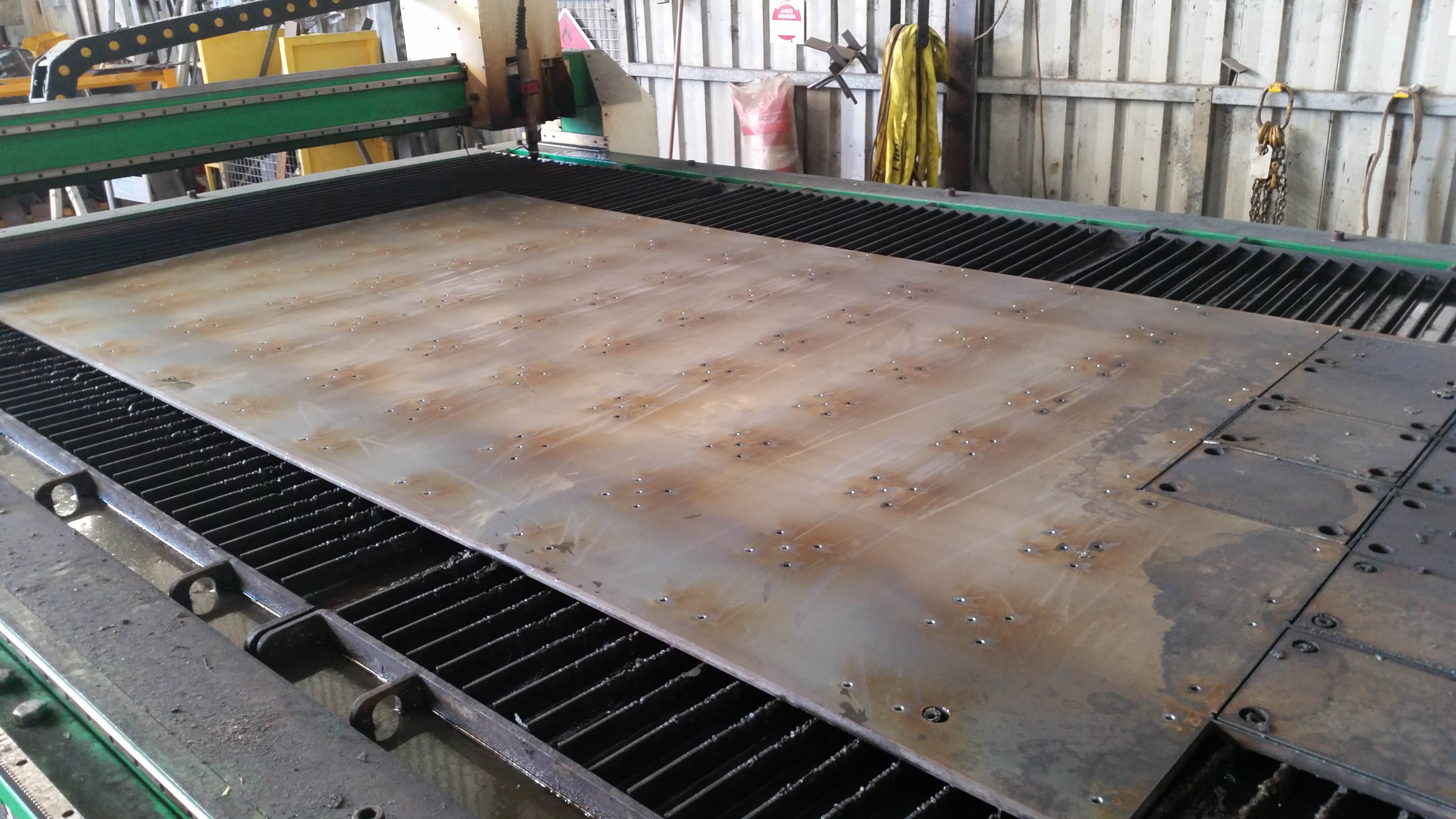

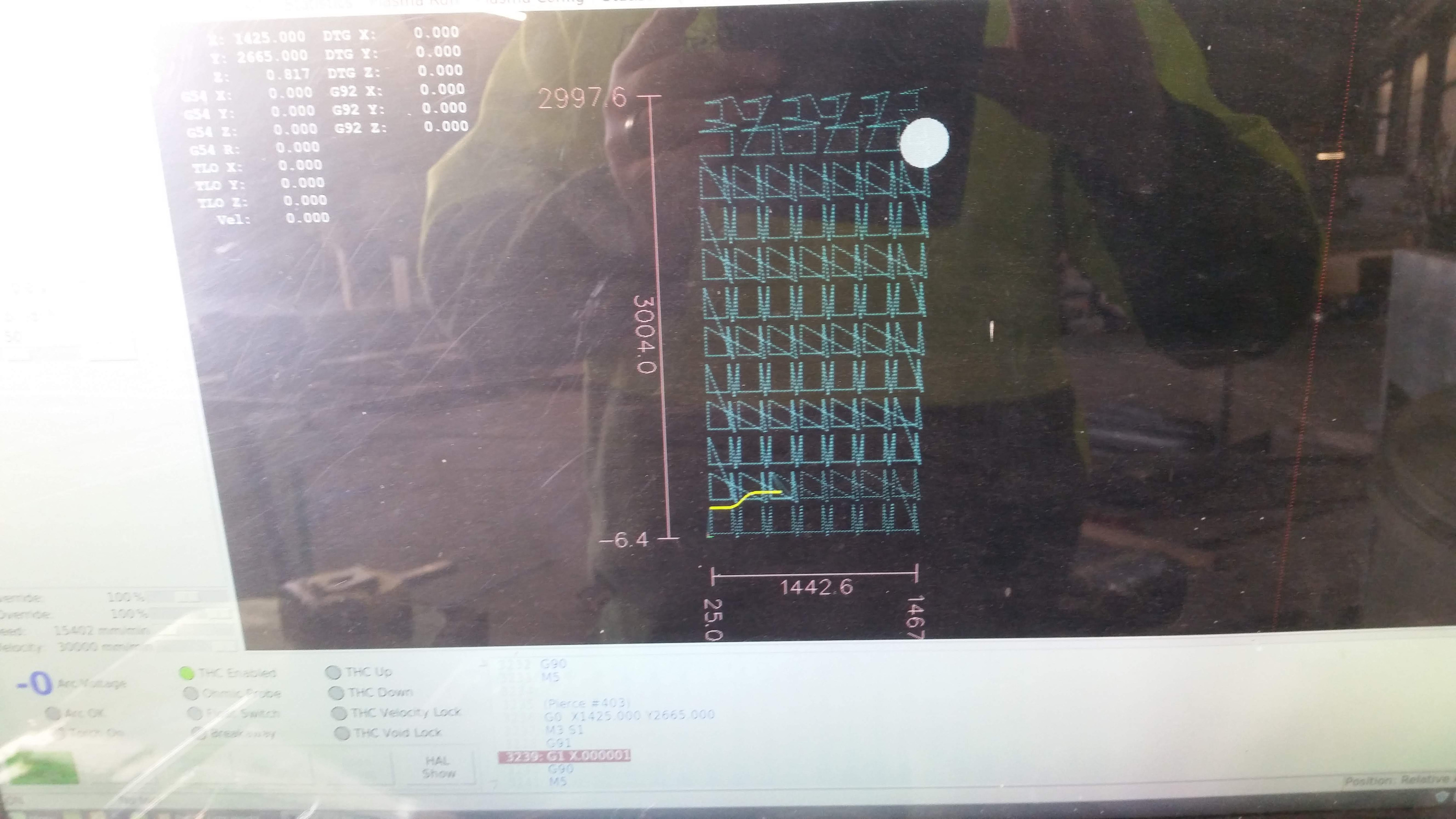

So I had a chance to use Phills pierce only function,
This was the straw that broke the camels back, Slag from the hole piecing tripping the torch when it was cutting the outside of the plate
So I generated my g-code as normal in sheetcam but I added this line of code to the start of the files,
#<pierce-only> = 1
That produced a piece only g-code files,
The result looks like this,
After cleaning it looks like this,
I am still cutting the sheet out now but have not had any issues with slag tripping the torch! Works as advertised!
