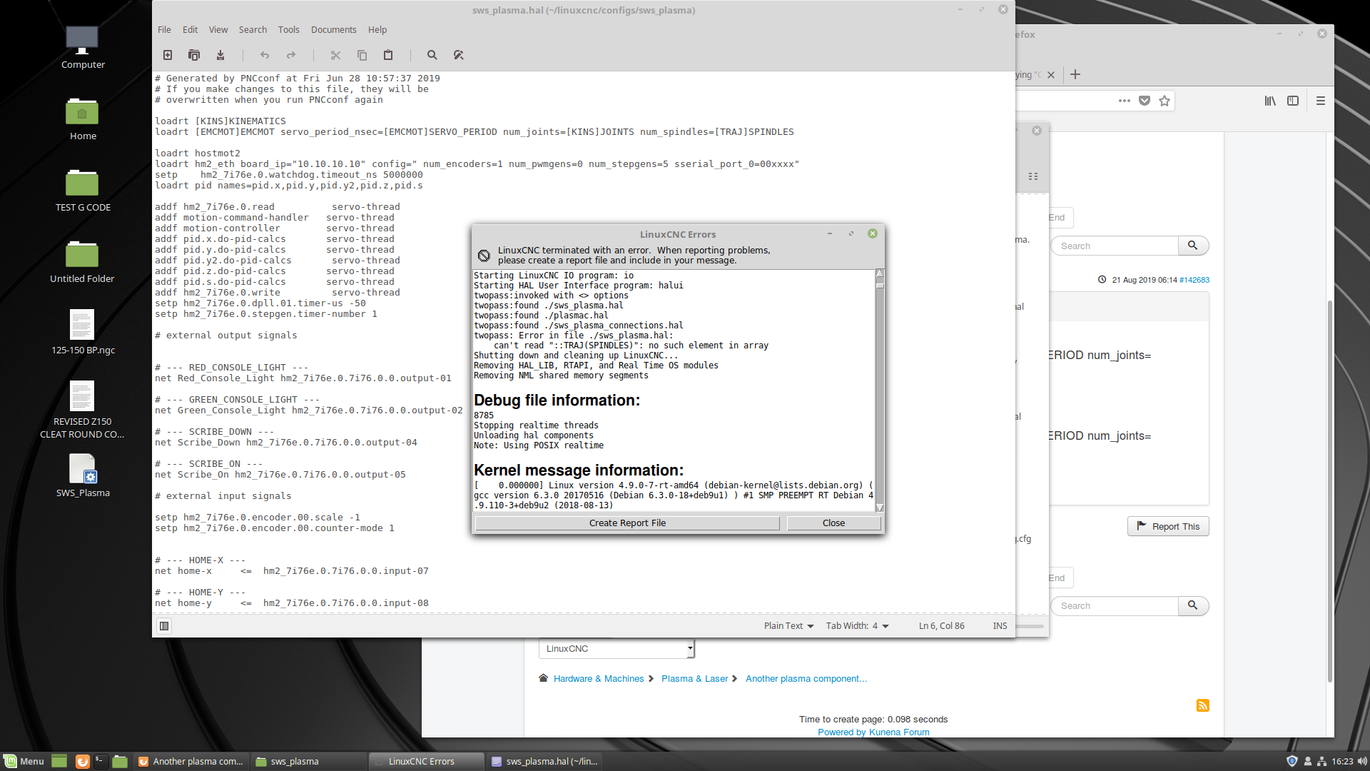

Change this line:
loadrt [EMCMOT]EMCMOT servo_period_nsec=[EMCMOT]SERVO_PERIOD num_joints=[KINS]JOINTS
To this:
loadrt [EMCMOT]EMCMOT servo_period_nsec=[EMCMOT]SERVO_PERIOD num_joints=[KINS]JOINTS num_spindles=[TRAJ]SPINDLES
And see if that fixes it.

21 Aug 2019 06:24 #142684 by thefabricator03
Replied by thefabricator03 on topic Another plasma component...
New error code,

21 Aug 2019 06:33 #142685 by phillc54
Revert that edit to how it was, try to run LinuxCNC from a terminal, post everything in the terminal after you get the error and also post your ini file.

twopass: Error in file ./plasmac.hal:
Pin 'spindle.1.on' does not exist

21 Aug 2019 06:51 #142689 by phillc54
OK...
Put the edit back in.
Then edit the INI file, in the [TRAJ] section add a line:
SPINDLES = 2

21 Aug 2019 06:55 #142690 by thefabricator03
That got it working, Thanks Phill.

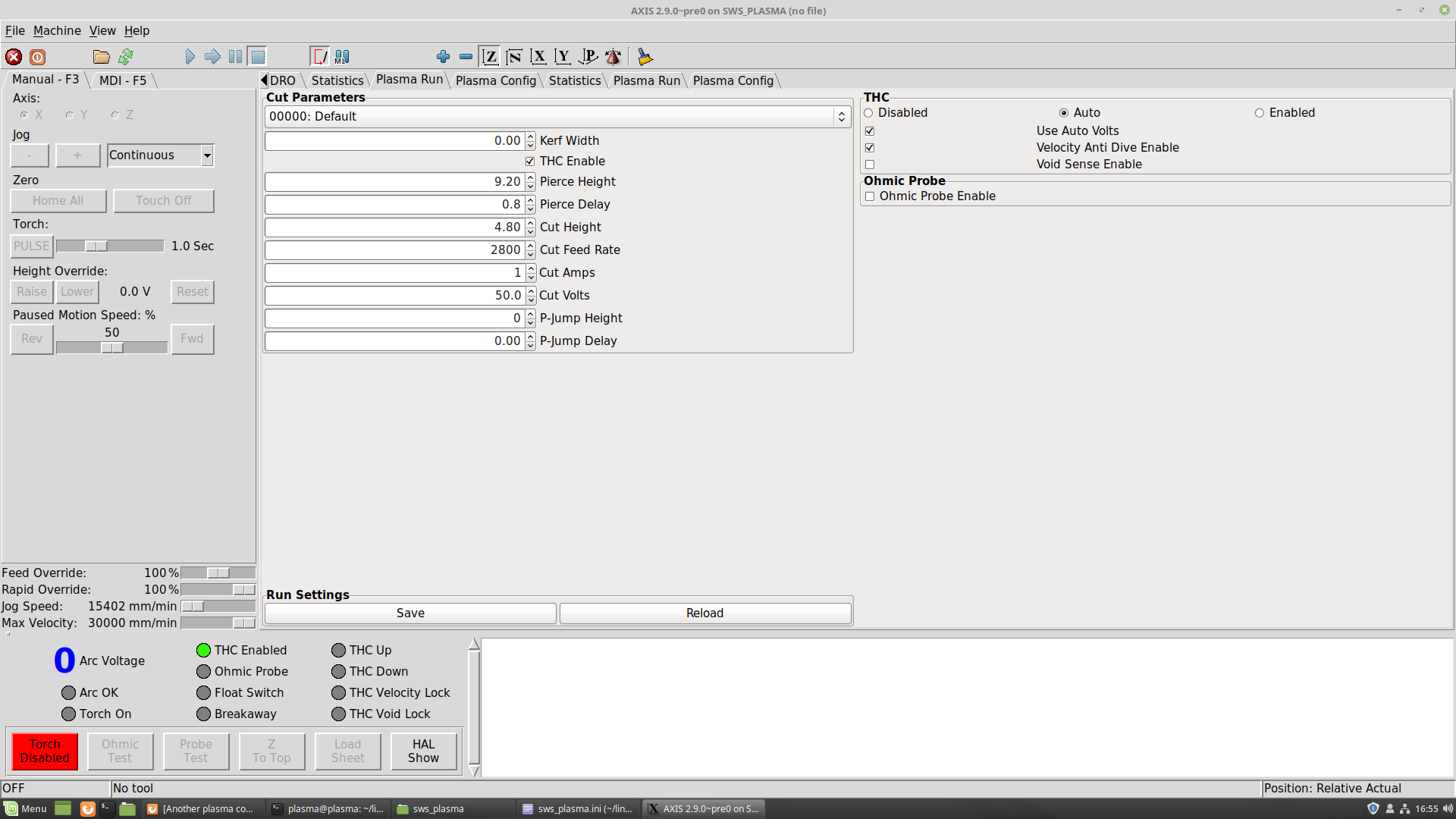

21 Aug 2019 06:57 #142691 by thefabricator03
One more strange bug I have been meaning to report,
I did a update a couple of days ago to get my ARC ok setting working from synthesized signal to using the relay of the plasma cutter,
Now I have multiple of the same tabs, I ran the configurator and overwrote my existing config,

21 Aug 2019 07:02 - 21 Aug 2019 07:05 #142694 by phillc54
Do you use the Run Tab or the Run Panel on the left?
Which button do you want to change to the Pierce option?
