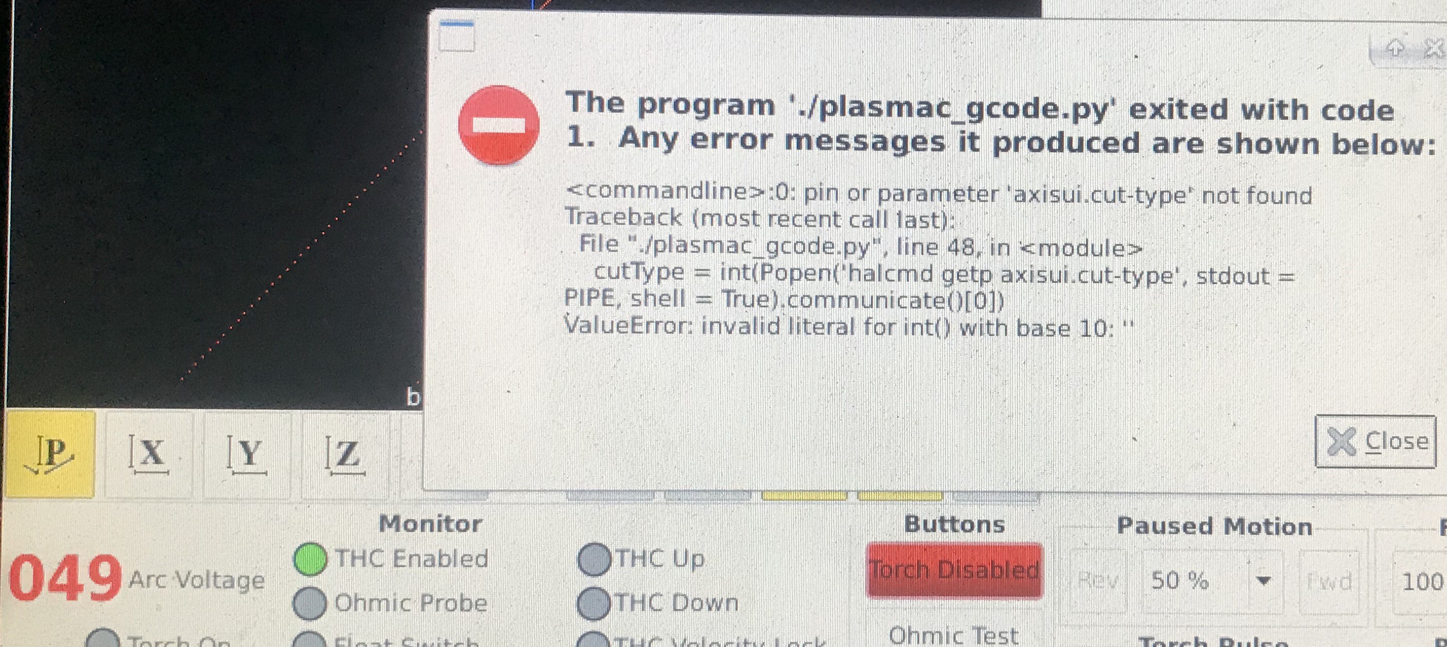

I set up a new run in place alongside my working version and called it “Darrens-Plasmac”, that all went fine as expected. I then Copied over my working hal and ini files.
On starting Plasmac I got an error regarding IHS so I commented out that line, the next attempt opened gmocappy very very slowly took a minute or more and never fully populated the screen. When I clicked to turn the machine on nothing happened other than I eventually get an error stating a limit switch was tripped, the only switch that is activated is my torch breakaway which is normally closed on the working setup, assuming it got reversed somehow in the new version.
I did also notice that in the gmocappy folder the majority of the files are just symbolic links, not sure if this is as it should be
I have not tried to run the configurator as I cannot get a working config to start from.
Should I be able to use my existing config files or do I have to start from scratch?
I have attached the file I use in my working version

18 Aug 2019 23:00 - 19 Aug 2019 00:06 #142461 by phillc54
Well maybe this upgrade will take a few more cups of coffee.
Does this mean that you created a new clone of the LinuxCNC repo and then compiled it?
Your original HAL and ini files won't work if they are just copied to a newer version.
Yes, later versions use links.
I am not sure how you got the links without running the configurator.
I am pretty sure they could be upgraded. You would need to make a copy of your config directory as a backup then run configurator in upgrade mode on your ini file.
If the files you have posted are from a working config I can edit them for you so you could use them as a base for a new configuration.

19 Aug 2019 06:47 #142473 by Dee436
Replied by Dee436 on topic Another plasma component...
Hi Phill
Yes that’s correct
I did just copy them to the newer version
They were just there after I completed th clone and compile
Yes the files I have posted are from my working earlier configuration. If you could edit them that would be great as I am a bit lost as to what to change.
Darren

19 Aug 2019 07:21 #142475 by phillc54
Darren,
Hopefully these will get you going.
Put them any where on your machine, run the configurator in New mode as these two files will be your base machine.
linuxcnc.org/docs/devel/html/plasma/plas...smac_to_base_machine
Select Mode 1
Give the new machine a name
Enter the following into the appropriate fields
arc voltage = hm2_5i25.0.encoder.00.velocity
arc ok = hm2_5i25.0.7i76.0.0.input-06
float switch = hm2_5i25.0.7i76.0.0.input-04-not
torch = hm2_5i25.0.7i76.0.0.spinena
On the fist run, set any appropriate values in the Config panel and you should be good to go.
I took the liberty of removing the arc voltage scaling and off set from your HAL file as it can be done in the Config Panel of a PlasmaC config.
Voltage Scale = 0.01313928
Voltage Offset = -48
The following user(s) said Thank You: Dee436

19 Aug 2019 15:57 - 19 Aug 2019 17:14 #142496 by Dee436
Spent quite a lot of time on this today.
I eventually commented out the air scribe in the hal file and changed spindles from 2 to 1 in the traj section of the ini file and got it to start up properly. I am now at a point where I can home and jog etc.
I still have a couple of issues though. My arc voltage is stuck at 49 and changing the offset does not make any difference. With the previous setup it registered 0 when not cutting.
Also
When trying to load any gcode I get an error message that’s prevented me being able to make any cuts to see if everything else works.
I have attached a photo that shows the static voltage reading (torch off nothing happening) and the error I receive when loading gcode programs.
Darren
