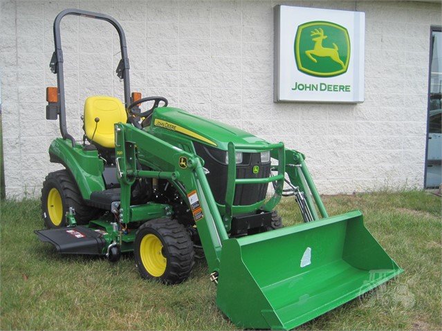

i had some riding mower issues and had the motor pretty much scatter because someone thought it would be a good idea to place plastic gears in the motor? typical throw away products these days? so i was looking around and decided to get something that would make life a little bit easier
found something that would help move stuff and cut grass
they make fork attachments for these so it's going to be my baby fork lift for outdoors operations since it's 4WD it will kill two birds with one stone
