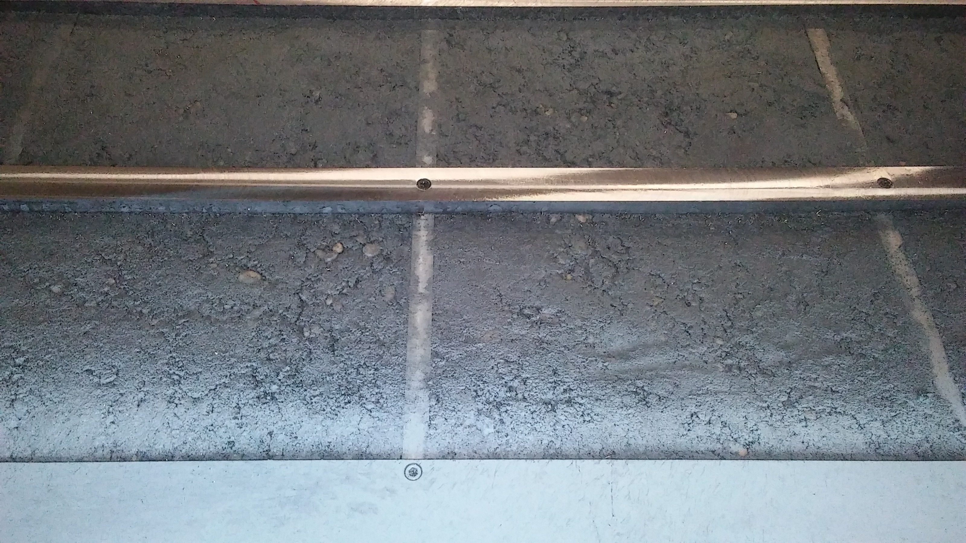

time to get back to this project. i am waiting on about 650 LBS of aluminum for my table top so i figured i would go scope out were i was and decided to clean up for a few hours today and regroup a little bit. it's amazing how bad i can destroy my work space is a short time
i had some issues with the E.G. casting sagging around the ball screw. but after i cast the frame i could no longer get under the frame to get in there to grind the problem area's so i had to jack up the entire machine so i could get to where i needed to be to fix things. the diamond concrete grinding discs work pretty well for cleaning up E.G. but they dust they make gets everywhere
i think i might have burnt myself out on this build but have the urge to get back at it again

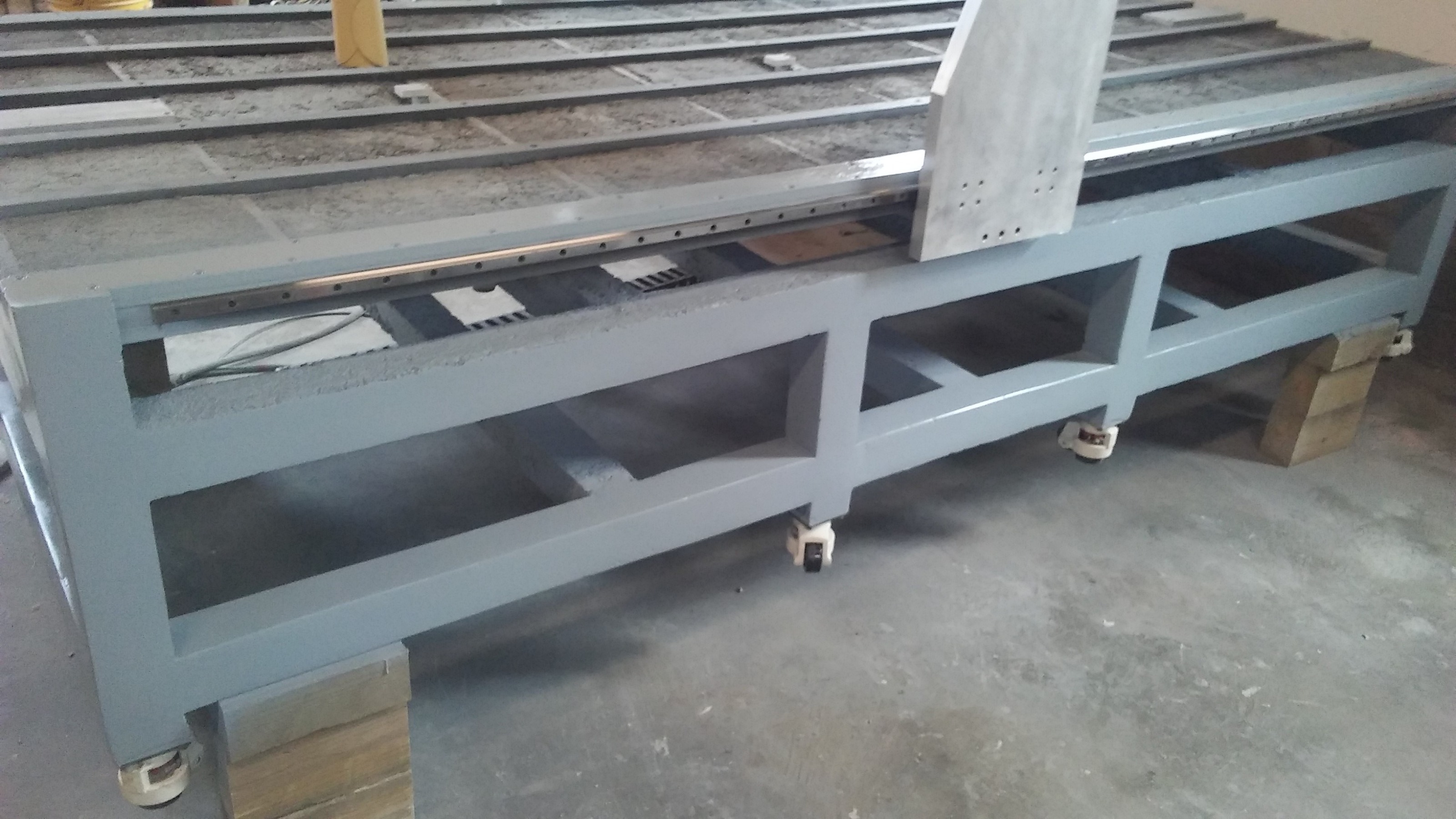

well this is as good as it gets
painting this thing was like trying to prep a lava rock to take paint
it's not perfect by any means but it's good enough for me :)i will work on making the bed flat and finding a way to attach the top sections after i figure out how to hold them so i can cut some t-slots in the 1" thick aluminum top. I'm curious to see how well everything will work once the top is in place? seems like it should be a big step up from the bare metal skeleton i tested some aluminum on before. i put an indicator on the frame after i cast the E.G. and placed everything at the center of the table at the weakest point and got on the bed before to see if things would move and with my 200 lbs i had zero movement from a little bit with just the steel skeleton. one step closer at least

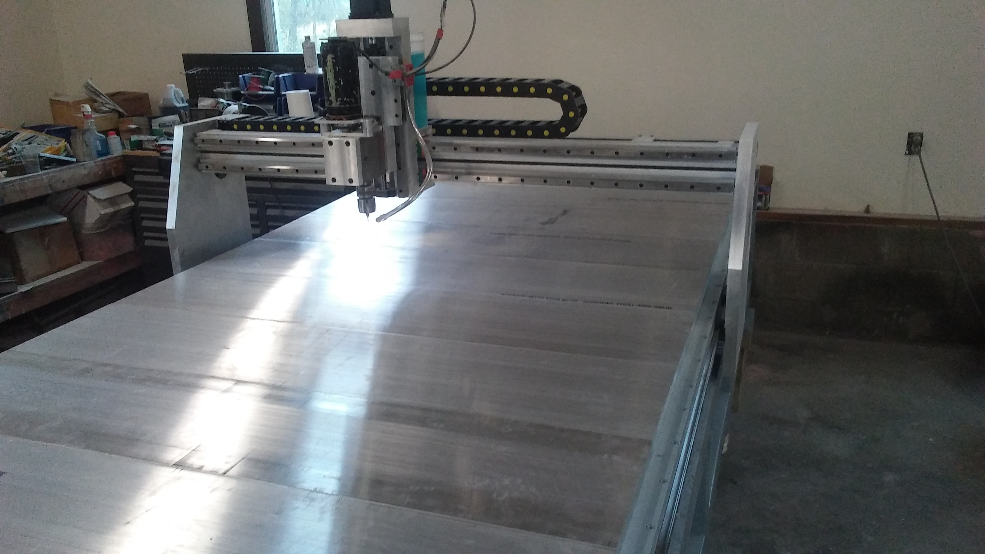

probably was a waste of time to set the slats on the bed of the machine but i wanted to see it on there to see the final heights of things so i took the time to do so anyways
starting to look almost finished
starting being the key word here
it's going to take a while to turn these into a t slot top. lots of machining since they are 55 inch long by 12 inches wide and i have 10 of them to do.
now comes the fun part getting things flat on such a big surface :)after that some final trim pieces and probably some chip guards for the linear scales once i get to that point.

this is not really the best test for cutting steel since the work holding is anything but ideal for what i am doing but i will say if the insert is sharp and with the right finishing strategy a more than acceptable surface finish can be had with what i have built. so if i can get this kind of result with hot rolled steel which is not the best material to begin with i think any Aluminum work should be pretty easy it get some pretty good results.
it's getting closer to being flat it just takes some time and effort to get there. with the fly cutter i am using i should be able to swing a big enough diameter cut to reach out beyond the travel to machine 90% of the table surface. i have about 19 inch on the back side i can't reach with the machine. that part i can basically do by hand with a indicator and some strategic grinding and draw filing
the surface area of the mounting surfaces are not that big so it should not be to bad to finish the last little bit by hand

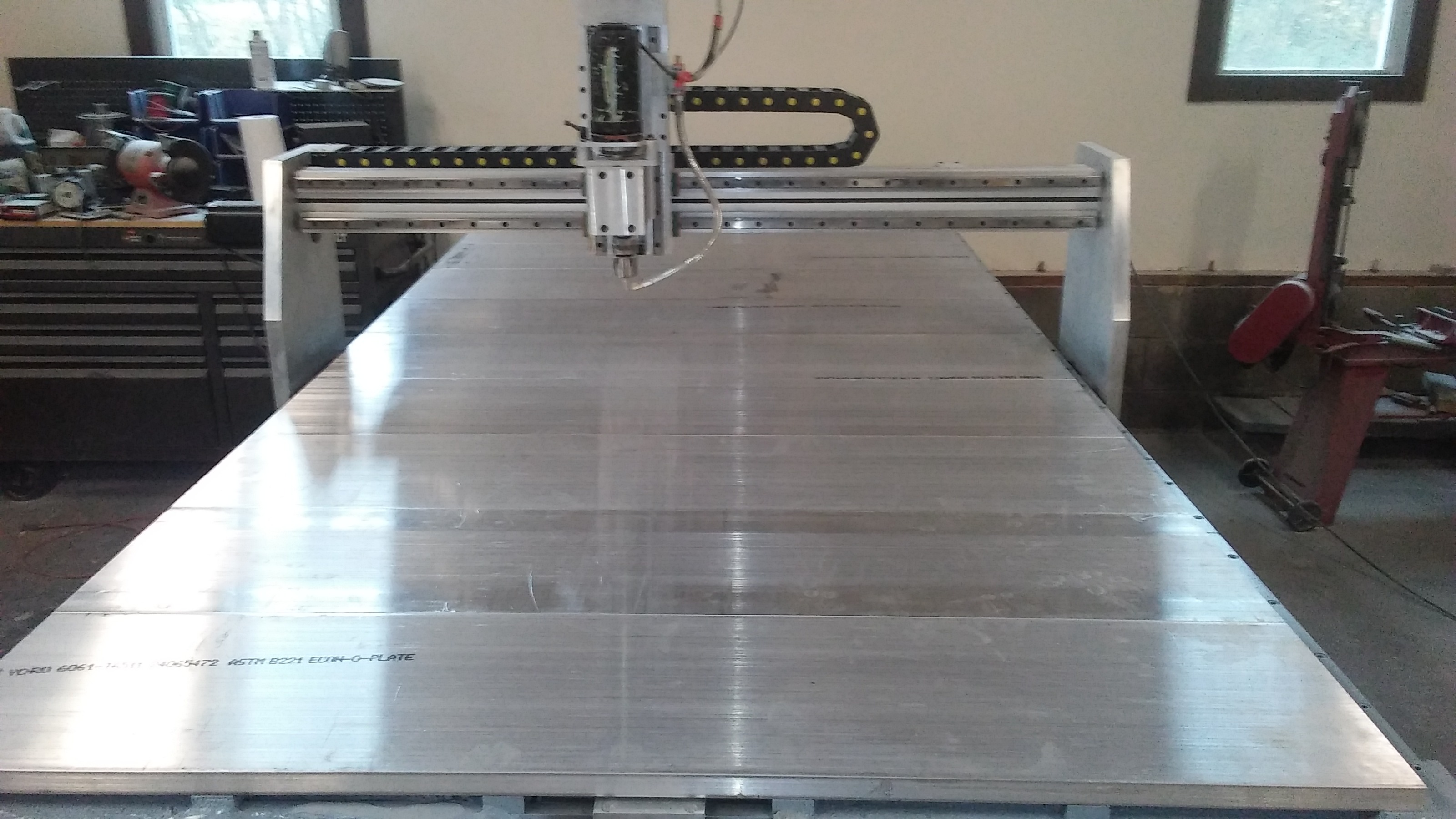

i have officially come to the conclusion gravity sucks
this whole flatness thing has turned into quite a bit of work to get straightened out. early on frame stiffness was an issue so i kept tossing steel to it until it got stiff enough. the problem was the sag never quite came all the way out after the frame got stiff. so in a nut shell all the effort to to pre machine the mounting points failed in the flatness department even though the squareness was on the money so i only got half of what i was shooting for as a result.
so after trying to see where i ended up i had to rework the linear rails on the side to remove the bow out of them. what a treat this ended up being
i'm still working on this but have both sides roughly set in place and still need to hand drill and tap the rest of the mounting holes.
thank god for double cut carbide burr tools and air tools
i had to grind the sides to create clearance so they could be moved but had to be careful not to destroy the mounting surface in the process because that is what gives me the squareness on the machine. lots of grinding and file work needless to say
it's 2020 so what else should i expect other than nothing good
