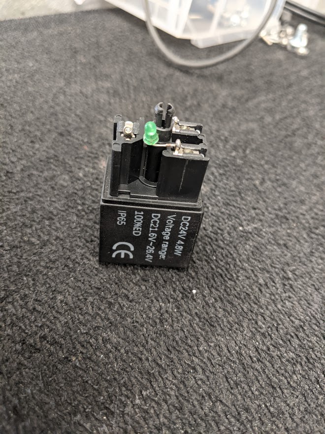

haha ... I missed that on the image I used in the schematic. I will correct it at some point.
The actual valves I am using are 24v and require 0.2A
Replied by txtrone on topic Downdraft design questions
The valves are 110V !
What current do the valves require ?
- Posts: 21902

Replied by tommylight on topic Downdraft design questions
That should do just fine.
