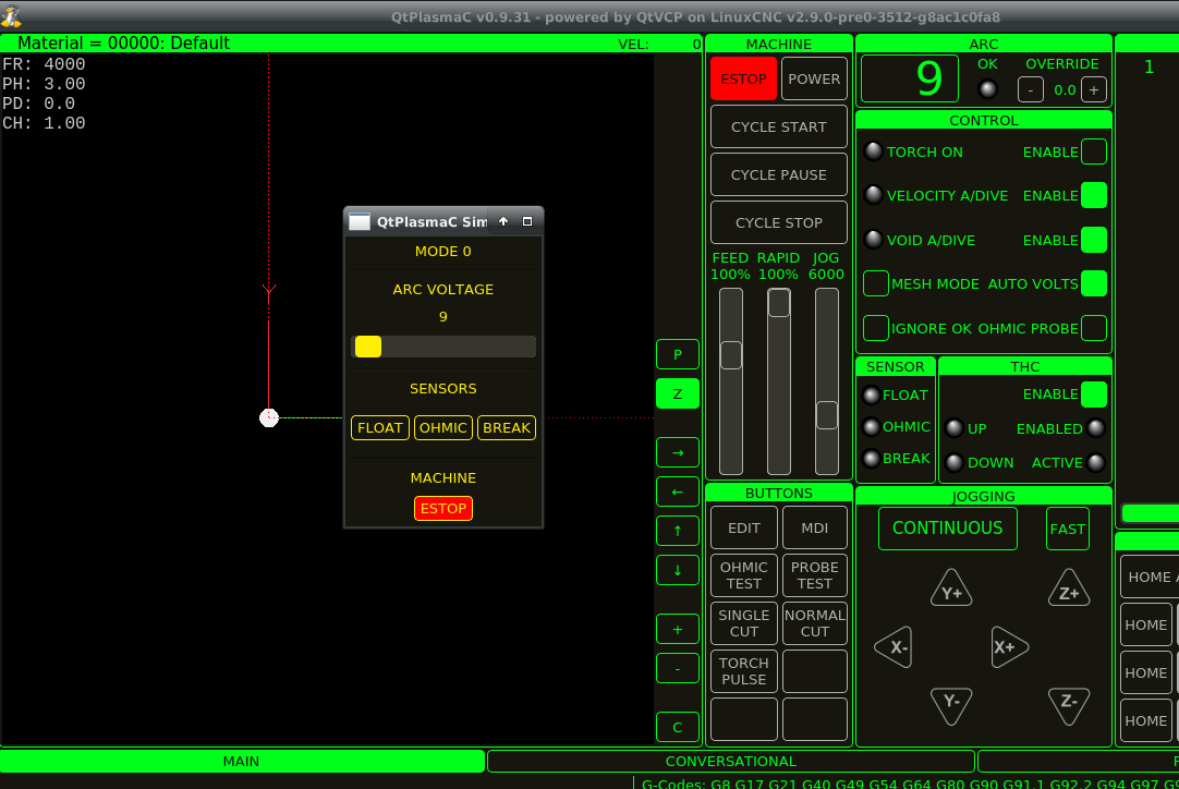

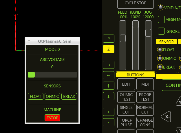

12 Feb 2021 14:18 #198567
by robertspark
Replied by robertspark on topic GUI for PlasmaC - QtPlasmac
- phillc54
- Posts: 5711
- Thank you received: 2100
12 Feb 2021 21:37 #198641
by phillc54
Replied by phillc54 on topic GUI for PlasmaC - QtPlasmac
There you go, it now uses Foreground, Background, Alt Background and Estop from the Parameters tab.Question, is it possible that this could follow the same colour scheme as the background
(every armchair user is a critic....
The following user(s) said Thank You: rodw, robertspark, snowgoer540
