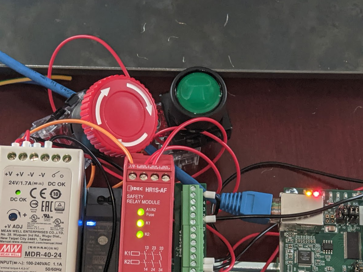

08 Feb 2021 11:37 #197986
Replied by rodw on topic GUI for PlasmaC - QtPlasmac
How hard would it be to provide the same functionality the estop GUI button has to the POWER button?
Reason being that I've been playing around with a safety relay and it requires a momentary switch (eg. the green button in the pic) to reset the relay after an estop so it does not make sense to also require a gui button press.
Early days yet...
Early days yet...
- phillc54
- Posts: 5711
- Thank you received: 2100
08 Feb 2021 11:43 #197988
by phillc54
Replied by phillc54 on topic GUI for PlasmaC - QtPlasmac
The green button seems more like a Estop reset than a power button to me.
