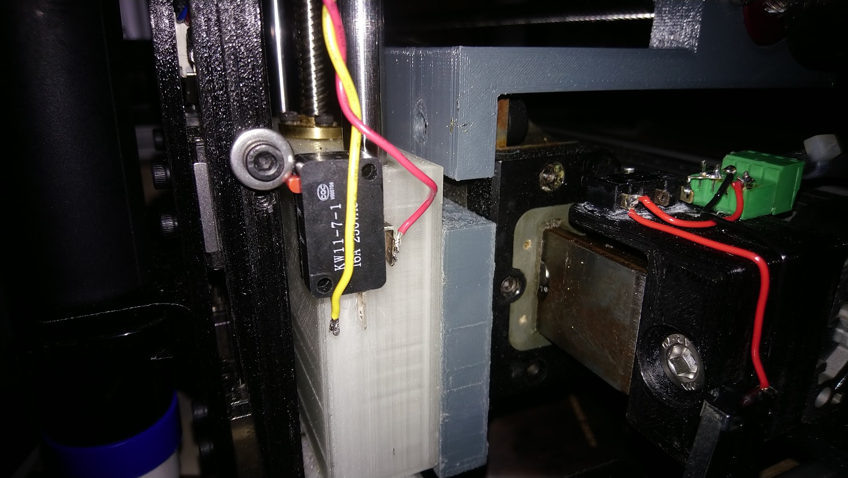

Try changing the Z scale in the ini file to -400
- tecno
- Posts: 1850
- Thank you received: 127
16 Jun 2020 11:21 - 16 Jun 2020 11:21 #171831
by tecno
Replied by tecno on topic PlasmaC questions new setup
Yes it changes the PgUp behavior but still PgDn the DRO counts up positive.
Where is torch home position to be Up or Down?

So PgUp and PgDn both move up?
Z Home should be at or near Z max limit.

Have messing around in INI, Scale -400 is correct for PgUp torch going up towards Max_Limit and Home switch.
But I cannot get DRO to show 90 as it should ? Or am I barking at the wrong tree?
I have total 105mm and want my home to be like 15mm lower than max
DRO to show 90 when homed.

EDIT: from the ini file your home switch is near the bottom, 15mm above Z minimum limit.
Replied by phillc54 on topic PlasmaC questions new setup
After you home the machine, jog it all the way to the bottom then do a touchoff with a value of zero. Home the machine again and it should be good to go.Have messing around in INI, Scale -400 is correct for PgUp torch going up towards Max_Limit and Home switch.
Last edit: 16 Jun 2020 11:52 by phillc54.

Where is your home switch located in relation to your Z maximum limit?

So now I have it working.Config with 0 safe height. After cuts torch returns to 0
[JOINT_2]
AXIS = Z
MIN_LIMIT = -105
MAX_LIMIT = 0
MAX_VELOCITY = 40
MAX_ACCELERATION = 100
TYPE = LINEAR
SCALE = -400
STEPGEN_MAX_VEL = 60
STEPGEN_MAX_ACC = 150
FERROR = 0.0051
MIN_FERROR = 0.0025
# HOME = 95
DIRSETUP = 5000
DIRHOLD = 5000
STEPLEN = 2500
STEPSPACE = 2500
DEADBAND = 0
P = 1000
I = 0
D = 0
FF0 = 0
FF1 = 1
FF2 = 0
BIAS = 0
MAX_OUTPUT = 0
MAX_ERROR = 0.0127
HOME_USE_INDEX = NO
HOME_OFFSET = -11.00000
HOME_SEARCH_VEL = -10.000000
HOME_LATCH_VEL = 6.00000
HOME_FINAL_VEL = -2.00000
HOME_USE_INDEX = NO
HOME_IGNORE_LIMITS = YES
HOME_SEQUENCE = 0

11mm under Z max
11mm under Z max
