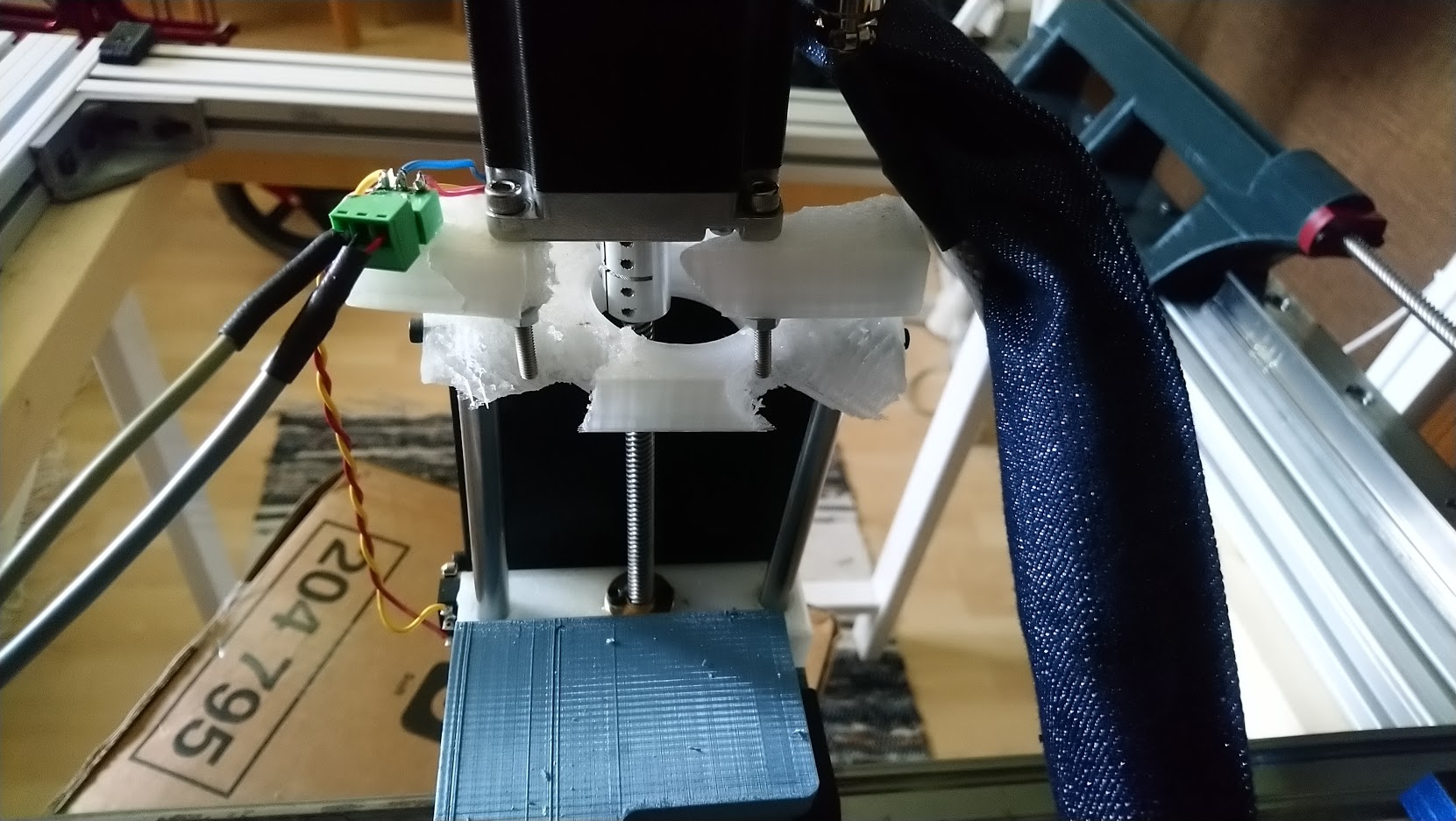

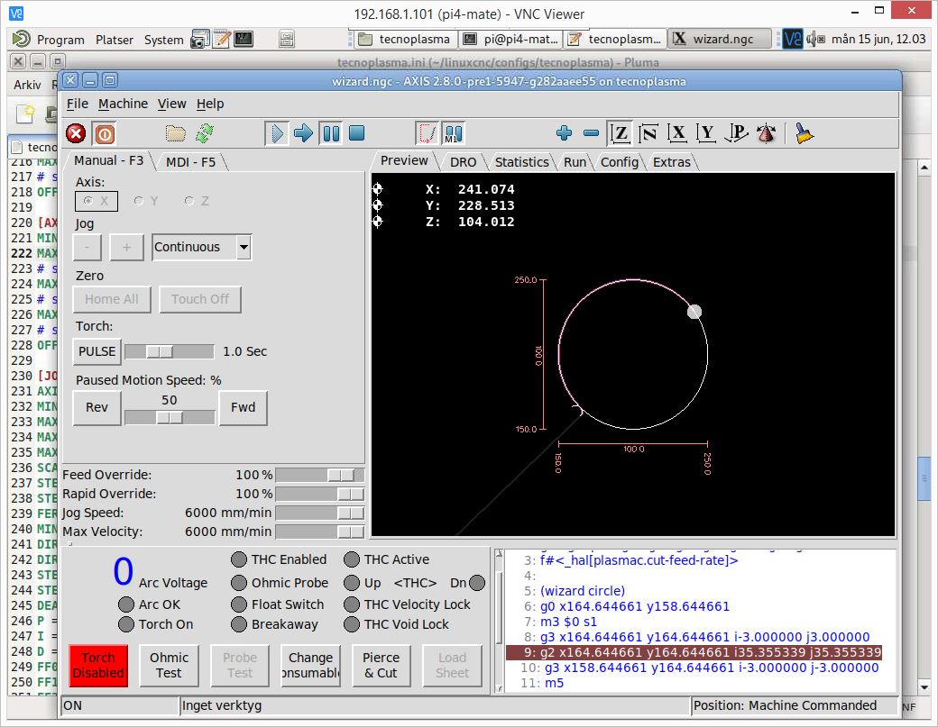

15 Jun 2020 10:10 #171729
by tecno
this example is cutting at like -50, pressed pause and the rocket went up and ripped the rest of the stepper holder
This must be wrong
[AXIS_Z]
MIN_LIMIT = -105
MAX_LIMIT = 105
Good reason to 3D print parts as Mr Murphy is always around
Replied by tecno on topic PlasmaC questions new setup
Safe Height and Probe Height are relative to the Z minimum limit.
This must be wrong
[AXIS_Z]
MIN_LIMIT = -105
MAX_LIMIT = 105
- phillc54
- Posts: 5711
- Thank you received: 2100
15 Jun 2020 10:15 - 15 Jun 2020 10:15 #171730
by phillc54
Replied by phillc54 on topic PlasmaC questions new setup
I set my Z limits like this. linuxcnc.org/docs/2.8/html/plasma/plasma....html#_initial_setup
I set my Z minimum limit as zero and maximum limit as a positive number.
Last edit: 15 Jun 2020 10:15 by phillc54.
