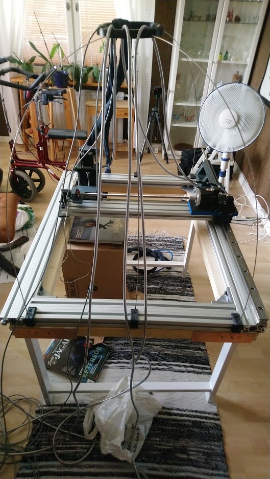

As you have it now, it will trip during work, as the material will deform during cutting and the torch will have to be set to whatever the material height is, moving the Z axis position to above the switch in worst case scenarios.
Replied by tommylight on topic PlasmaC questions new setup
Home switch should be at the top of the Z axis travel.This just avoid leaving Z above home switch when shutting down LCNC
That is the reason why i wrote the above, in that picture the screw that trips the switch is above the switch.
If the max_limit is set under that switch, that is all good.
Although i would have added a piece of thin sheet to trip the switch and have it stay tripped up to the hard stop.

Doc's say this.
axis Z HOME should be at or just below axis Z MAXIMUM_LIMIT.
If I do this
Then I can not home if necessary or ??
If I do this

I see your point Toma
Adjusted max to +5 and moved home offset = IT WORKS.
THANK YOU !
THANK YOU !
