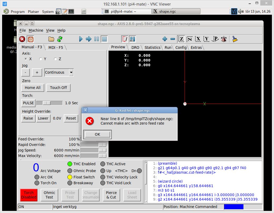

So at last I have my plasmaC loading.
Tried to use extras and wanted to run a circle but it posts without any F
Where is this done to have a feedrate for extras?

13 Jun 2020 07:10 #171413
by phillc54
Replied by phillc54 on topic PlasmaC questions new setup
There should be a line F#<_hal[plasmac.cut-feed-rate]> that reads the feed rate from the cut parameters in the Run Panel

13 Jun 2020 07:28 #171416
by tecno
Replied by tecno on topic PlasmaC questions new setup
- phillc54
- Posts: 5711
- Thank you received: 2100
13 Jun 2020 07:35 #171420
by phillc54
You need a valid Cut Speed in the Run Panel before you load/create/reload the file.

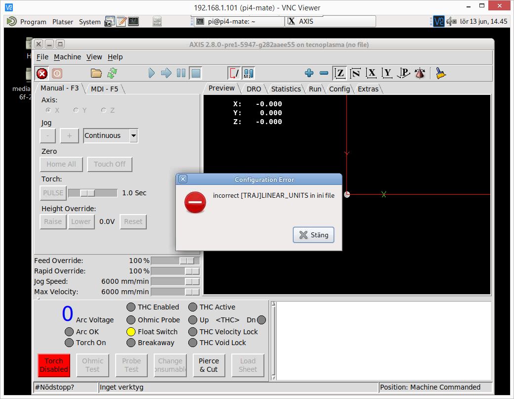

Also you reminded me about expanding the disk, now I get warnings of disk capacity of only 4.2G insteand of close to 30G
How can I solve this? there is nothing in raspi-config

- Posts: 22049
- Thank you received: 7509
13 Jun 2020 08:13 #171432
Replied by tommylight on topic PlasmaC questions new setup
Most probably you have a comma instead of a dot in the ini file, traj section.
- tecno
- Posts: 1850
- Thank you received: 127
13 Jun 2020 08:15 #171433
by tecno
INI in base install or plasmaC?
