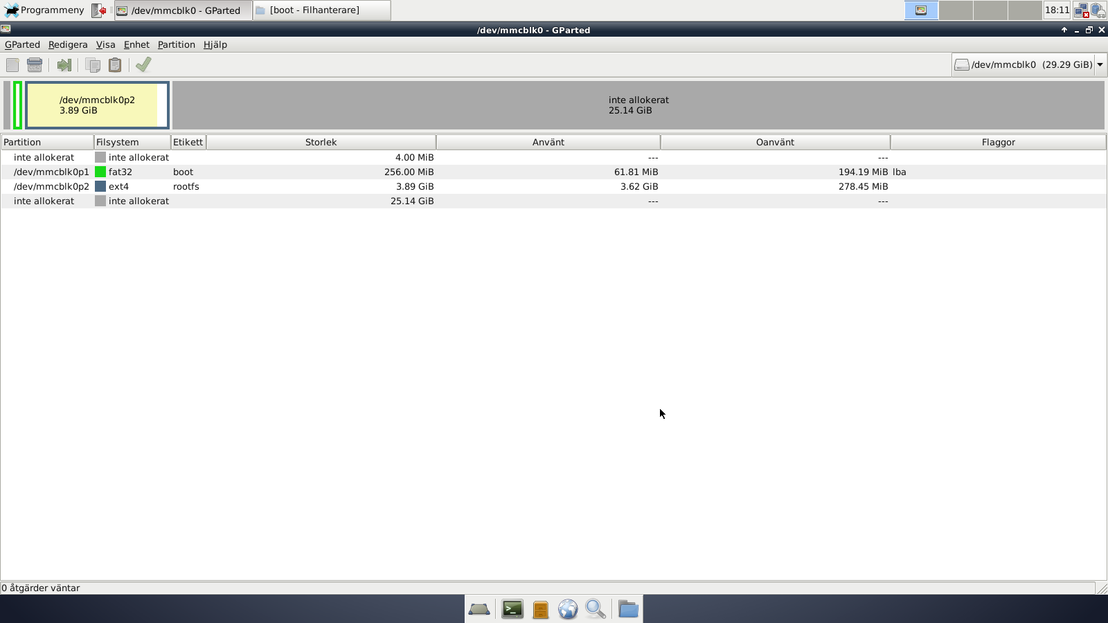

Creating backup img just now, will try to get card expanded. With 4GB I come nowhere
- tecno
- Posts: 1850
- Thank you received: 127
13 Jun 2020 14:39 #171461
by tecno
Replied by tecno on topic PlasmaC questions new setup
Made image copy but now I can not write that 32G cardcopy to a new 32GµSD
The image is a bit bigger

13 Jun 2020 14:42 - 13 Jun 2020 14:44 #171462
Replied by tommylight on topic PlasmaC questions new setup
You can use clonezilla for that, it has a setting for exactly that under the advanced settings, but it will warn that the end result might not work properly.
Most of the time it did work for me, but if there is data stored at the end of the storage, it might fail.
Or use gparted on another PC to shrink the end of the storage.
Last edit: 13 Jun 2020 14:44 by tommylight. Reason: More info

13 Jun 2020 15:41 - 13 Jun 2020 15:41 #171463
by tecno
Tried to allocate max on another µSD with Gparted but still to small.
img = 29.2 and SD is 28.9
So I need 64GB µSD to be safe with my functioning µSD (I hope)
To shrink I can do when I have a running copy in my hand.
Last edit: 13 Jun 2020 15:41 by tecno. Reason: text
