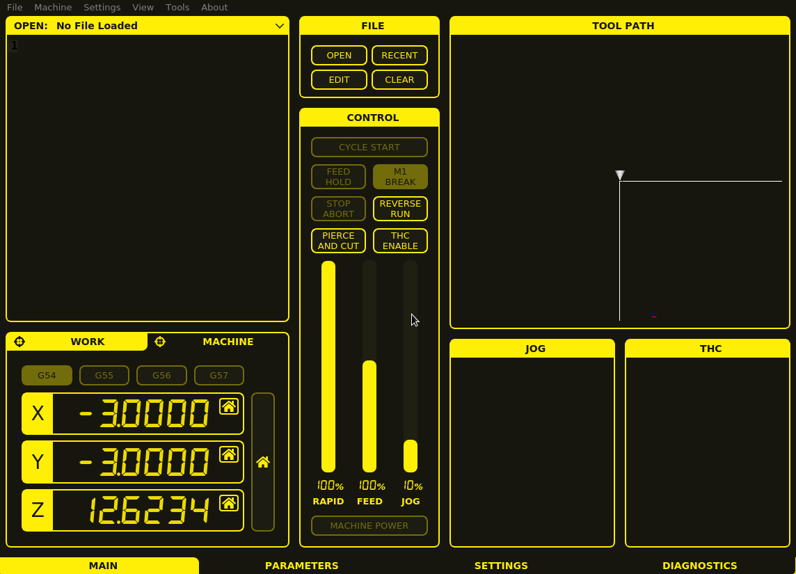

28 Sep 2020 03:18 #184094
Replied by rodw on topic MonoKrom - QtPyVCP GUI for PlasmaC
The plasmac user guide is here
linuxcnc.org/docs/2.8/html/plasma/plasma...ml#material-handling
The Plasmac component is here
linuxcnc.org/docs/2.8/html/man/man9/plasmac.9.html
The cut parameters are stored in a separate .cfg file so the gui needs to parse it and allow a popup selection to select one.
I've attached mine.
If you review the plasmac sim in 2.8 or 2.9, there should be some hal or tcl files that map all the GUI pins to the component. Typically they take their name from the Tab name
Ideally somebody should share their config. Mine is too complex to be a good example. Maybe Pinder or Snowgoer could assist.
I've attached mine.

28 Sep 2020 03:33 #184096
by phillc54
github.com/LinuxCNC/linuxcnc/blob/master...s/by_machine/plasmac
For the run panel the python file is:
github.com/LinuxCNC/linuxcnc/blob/master...asmac/plasmac_run.py
The permanent hal connections are:
github.com/LinuxCNC/linuxcnc/blob/master...smac/plasmac_run.hal
The run.cfg file stores the settings plus the default material, the material file stores all other materials. The run panel also has the ability to add/edit/delete materials.
An example config file is:
An example material file is:
Replied by phillc54 on topic MonoKrom - QtPyVCP GUI for PlasmaC
It is a bit hodgepodge because of the way it grew, all the relevant files are here:Got the parameters run page pretty much done, but I don't know what the settings are supposed to hook into. I will need some help with understanding how that is all supposed to work with PlasmaC.

28 Sep 2020 04:02 #184101
by KCJ
Replied by KCJ on topic MonoKrom - QtPyVCP GUI for PlasmaC
Doesn't look terribly difficult, at least that's what my sleep deprived brain thinks after reading the PlasmaC docs since I was too tired to sleep.
Reading and writing the material files is easy. And then it looks like there are HAL pins for the rest, which again shouldn't be difficult.
Looks like it's going to be a busy week with clients flying in (unusual since COVID started), but hopefully I'll have some time to play with it.

28 Sep 2020 12:09 #184150
Replied by tommylight on topic MonoKrom - QtPyVCP GUI for PlasmaC
Now that we are all gathered here, would someone more light handed than me make a list of what needs to be on what window and what should be hidden on other tabs, so we can make a democratic choice by voting and have KCJ implement something completely different ?
All jokes aside, great work so far, but now it is getting to the point where ideas are poring in, so to save KCJ much needed time and nerves, it would be nice to decide on a set of stuff and stop adding things as there is no tomorrow.
