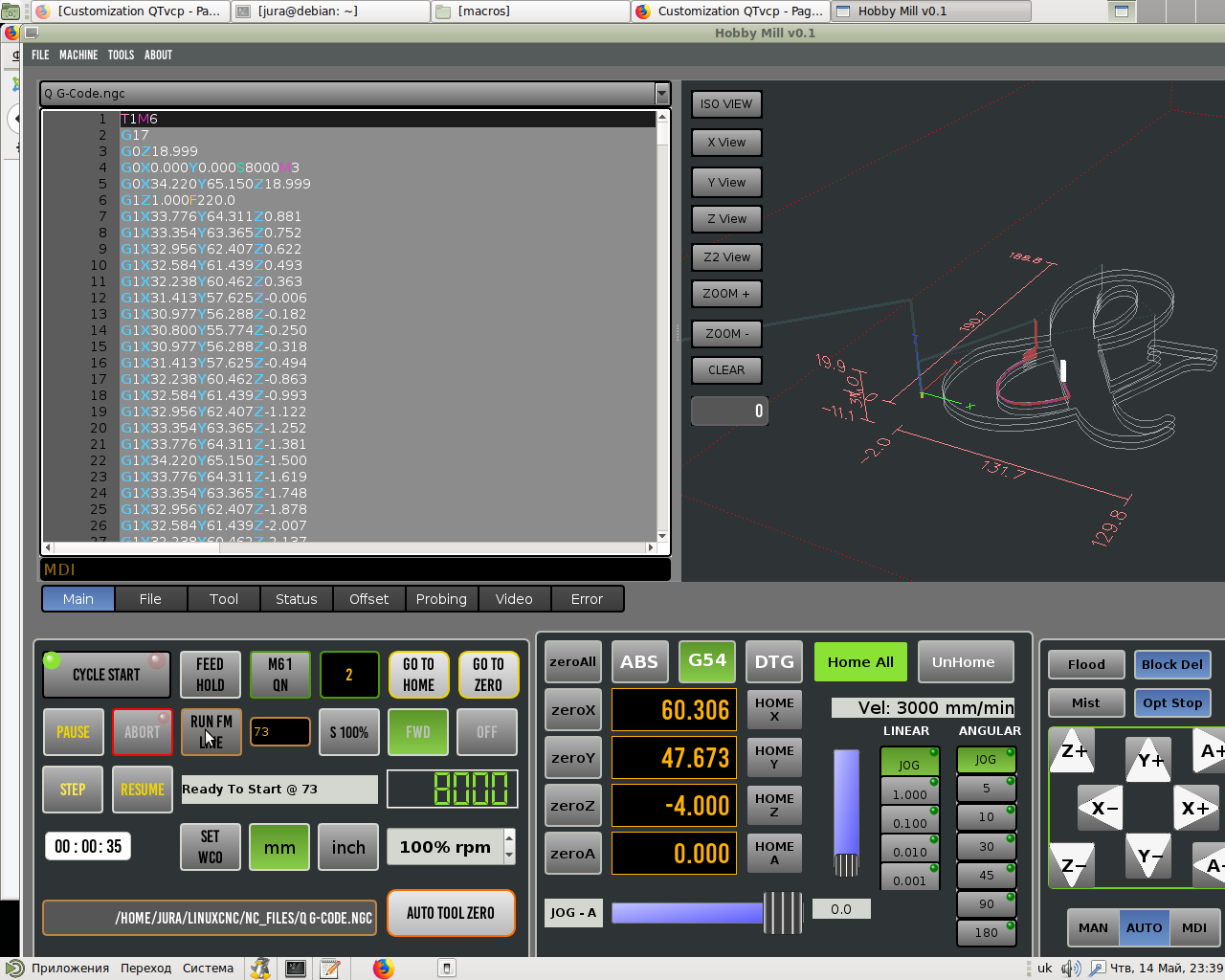

Replied by hottabich on topic Сustomization QTvcp
Thank! Everything is working. Thanks to you, I realized my dream! I created macros return.ngc allowing after stopping the program to move the tool on the table and go back turn on the spindle at a given speed, and set
feed rate. For complete happiness is not enough RUN FROM HERE according to the algorithm given in the archive. I ate but lacked knowledge. Tell me please if it is possible and you will have a free minute.

14 May 2020 16:52 #167761
Replied by cmorley on topic Сustomization QTvcp
You can set spindle running in MDI and then run from line should keep that spindle setting.
I tried setting the feedrate in MDI but it didn't seem to work - it may be a linuxcnc bug.
You could write a function that sets the spindle with a MDI command then calls run-from-line.
Usually one selects the line in the gcode_display widget.
Please be specific about what doesn't work.
Chris

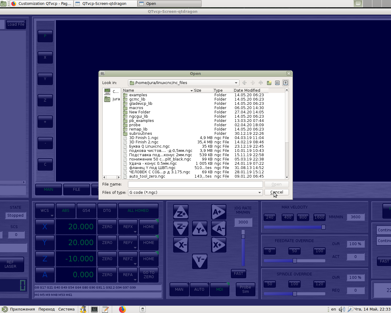

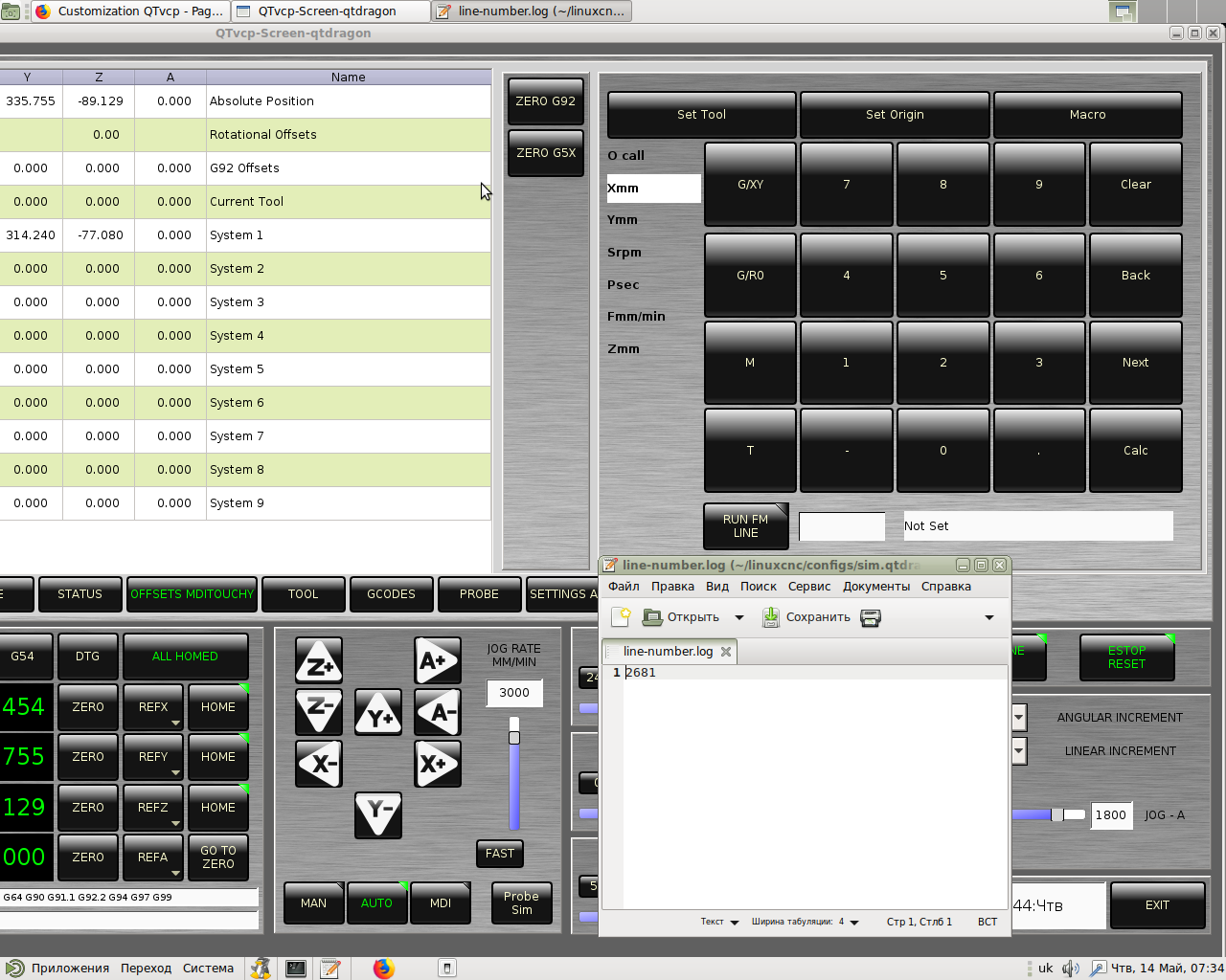

Everything works great. Please open the file from the archive return.ngc and you will see what it is for. File from G54 x0, y0, z0 returns tool to point program stop (the milling cutter has broken, it is necessary to clean it ....) sets the feedrate, starts the spindle at the set speed and lowers it after a pause Zxx tool. All data is written to the Macro mdi_touchy section immediately after stop. And after that you need to go from the break line (the line number remembers my interface in line-number.log). But looking for the right line is not soon. Now, if I could beat the ability to register the line number in the Line window. As an option, Setup From Here from the archive. But to implement it in Qtvcp will not work. Something like this. After the update, the load dialog does not close file after cancel the window of the file . Linuxcnc 2.9.0~pre0.2047
Last edit: 14 May 2020 19:37 by hottabich.
- Posts: 7368
- Thank you received: 2181
14 May 2020 20:09 #167781
I'm having a bit of trouble understanding...
I think you mean you are getting the wrong line logged. Yes this is a known problem with linuxcnc - there is currently no work around.
Oh oops ! I'll fix that soon. Thanks.
Chris
Chris

14 May 2020 20:32 - 14 May 2020 20:40 #167785
by hottabich
Thank you for the attention! It’s really hard for me to communicate my messages with Google translator. Here is the macro and Run from here like mine in qtpyvcp. Very comfortable and very bistro to go from the line. The macro works in mdi touch.

- Posts: 7368
14 May 2020 22:28 #167790
Yes I'm sure it is difficult to understand me too with Google translate.
How do you wish to enter the line number to start from?
Do you wish to enter it in editbox widget?
Your PyQtvcp example seems to have a box to enter the line number in.
Is that what you want?
Chris
Chris
