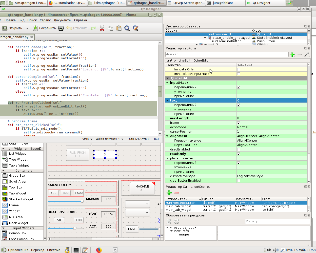

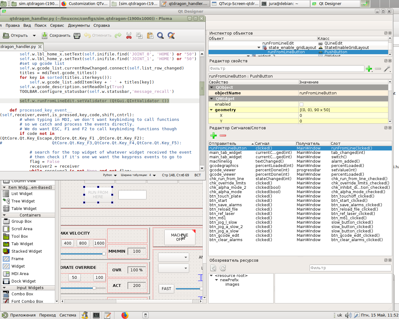

I did it as in the screenshots. I can not register the line number. What's wrong?
Last edit: 15 May 2020 04:10 by hottabich.
- Posts: 7368
- Thank you received: 2182
15 May 2020 11:50 #167874
Replied by cmorley on topic Сustomization QTvcp
Oh wait looks like you have readonly checked on the line edit widget.
uncheck that property

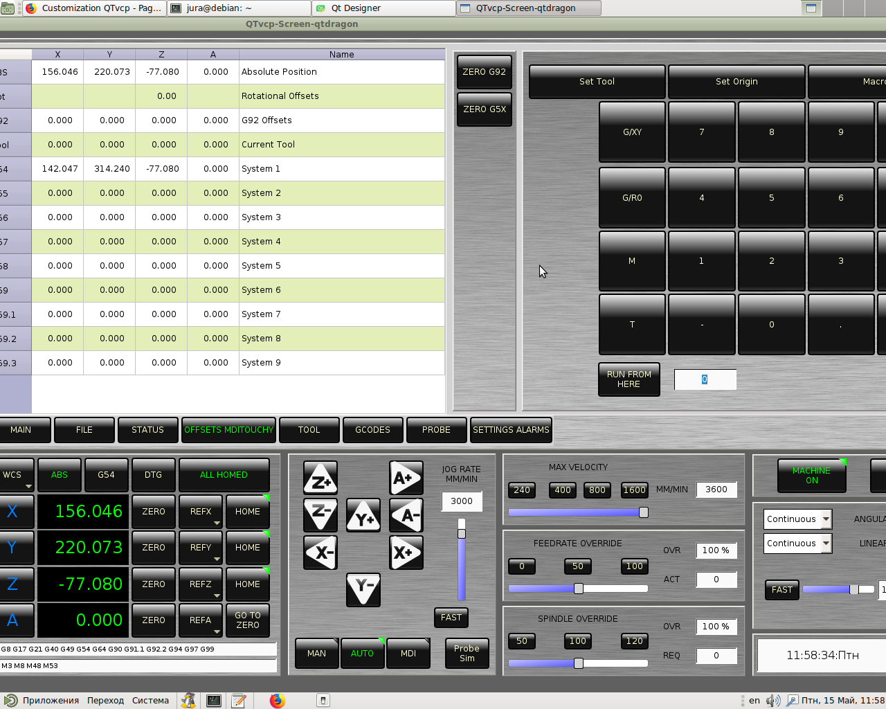

Super!!! After pressing the Push Button, the LineEdit window should be cleared and the button will become inactive, this is necessary. There was an incomprehensible problem after stop the tool continues to move with the spindle switched off. With RunFromHere it is not connected, I turned it off. Thank! Only problems in linuxcnc2.9, in 2.8 they are not here.

Hello! Is it possible to add such a RUN FROM LINE option to QtVCP?
This will be perfect. Thank.

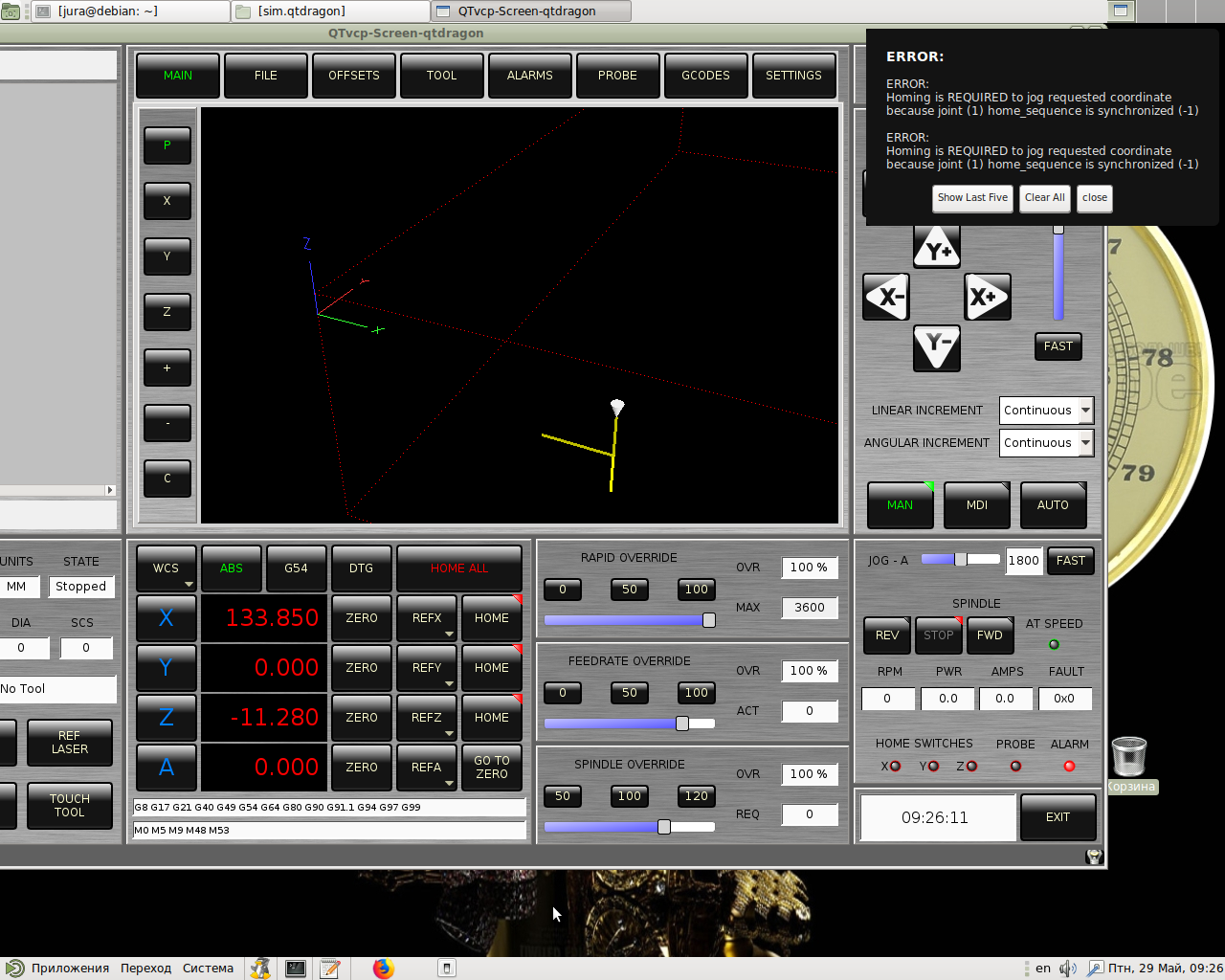

NO_FORCE_HOMING = 1. Axis Y error. How to fix?
- Posts: 22043
- Thank you received: 7506
29 May 2020 02:21 #169285
Replied by tommylight on topic Сustomization QTvcp
Do you have 2 motors for the same axis ?
That is the error displayed when you try to move a gantry machine with two motors on the same axis, it will not move without homing the machine first.
