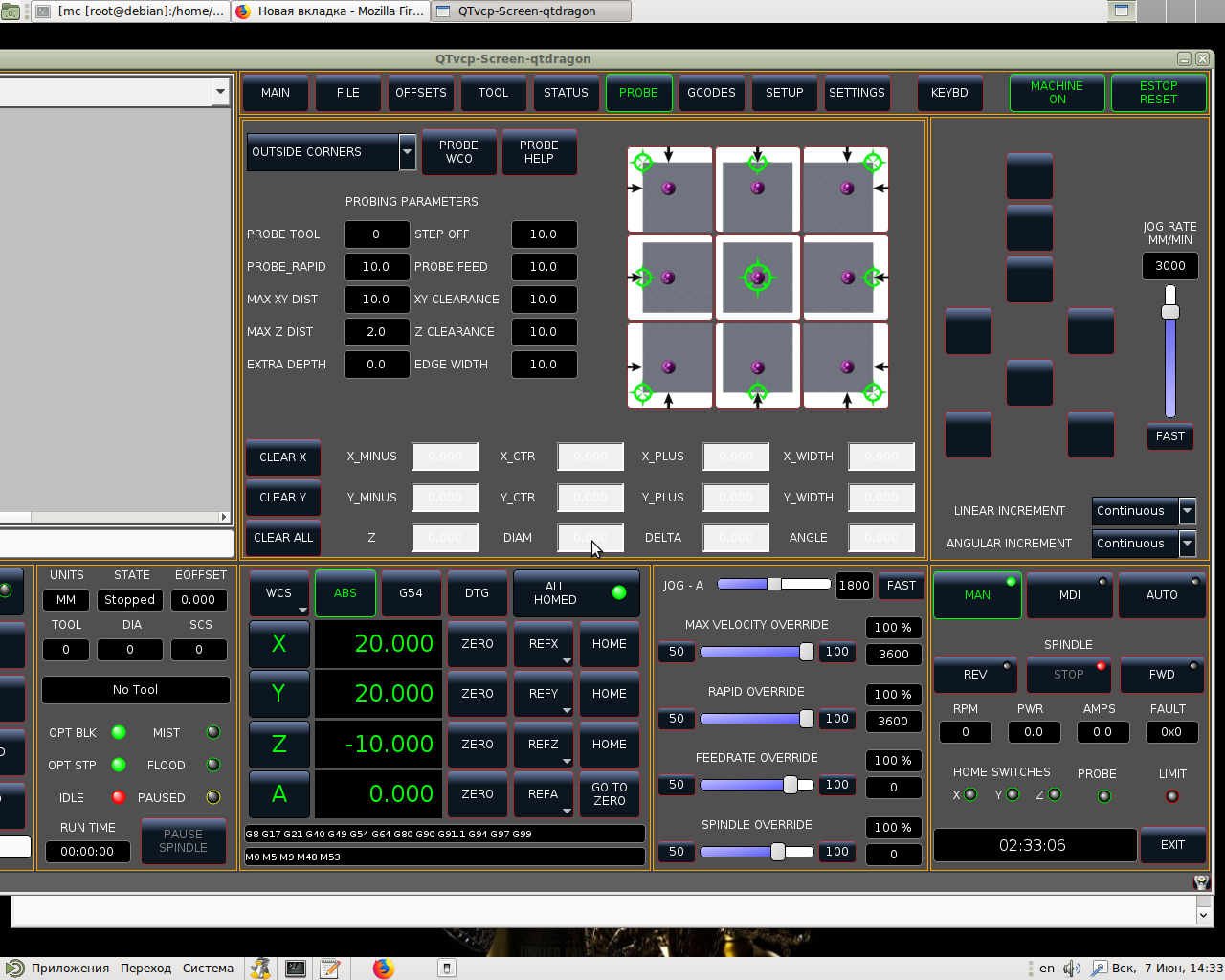

07 Jun 2020 09:35 #170487
by hottabich

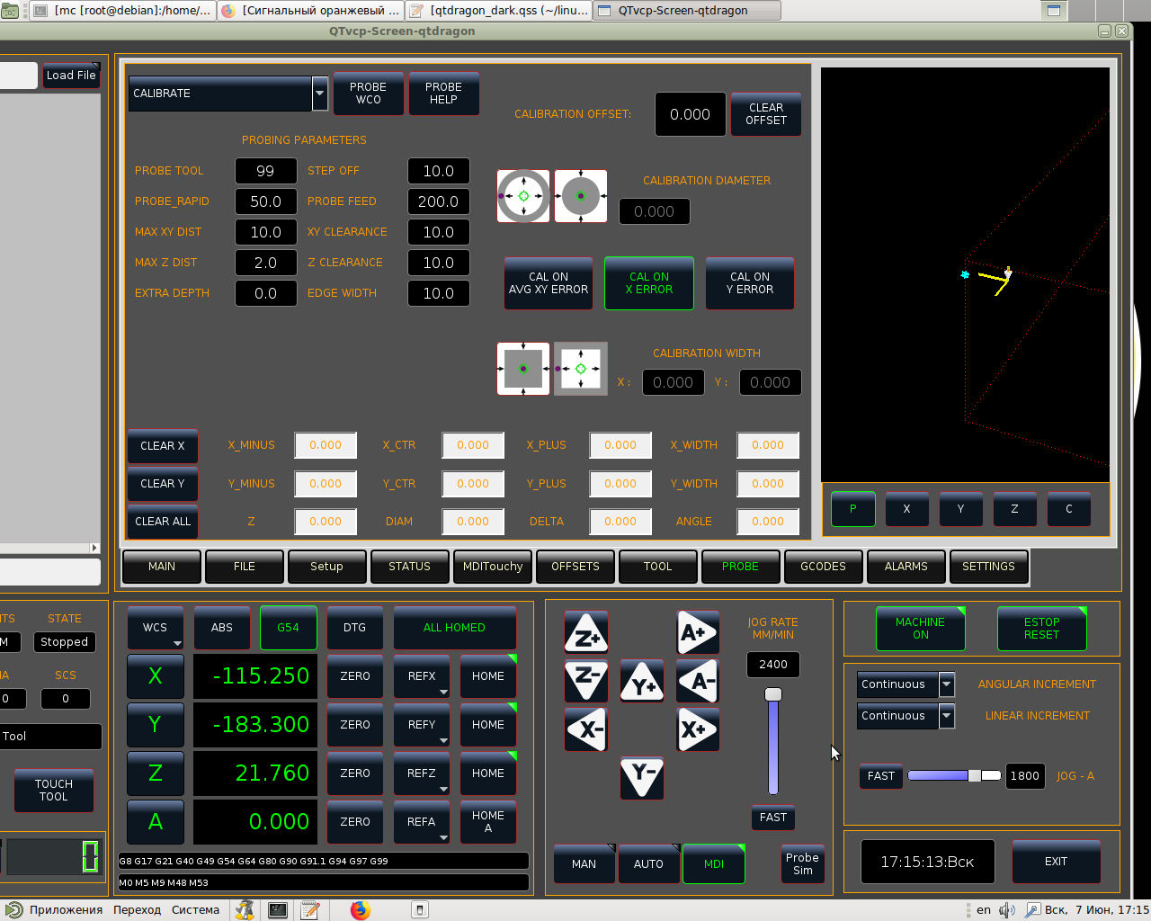

Replied by hottabich on topic Сustomization QTvcp
Hello! In the latest edition of QtDragon, replace the qtdragon_dark.qss file with the attached one. It will become like in the screenshot.

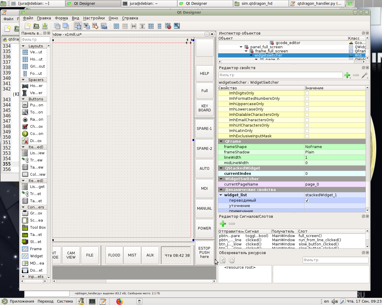

17 Sep 2020 01:47 #182511
by hottabich

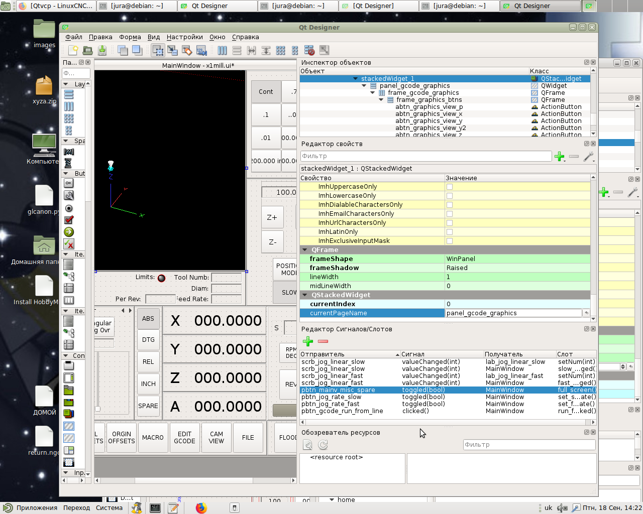

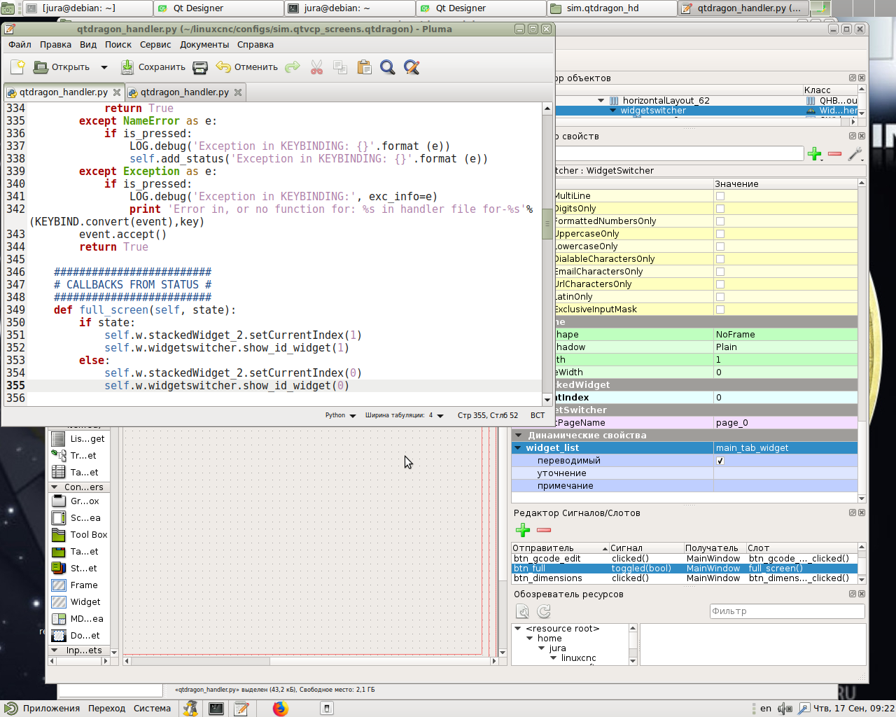

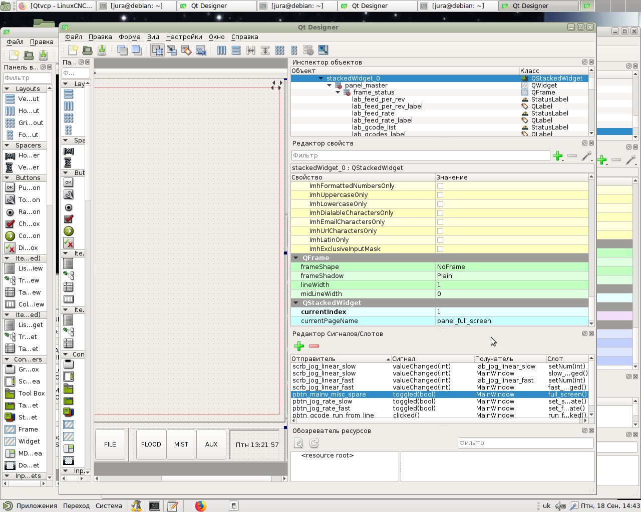

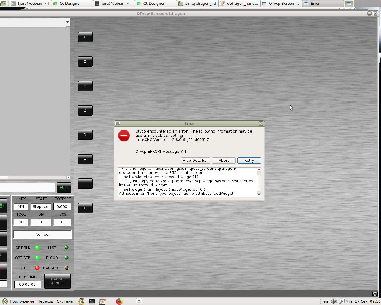

It seems like a simple task but I can't do it. I decided to add Fullscreen in QtDragon. Please tell me what I'm doing wrong? As a sample I took from x1mill.
- Posts: 7368
- Thank you received: 2182
18 Sep 2020 00:19 #182609
Replied by cmorley on topic Сustomization QTvcp
Seems the error indicates there is a layout missing.
The widget that gets moved must be in a layout in the original position.
The layout is a placeholder so the moved widget can go back in the same place.
- hottabich
- Posts: 574
- Thank you received: 96
18 Sep 2020 07:19 - 18 Sep 2020 12:36 #182638
by hottabich

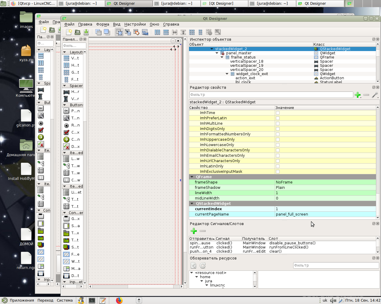

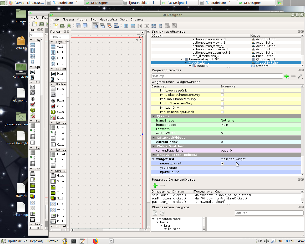

Thanks for your attention! As I understand it, you need to correctly specify the path gcode_graphics in widgetswitcher (widget_list). I do everything the same way with x1mill. But it doesn't work. Here is the code in the handler: x1millor qtdragonplus sceenshot. Probably wrong with the panels, I'll figure it out. So it happened, made a hybrid x1mill + qtdragon, fixed it.

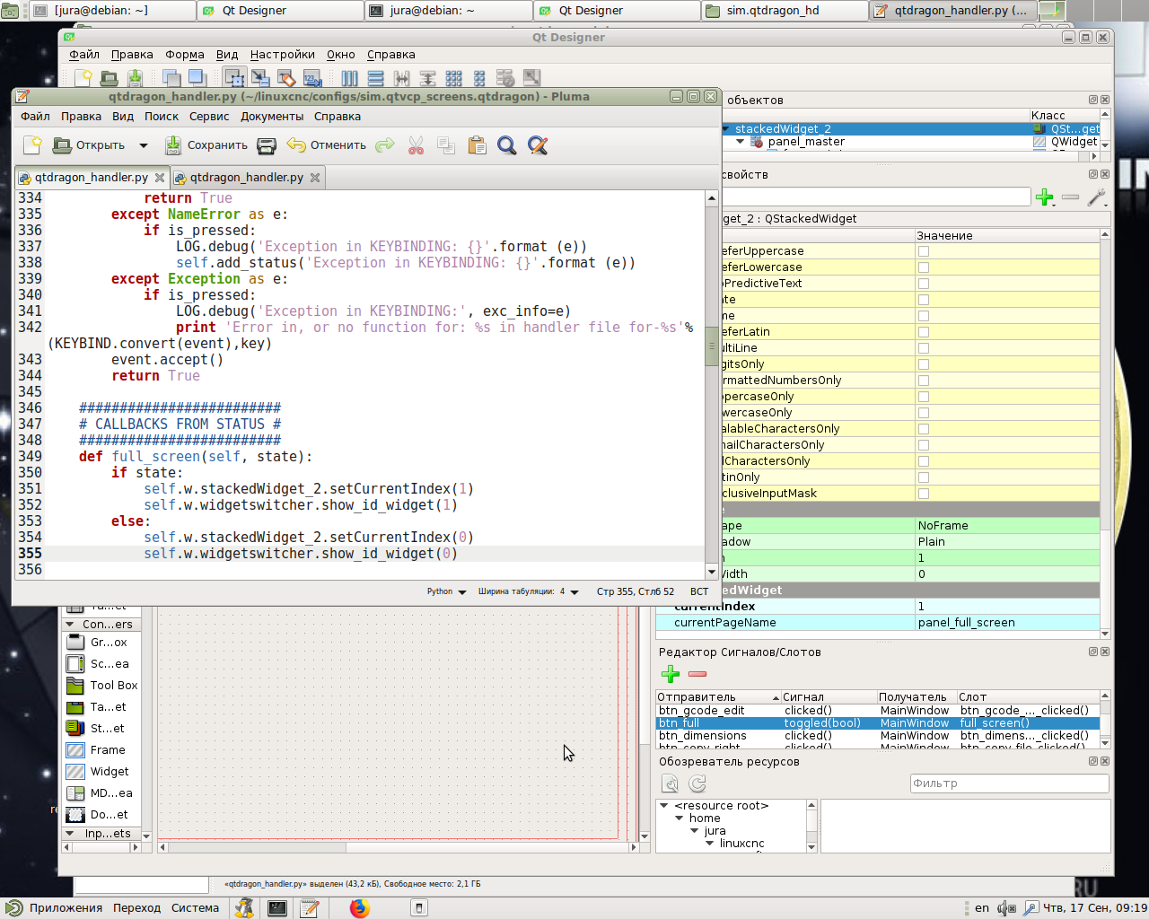

def full_screen(self, state):
if state:
self.w.stackedWidget_0.setCurrentIndex(1)
self.w.widgetswitcher.show_id_widget(1)
else:
self.w.stackedWidget_0.setCurrentIndex(0)
self.w.widgetswitcher.show_id_widget(0)def full_screen(self, state):
if state:
self.w.stackedWidget_2.setCurrentIndex(1)
else:
self.w.stackedWidget_2.setCurrentIndex(0)

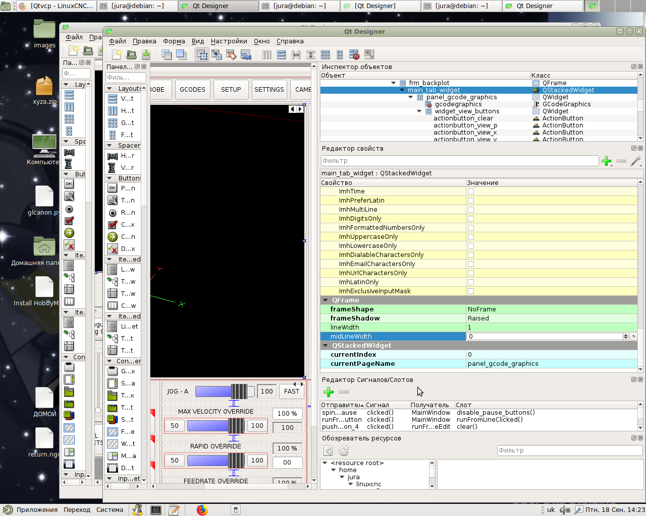

26 Sep 2020 03:52 #183807
by hottabich
Hello! Please help me make a full screen in QtDragon. I'm out of
variant. The brain boils with confusion. Thanks!

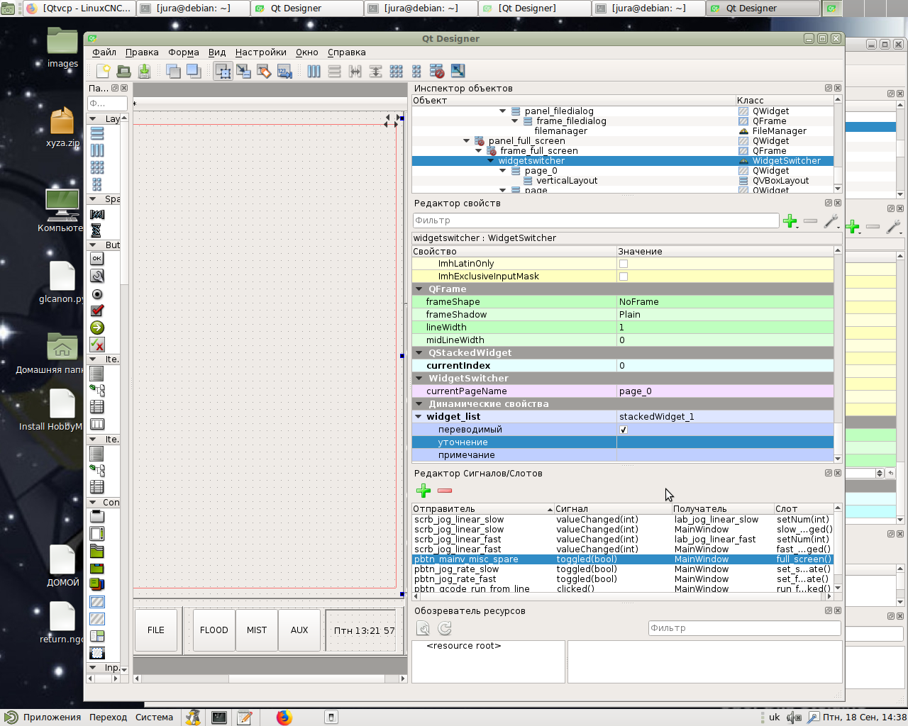

- Posts: 7368
26 Sep 2020 15:29 #183879
try this.
The problem was, the widgetswitcher pages did not have layouts set in them.
You can tell by the red circle-with-slash icon in the Object inspector list.
I set it up so any main tab can be 'full screen' rather then just the gcode graphics display.
You could change that if you don't like it.
Chris
Chris
