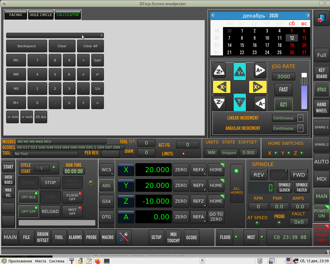

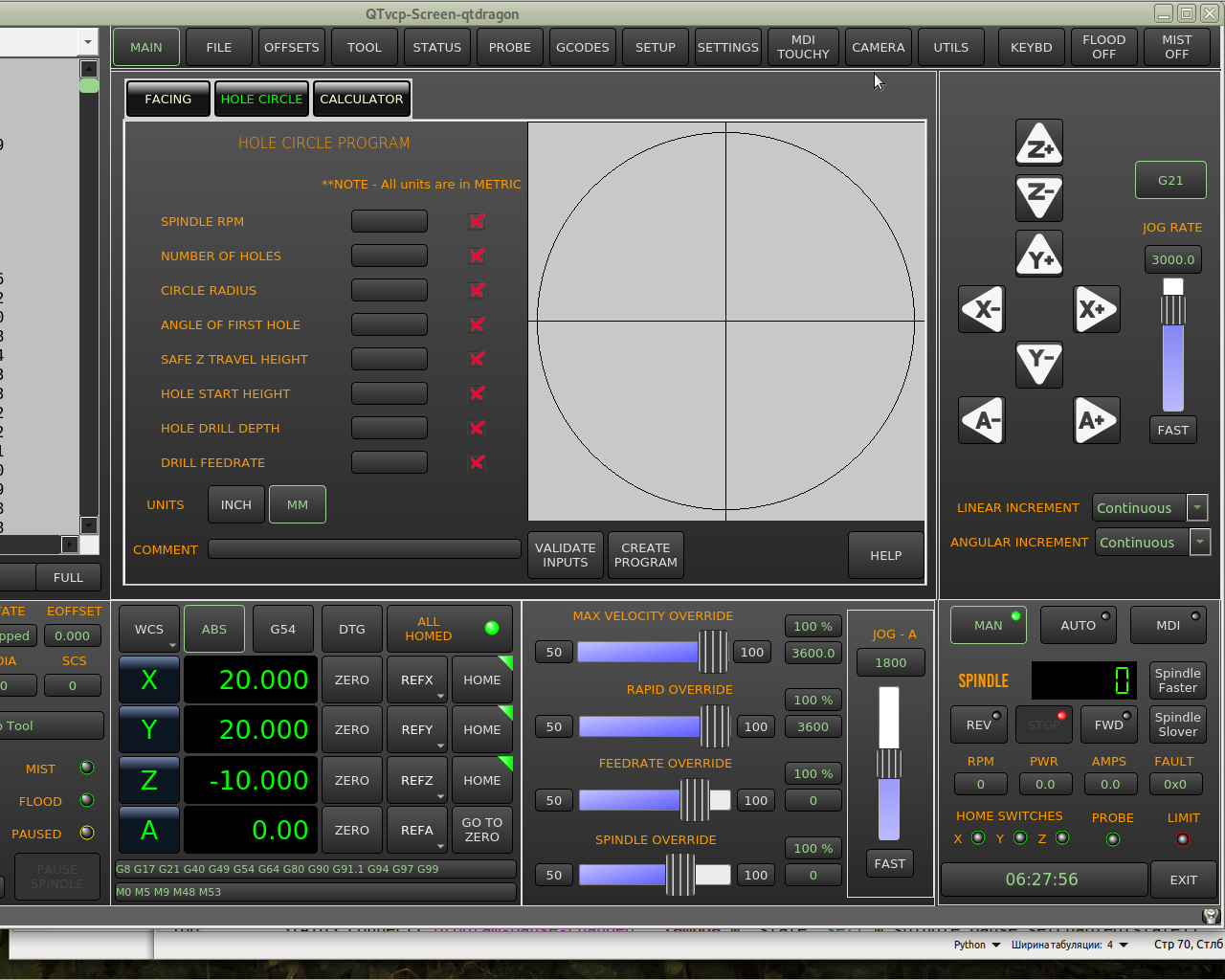

I am trying to add utilities from QtDrago-Master to QtDragon. Can you please tell me what I'm doing wrong?

Sorry, sorry. Utility widgets are not displayed, I did everything as in QtDragon-master. Here is a handler from it.

10 Dec 2020 04:24 #191554
Replied by cmorley on topic Сustomization QTvcp
Those utilities are not in master - they look like they came from Jim's github.
The possible problems of display are many.
You need to learn to trouble shoot more.
Things to check:
Is the ui file of the utility being found?
is the utility widget ever set to be shown or is it hidden?
is the function to install the utilities ever called?
If there is a difference between 2.8 and master try to pin point what the difference is.
try adding a pyqt widget instead of the utility widget; to try to see if it's the utility widget that has a problem or it's the code loading it.
etc.
I can help, if you narrow it down to a particular code or widget.
Chris

10 Dec 2020 04:38 #191560
by hottabich
Replied by hottabich on topic Сustomization QTvcp

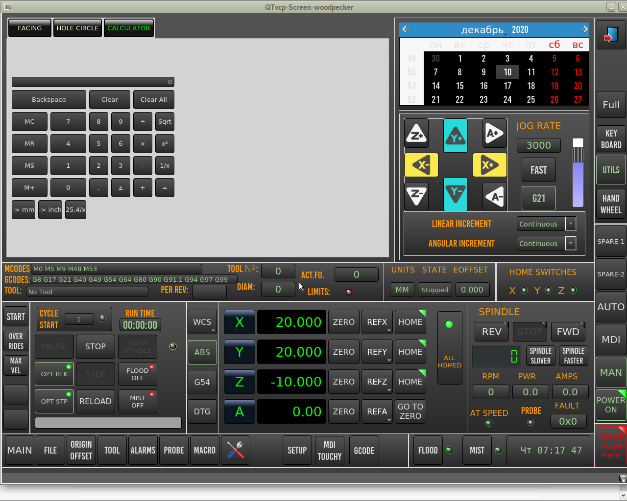

I am sorry for disturbing you. The question has just been closed. Not mindfulness. Evenings are smarter morning.
Missed self.init_utils () I'm sorry.

10 Dec 2020 04:45 #191561
Oh great - I'm glad you figure it out!
I've certainly had mornings like that.
I don't mind helping - I just need details of the problem to focus my investigation.
I am curious about the calculator - qtvcp already has a calculator widget - what's different?

An ordinary calculator, but I made your revision with qtvp converter.

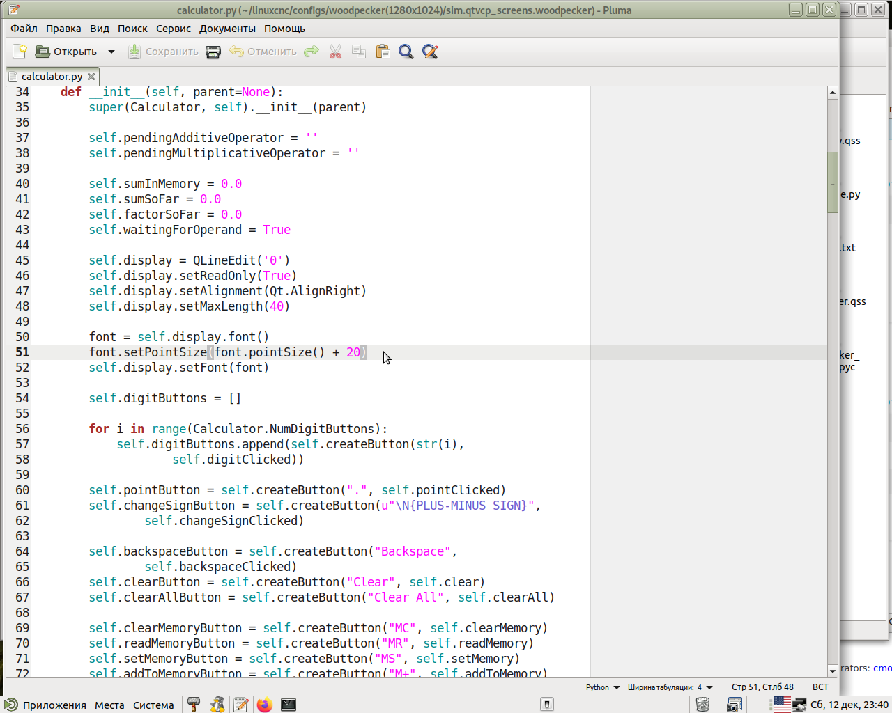

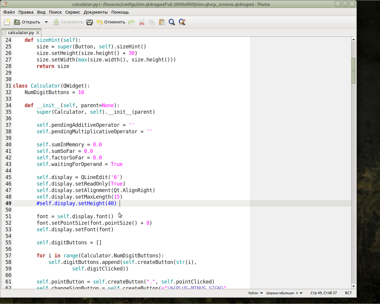

Please tell me how to change the display height , py-code in the previous post.
- Posts: 7368
- Thank you received: 2181
12 Dec 2020 19:27 #191769
Slightly bigger display font:
font.setPointSize(font.pointSize() + 12)Please Log in or Create an account to join the conversation.

12 Dec 2020 21:45 #191782
by hottabich
Thanks, but the display = QLineEdit height hasn't changed.Slightly bigger display font:
