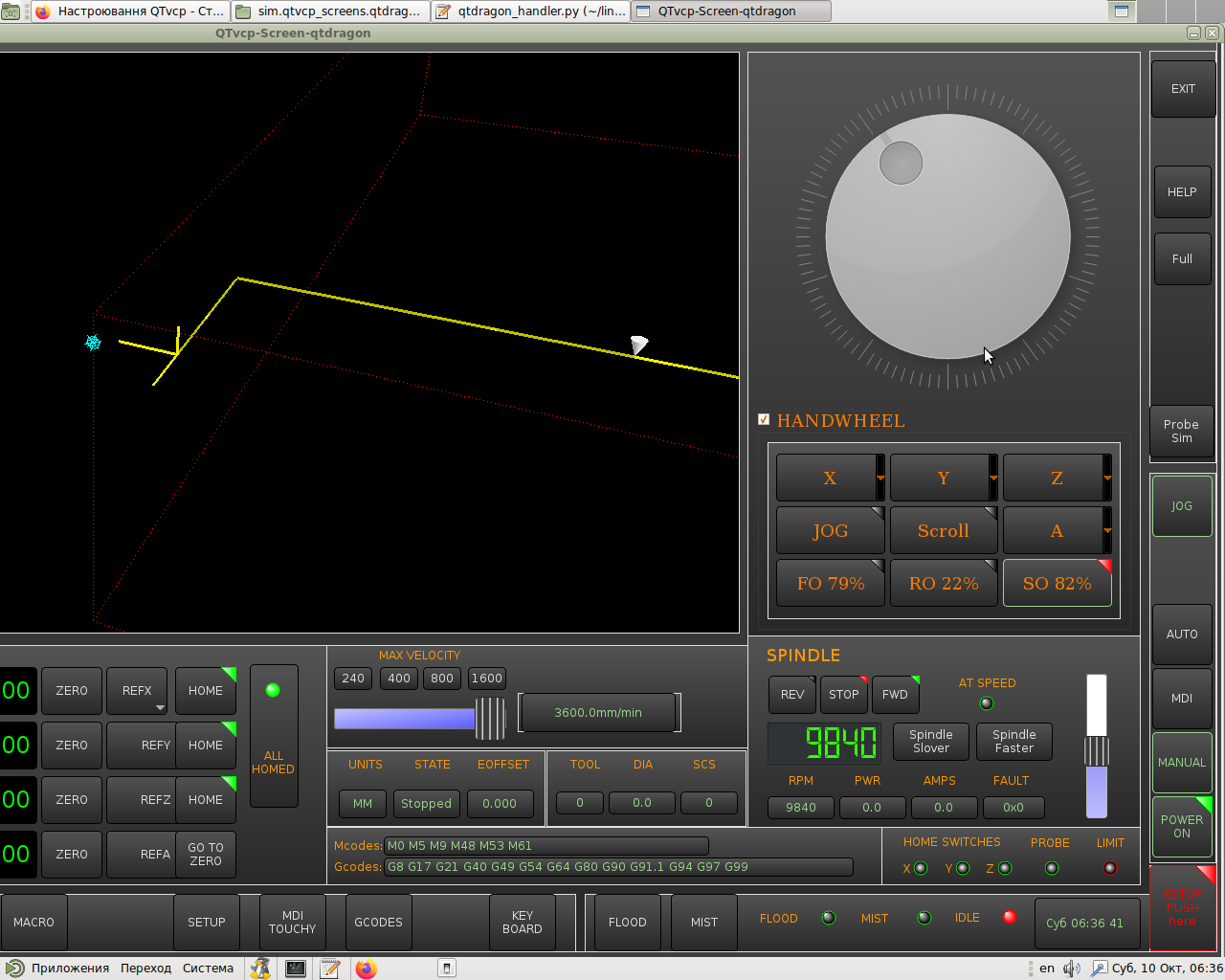

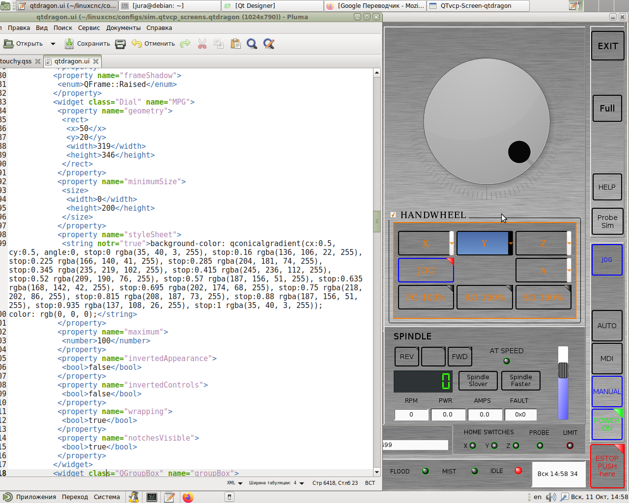

Hello! Please tell me how to change the color of the marks around the wheel in MPG Dial. Thanks!

Replied by cmorley on topic Сustomization QTvcp
A quick Goggle doesn't show much for options:
stackoverflow.com/questions/20952226/cus...dial-with-stylesheet

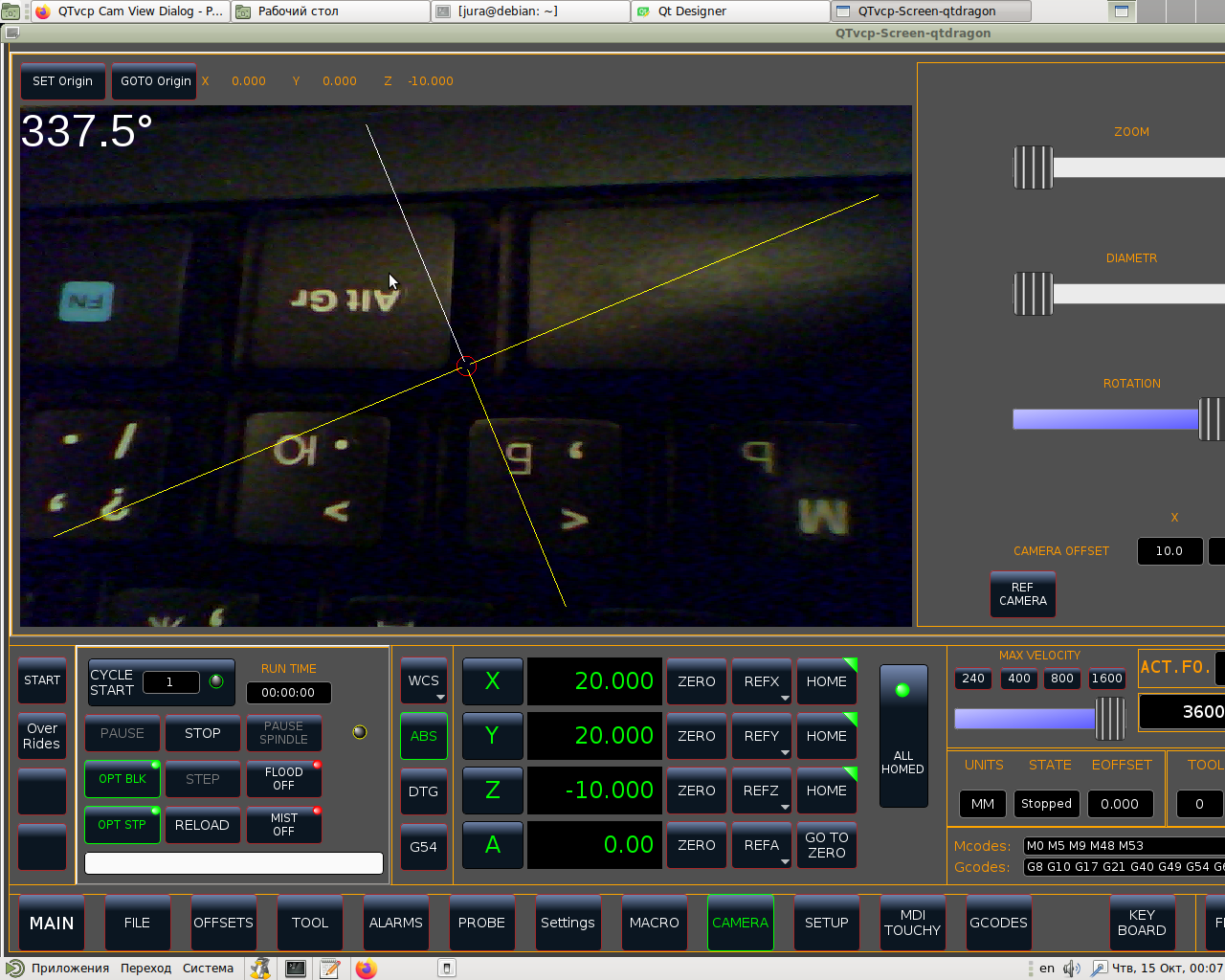

Chris hello! Please tell me how to integrate cam_align_handler.py in QtDragon in order to abandon probe_basic. Or maybe an addition to the distribution is planned? Made by:also addedif I add cam_align_handler.py with replacement from under root, camviewdoes not work. By default as in the screenshot.Where can I get the UI File for this handler?

Usually you could embed camview into the screen but I dont beleive qtdragon allows embedding other programs.
So you could just add the camview to qtdragon.
This is similar to the jog wheel. You must add the widgets to the screen and integrate the camview handler's functions into dragon's handler file.

Can't add new functions here / usr / share / qtvcp / panels / cam_align? Or place the UI and Handler files in your config and add them there. Not? Thanks!
Sorry i not sure what you are asking.
cam_align can be modified just like screens.
I you have cam_align.ui or cam_align_handler.py in you config folder, then qtvcp will use them instead of the builtin in ones.
Chris

17 Oct 2020 02:10 #186343
by hottabich
Replied by hottabich on topic Сustomization QTvcp
Thanks for the clarification. That's what I asked you about.
