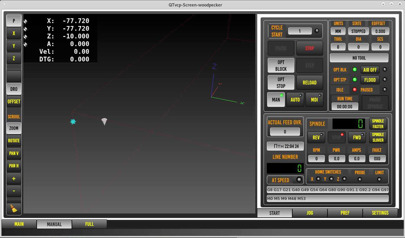

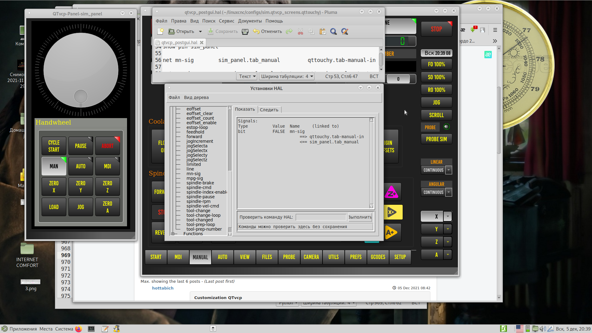

Please tell me how to switch the mainTabWidgets page to qttouchy using PushButton on sim_panel. Thanks!
- Posts: 7368
- Thank you received: 2182
04 Dec 2021 16:08 #228365
Replied by cmorley on topic Сustomization QTvcp
I can think of two options.
adding HAL pins to each.
or using ZMQ messaging between them.
- hottabich
- Posts: 574
- Thank you received: 96
05 Dec 2021 02:42 - 10 Dec 2021 11:12 #228376
by hottabich
Replied by hottabich on topic Сustomization QTvcp
ZMQ is difficult for me. With hal pin everything works. The following have been added to the handler:And in general functions.
Thanks![justify]
[/justify]
self.pin_tab_manual_in = self.hal.newpin('tab-manual-in',hal.HAL_BIT, hal.HAL_IN) self.pin_tab_manual_in.value_changed.connect(lambda s: self.tabManual(s))def tabManual(self, state):
print state, self.current_mode
if state:
tab = self.w.mainTab.setCurrentIndex(TAB_Manual)Thanks![justify]
[/justify]

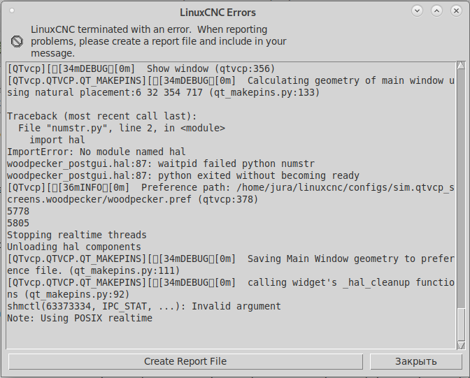

The numstr.py on linuxcnc 2.8.2 file works well. On linuxcnc 2.9.0 pre. error. Please tell me how to fix this, if possible. Thanks!
Last edit: 12 Dec 2021 02:47 by hottabich.
- Posts: 7368
10 Dec 2021 12:55 #228796
How are you loading the program?
It's being loaded with ython2 rather then python3
- hottabich
- Posts: 574
10 Dec 2021 14:05 #228801
by hottabich
Yes, it works for Python 2.7. I am trying to adapt woodpecker from python 2.7 to python 3 in linuxcnc 2.9.
- Posts: 7368
10 Dec 2021 15:11 #228818
Yes I understand.
How are you loading the numstr component in your HAL file?

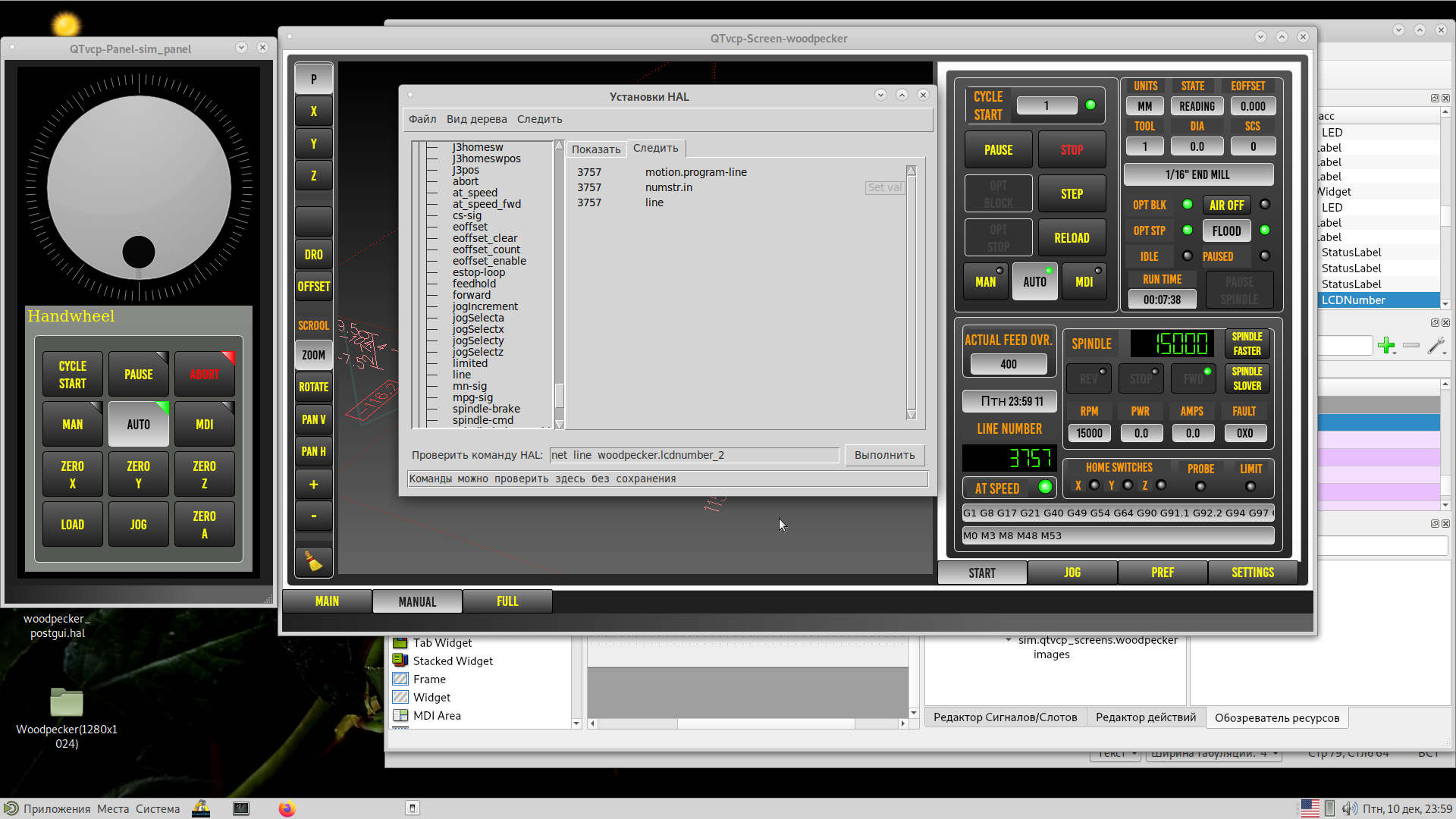

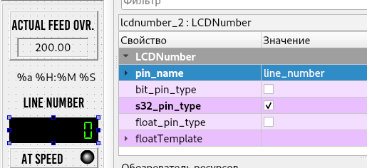

- hottabich
- Posts: 574
10 Dec 2021 15:24 - 10 Dec 2021 16:03 #228821
by hottabich
loadusr -Wn numstr python numstr.py
net line motion.program-line => numstr.in => woodpecker.line_number
And it is necessary
loadusr -Wn numstr python3 numstr.py
Not enough now
I will think. Thank you very much!
Everything worked out. Thanks again!
And it is necessary
Not enough now
net line => woodpecker.lcdnumber_2
Last edit: 10 Dec 2021 16:03 by hottabich.
