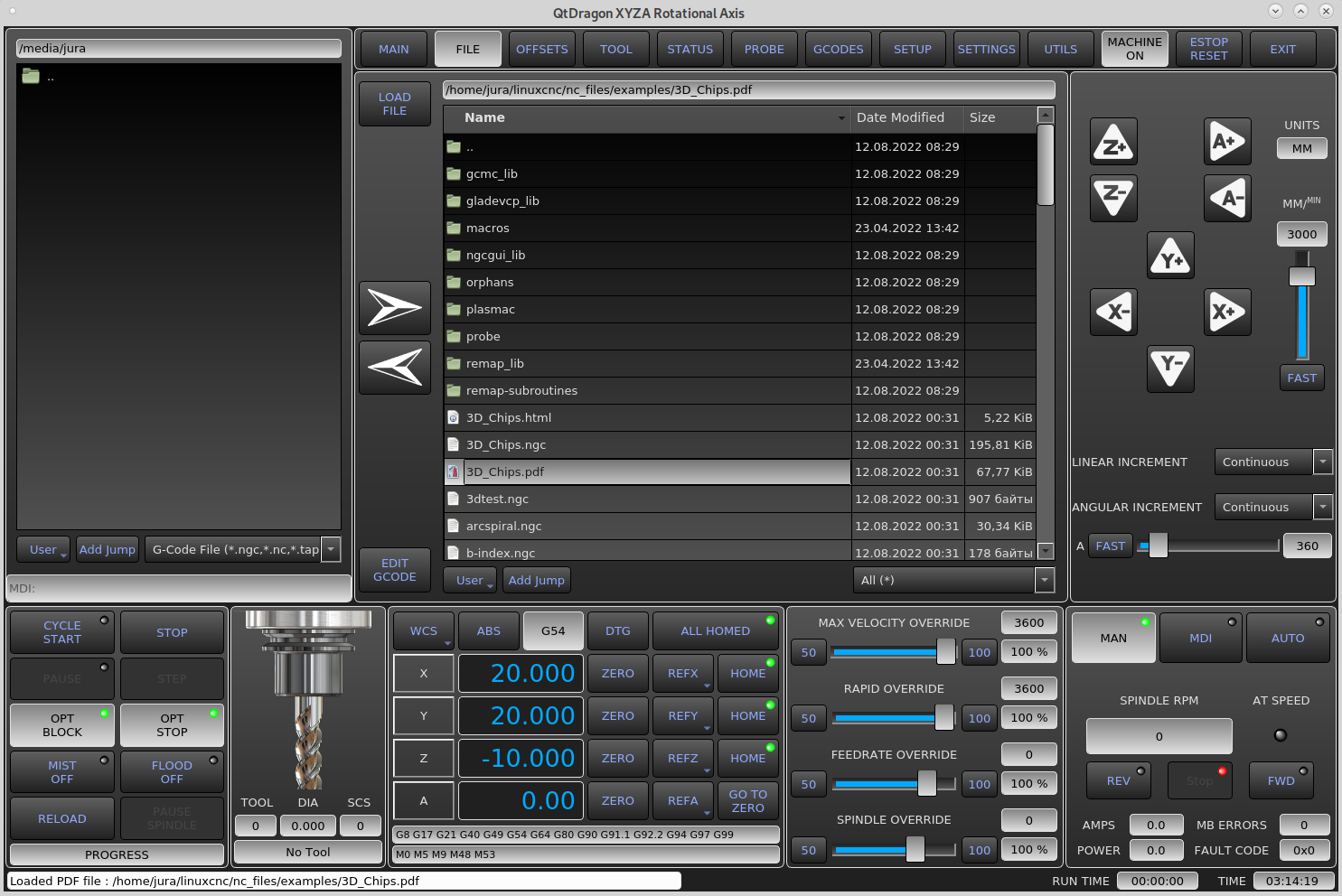

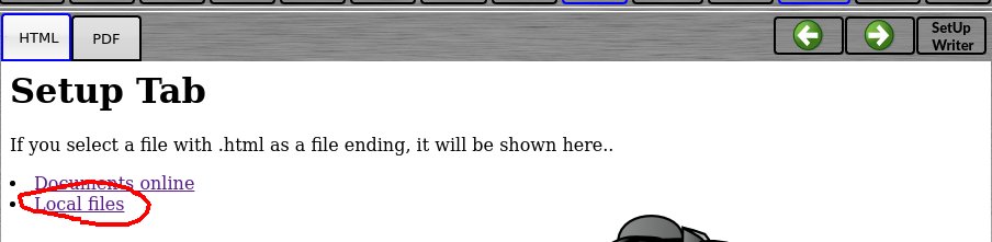

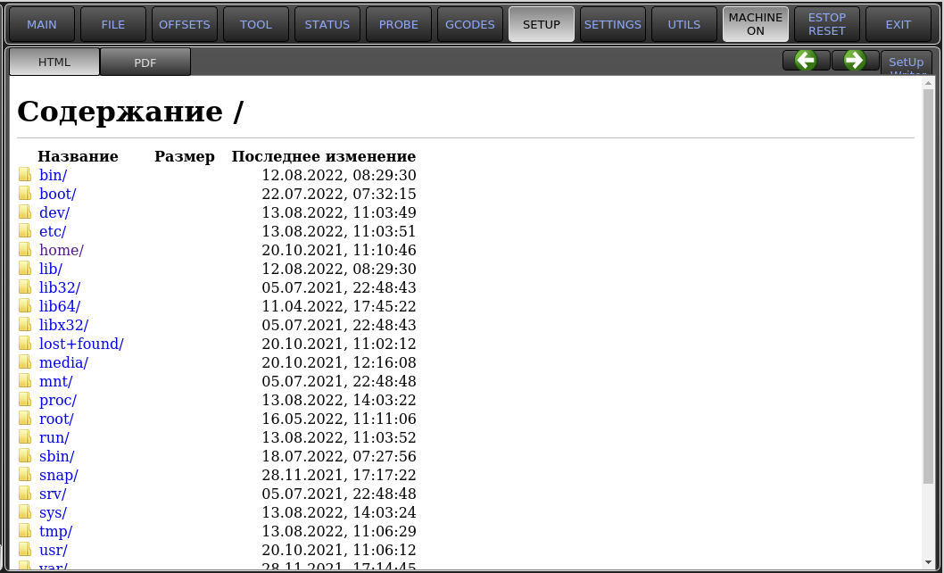

"Fast / slow" switch problem fixed, sent updated .ui file
After pressing the link "local files" are computer files displayed to you?

13 Aug 2022 08:14 #249632
by hottabich
Replied by hottabich on topic Error in tool_offsetview.py
Yes. After pressing the link "local files" are computer files displayed.

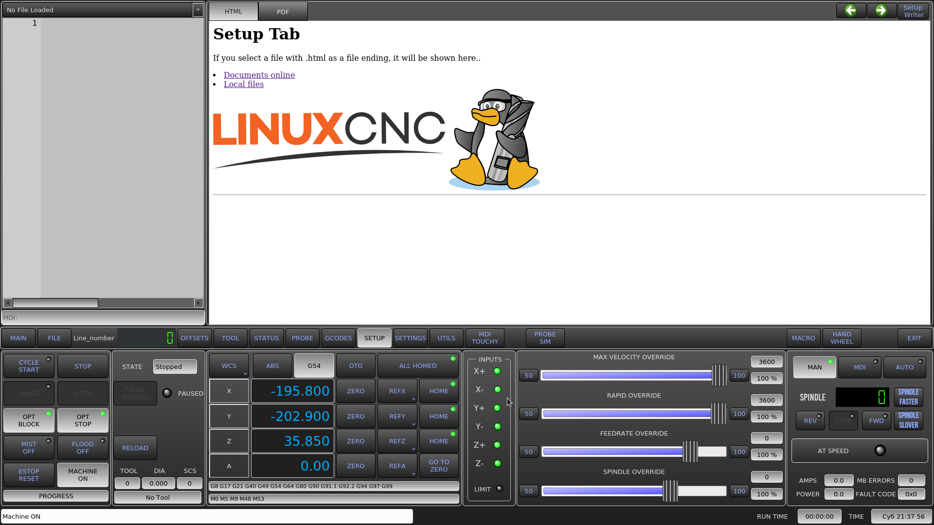

hi Chris
I see that you changed the ui file, but I think something went wrong, because after the update there are no changes, the "fast/slow" switch does not work.
In the handler file, the sizes of the buttons from the setup tab are changed
Marek

13 Aug 2022 12:50 #249648
Replied by cmorley on topic Error in tool_offsetview.py
MarcoPolo
Fast/slow works for me now.
I didn't have time to see what you changed on the buttons yet.

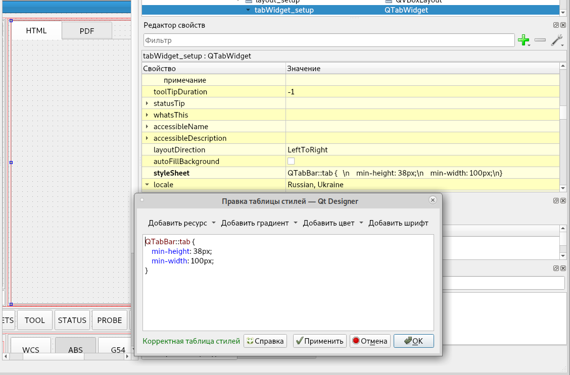

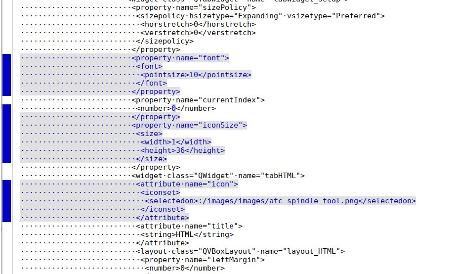

I did the upgrade again and "fast / slow" works.
This code below would also need to be included in the ui file to make a little more vertical space for the buttons in the "setup" tab.
I added an icon to the html tab with the size of 1x36 and the space has increased, not very elegant but I have no idea how to do it otherwise.

13 Aug 2022 18:39 #249666
by hottabich
Try like this.

13 Aug 2022 19:26 #249672
by MarkoPolo
Replied by MarkoPolo on topic Error in tool_offsetview.py
yes, this can be adjusted in the style file, but it has to work for any style at once, also without any style

14 Aug 2022 04:37 #249696
by hottabich
Do it and always will.

14 Aug 2022 12:53 #249713
by MarkoPolo
yes, this is how it works properly. thanks.
I am sending both corrected files.
