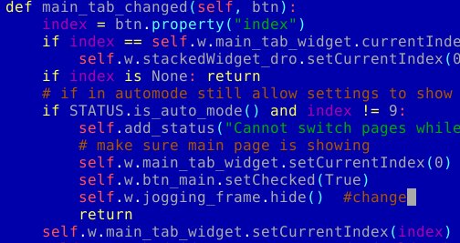

I have a corrected qtdragon.ui. The sliders from the camera did not fit into a small size and some other adjustments for a better fit of the layout.
Two suggestions. During work, after entering the "settings" tab, the manual movements panel is shown, but after exiting, this panel does not hide. It proposes one entry just like in the screenshot.
Buttons with macros could also be hidden when working in auto mode.

pushed. Also added color status messages as I described. let me know if you like it.

Great, I like it very much, that's what it was about.
I only changed the colors, warning to yellow, critical to orange.
I have given hiding macro buttons in run mode.
There was a problem with the message if machine not home, there was only a popup, also there was a problem if the program was loaded from tool, after startup neither action nor message was there, so I added 2 conditions to the btn_start_clicked function.
Works flawlessly now.
