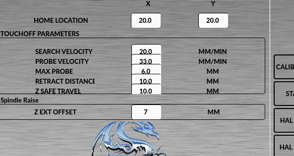

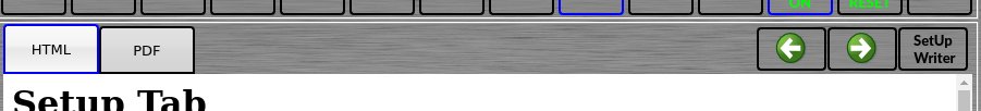

I'm sending corrections to the buttons from the setup tab and value fields from the settings tab because they don't look very good

I will have to hold off just a bit, I have an update coming out that would negate this.

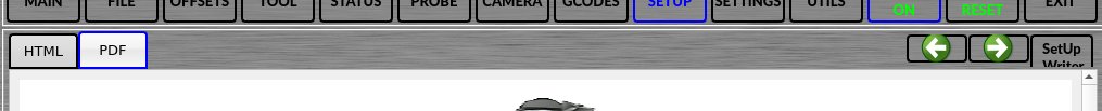

27 Sep 2022 17:23 #252870
by MarkoPolo
Replied by MarkoPolo on topic Error in tool_offsetview.py

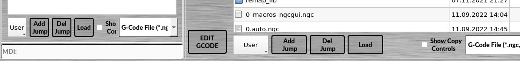

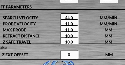

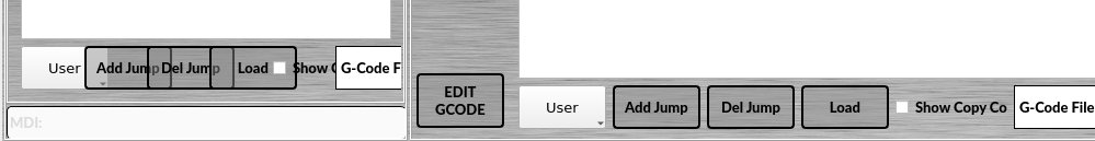

Hi Chris
I made some fixes due to some elements not matching correctly.
Could you see?
Some screenshots to better illustrate what the changes are about.
Could you see?
- Posts: 7368
- Thank you received: 2181
28 Sep 2022 03:10 #252906
Replied by cmorley on topic Error in tool_offsetview.py
Thank you - pushed to master.

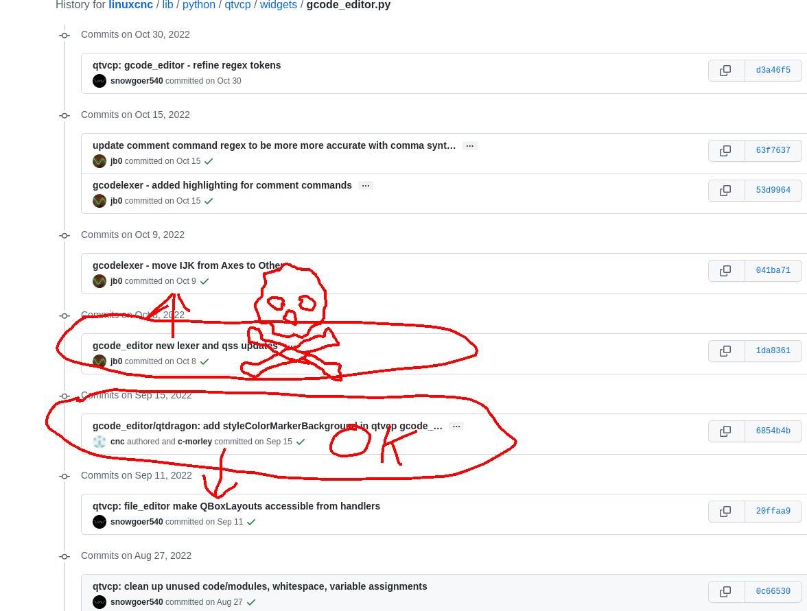

27 Nov 2022 15:00 #257738
by MarkoPolo
- Posts: 7368
28 Nov 2022 06:32 #257821

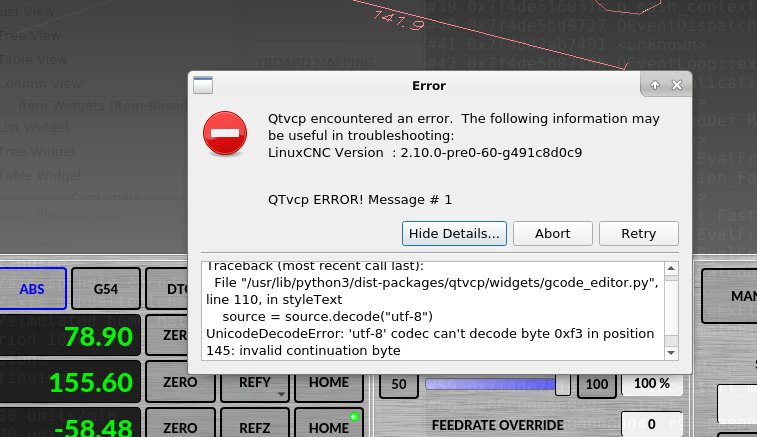

hmm I don't get this error with your test program.
Can you tell me what python version you are using?
(open a terminal type: python3)

I am using version Python 3.7.3

29 Nov 2022 18:06 #258004
by MarkoPolo
- Posts: 7368
30 Nov 2022 01:40 #258070
Yes I was hoping it was related to python version. I test with a newer version then you.
3.8.10.
I'm still not sure why you have a problem but I do not.
3.8.10.
- Posts: 7368
30 Nov 2022 07:00 #258096
could you try changing the line 110 to :
source = source.decode("utf-8", "ignore")
see if that helps?
see if that helps?
