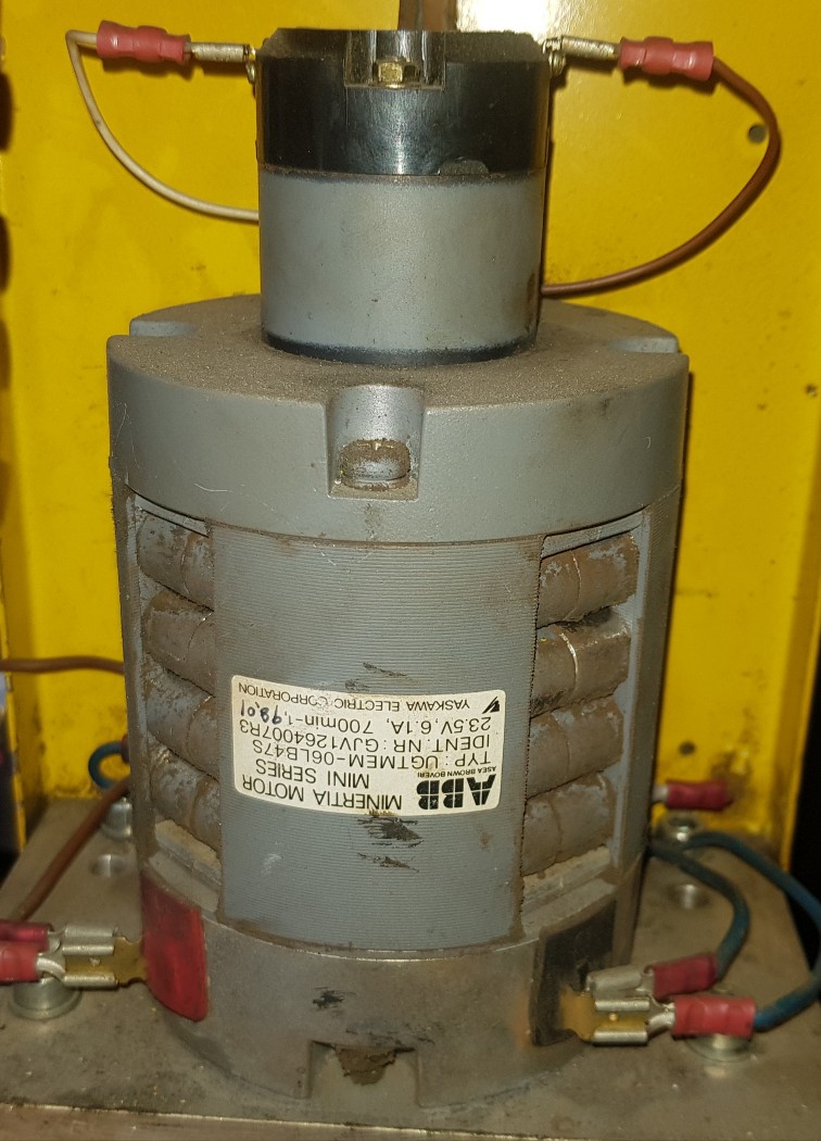

09 Feb 2020 14:45 #156906
by alexandrub
I agree this, i can adapt an encoder but where to find an analogic servo driver? I suposse i cant find a new one on the market. If i wrong, please give me an advice.
I attach a picture with the motor .
Replied by alexandrub on topic ESAB Ultrarex UXD-P 2500 retrofit with Linuxcnc and Proma THC
As Rod said, you can add an encoder to the existing DC motor and use a servo drive for Z axis.

10 Feb 2020 11:39 #156978
Replied by Todd Zuercher on topic ESAB Ultrarex UXD-P 2500 retrofit with Linuxcnc and Proma THC
A servo drive (or amp) for an ordinary brushed DC motor isn't difficult to find new replacements for. (And inexpensive used ones are plentiful as well.) Figuring out which one is appropriate for your motor's specs is the toughest part.

10 Feb 2020 12:07 #156980
Replied by tommylight on topic ESAB Ultrarex UXD-P 2500 retrofit with Linuxcnc and Proma THC
The machine has a drive for that motor that you can use, it is located in a metal box behind the Z axis metal box, with plenty of other electronics inside, so you will have to find the drive, find the control inputs for it, wire a shielded cable from that input to the Mesa 7i77. Also wire the new encoder that you can mount to the side tacho or above it, also to the 7i77 encoder inputs.
Make sure you check the schematics for the drive to see if it uses +-10V or +5V and dir pins.
The THC is controlled through an RS232 originally, so i did not bother with it, just wired a drive to a stepper motor that i put on top of the existing motor after removing the tacho and using a coupling.

10 Feb 2020 23:01 - 10 Feb 2020 23:02 #157012
by alexandrub
Instead of encoder, can i use just the mesa or proma thc as ecoder? I touch of the metal sheet, lift up the torch a time...20ms for example and then start the cutting with thc control.

10 Feb 2020 23:27 #157019
I wondered about that too. Its just the initial touch off that needs accuracy. Once you are cutting you could use a PID to manage the PWM signals with arc voltage as the feedback signal I'm sure. Its possible you could monitor the tacho until it stalls to set the material height. I did skim the manual for the motor and I think the tacho just outputs a DC voltage based on the speed. You may be able to use a 7i76e which has some analog voltage inputs to measure this voltage but it might need amplifying to get a good full scale reading.
Replied by rodw on topic ESAB Ultrarex UXD-P 2500 retrofit with Linuxcnc and Proma THC

10 Feb 2020 23:30 #157020
Actually, you might be better off monitoring the Tacho with a THCAD if you have enough encoder inputs. It would be much more precise with the voltage measurements....

11 Feb 2020 04:13 #157037
Warning, tacho outputs positive and negative voltage, so wiring it to Mesa inputs will result in damage to inputs.
Velocity mode servo can not be used without feedback for precise control.
It can be used for THC positioning but it requires using AD converters complicating things a lot.
The cheapest solution in this case is using an encoder, even one with very low count works as the motor is geared.
The easiest solution is to add a stepper motor and drive.
