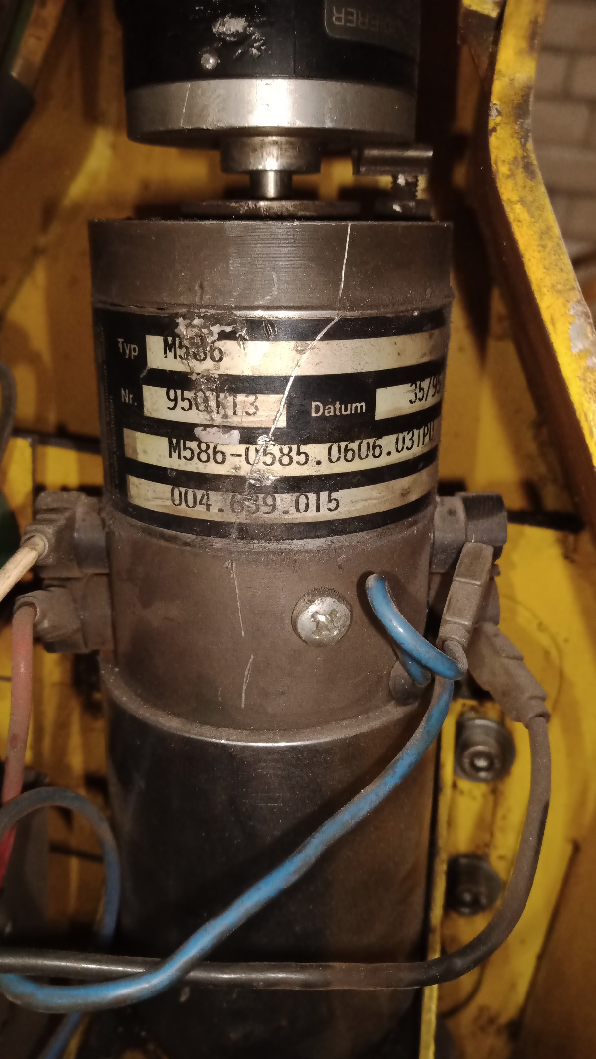

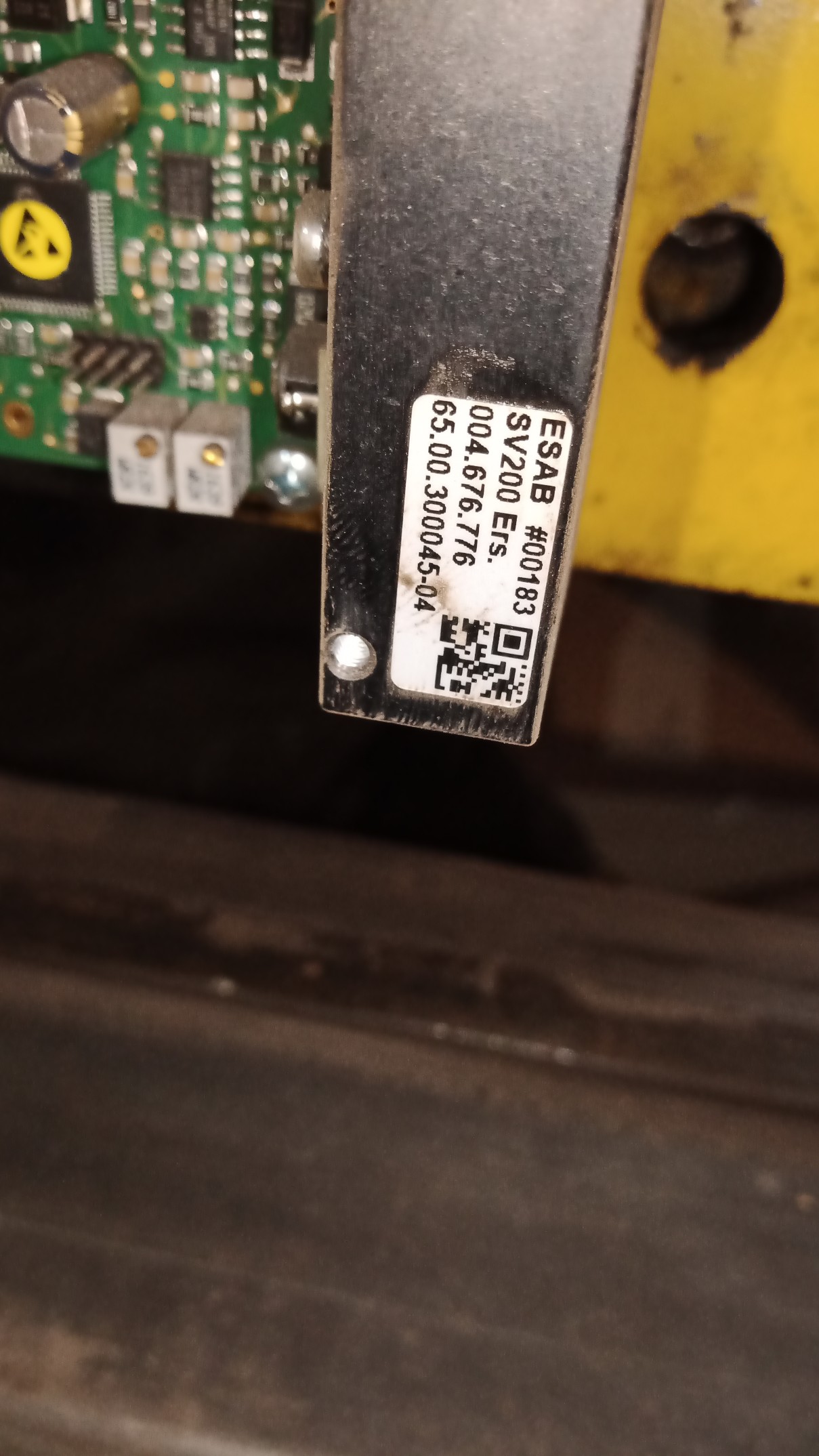

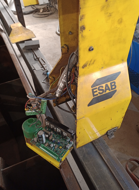

- Uzikas
- Posts: 6
21 May 2020 04:28 - 21 May 2020 04:31 #168466
by Uzikas
Replied by Uzikas on topic ESAB Ultrarex UXD-P 2500 retrofit with Linuxcnc and Proma THC
Last edit: 21 May 2020 04:31 by Uzikas.
- Posts: 21990
- Thank you received: 7487
21 May 2020 07:55 #168472
Replied by tommylight on topic ESAB Ultrarex UXD-P 2500 retrofit with Linuxcnc and Proma THC
Is that the one that moves the gantry (Y axis) or the one that moves the Z axis (X axis) ?
- Uzikas
- Posts: 6
23 May 2020 07:39 #168654
by Uzikas
X axis. There are two motors. X1 and X2. X1 motor already fine, but how to synchronise X2 motor...it's on the same axis, but diferent rail. This one have reductor 1:15.
