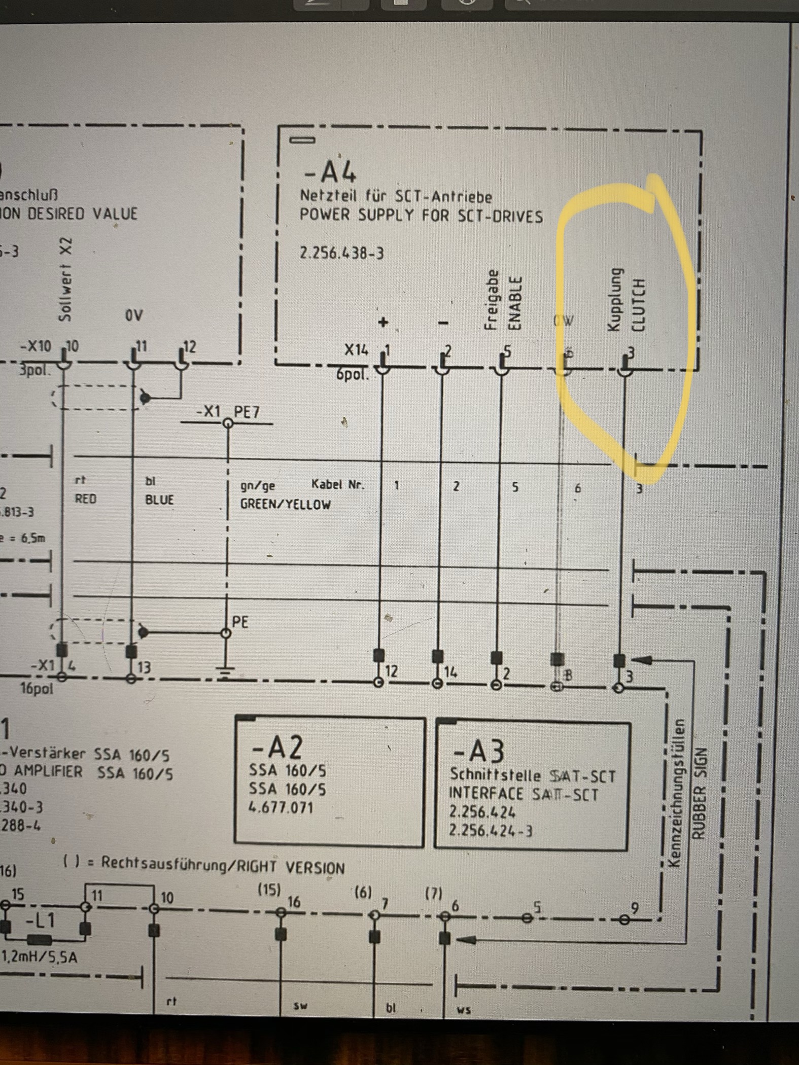

Any ideea about this motor ? Do you thing it has clutch? I suppose upper part is encoder, moddle part is the motor but the lower part?
The gearbox is under all and is big.

Replied by tommylight on topic ESAB Ultrarex UXD-P 2500 retrofit with Linuxcnc and Proma THC
There should be no clutch, mine did not have.
They tend to have brakes, not clutches, so give it a push, if it moves it does not have a brake.
The part between the encoder and motor is the tacho generator, it sends feedback to the drive to close the velocity loop. The encoder goes to the controller to close the position loop.

Replied by alex.statie on topic ESAB Ultrarex UXD-P 2500 retrofit with Linuxcnc and Proma THC
Thank you for the clarification!
What got us worried was the part highlighted in yellow from the manual.
It seems to have no effect if connected or not...
