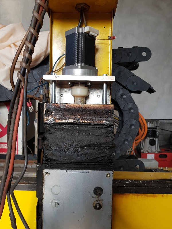

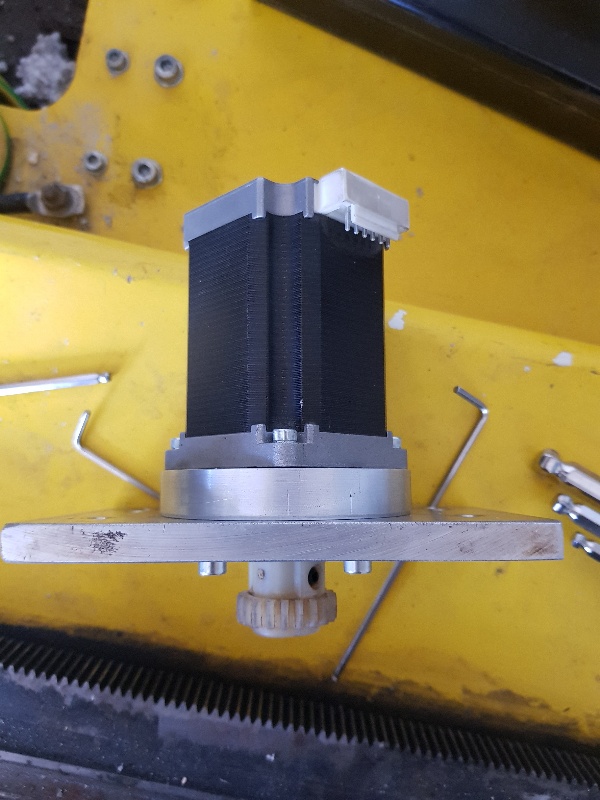

by alexandrub
Replied by alexandrub on topic ESAB Ultrarex UXD-P 2500 retrofit with Linuxcnc and Proma THC
Ok, i agree the easy solution. I work now to mount the stepper instead the dc motor. I want to buy a thc controler. What to chose? Proma or mesa? In my opinion proma seems to be more friendly but i dont know what to chose...THC150 or THC SD?

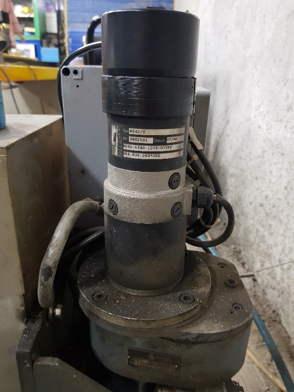

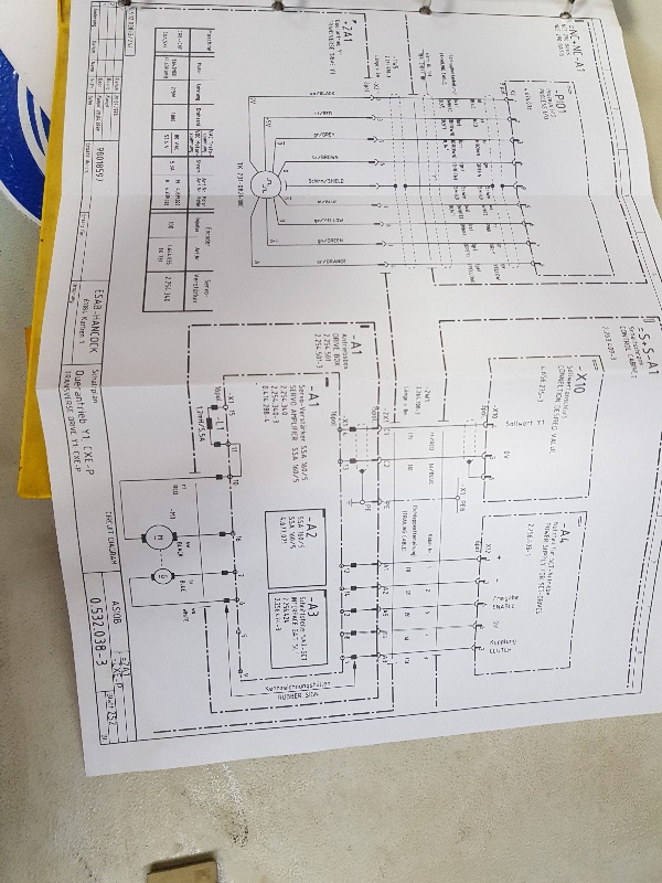

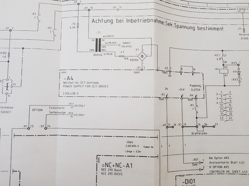

by alex.statie
Replied by alex.statie on topic ESAB Ultrarex UXD-P 2500 retrofit with Linuxcnc and Proma THC
A few questions on this machine:
1. What does the motor clutch do? It seems it has no effect whether it’s connected or not except a led/relay on the power distribution board.
Tommylight, did you leave the clutch unconnected in your build? I saw you did not mention it in the previous posts.
2. Is the Servo logic +-10v or rather +-5v? We’ve tested with +-5 to be on the safe side and the motors have an impressive speed.
3. How are you positioning the cutting head initially? Did you retrofit a microswitch or induction?
4. Are the endpoints achieved with the induction sensors present on the axis? We failed to find any microswitches.
Thanks in advance!!
Thanks in advance!!

Replied by tommylight on topic ESAB Ultrarex UXD-P 2500 retrofit with Linuxcnc and Proma THC
There is no clutch on the machine i retrofitted, so i do not know. Can you give us some info or pictures of it ?
Yes the servo is +-10V, but 5V will give you more than enough speed. At 10V it will do 28m/m and watching the gantry move at that speed is scary !
Yes i did make a torch holder with an induction switch for probing, it is also used to trigger the E-stop if the torch hits the material.
Yes, the induction switches are used for homing and limits. There is also a mechanical switch (a big microswitch) on the left under side of the gantry, it is used as extreme limit switch and it will cut the power to the motor drives if it is triggered. All machines that use DC brushed servo motors should have those on each axis to prevent runaway in case of drive failure .
