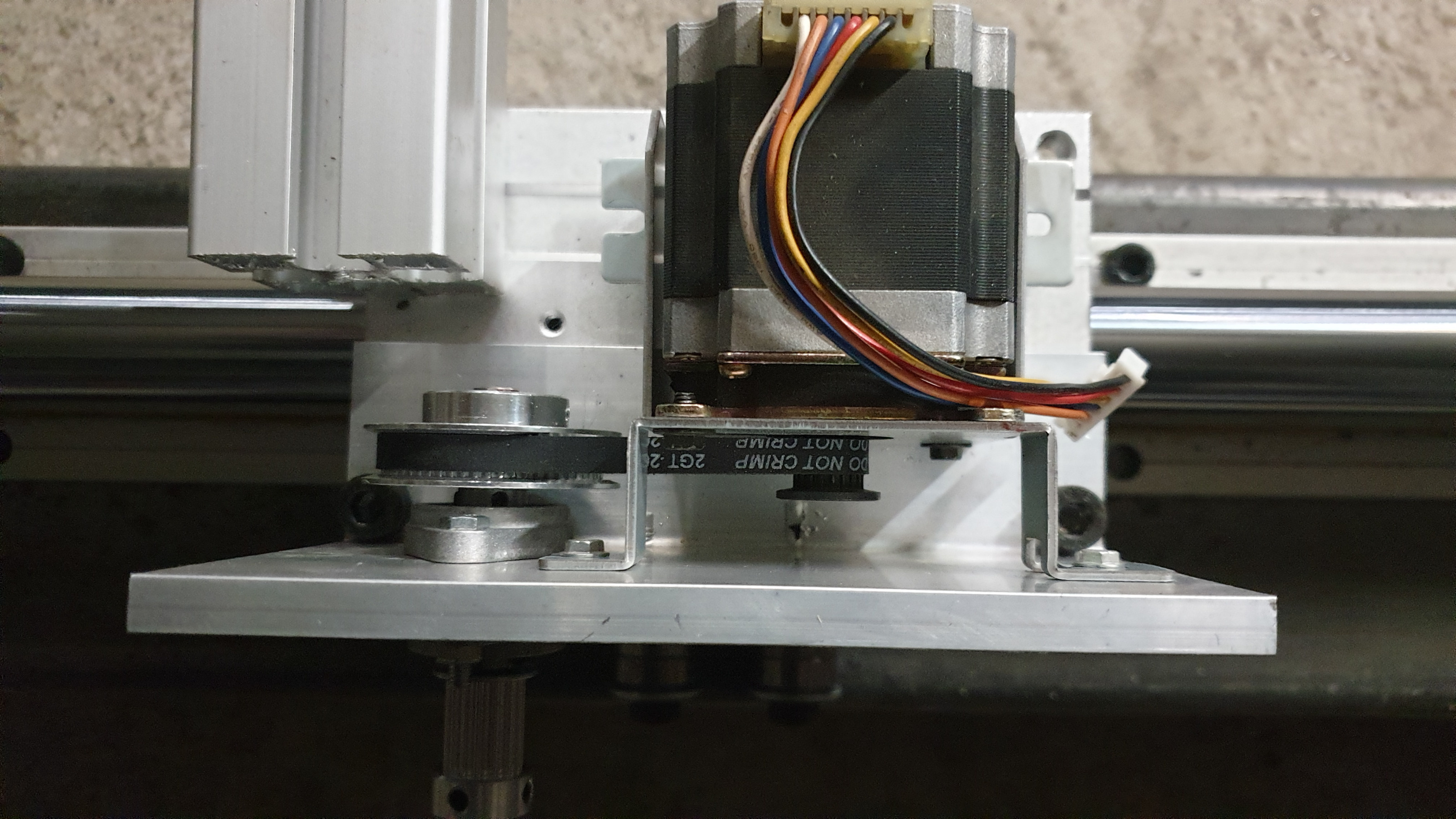

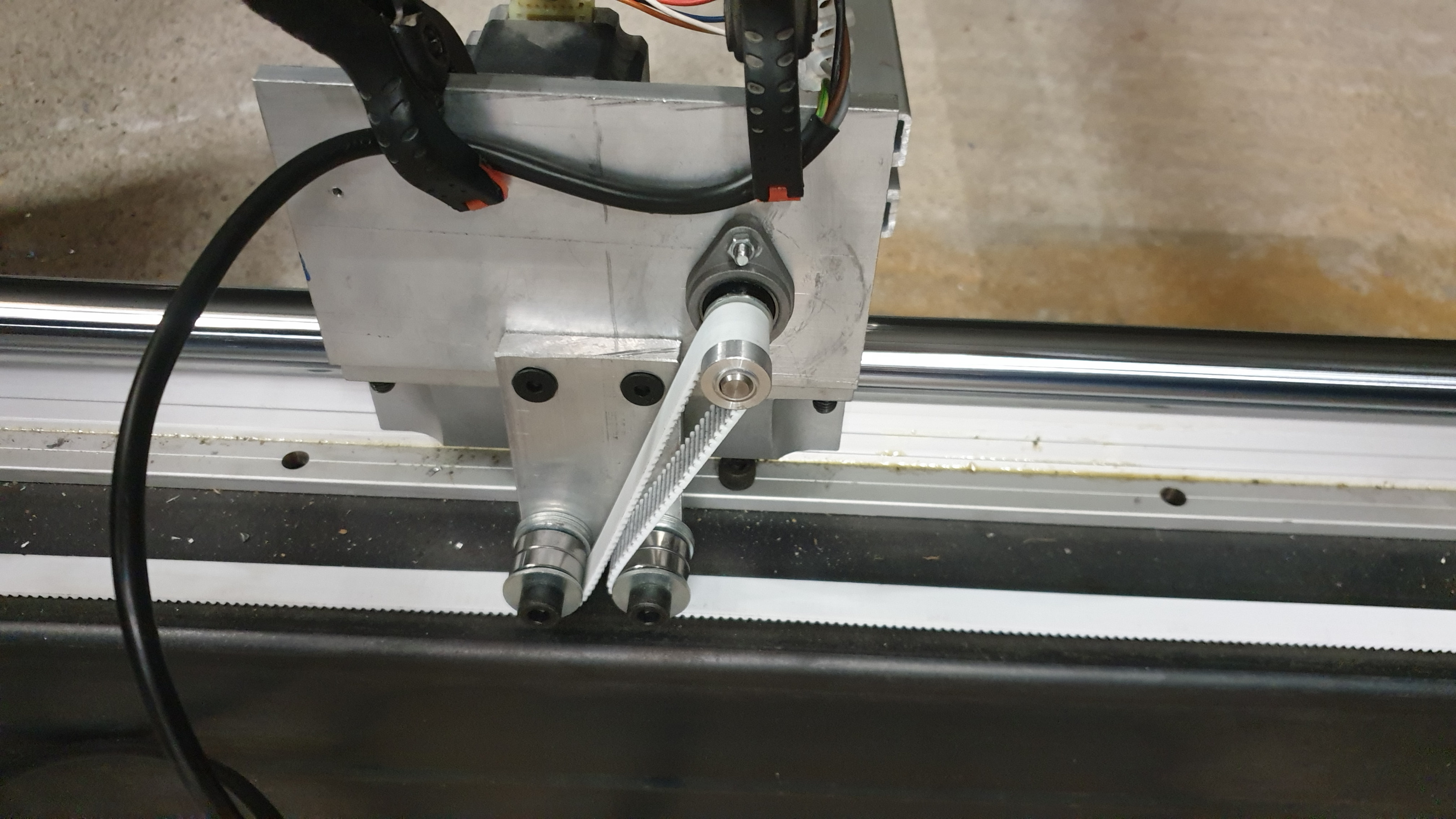

Finally got some small ALU parts to continue working on this.
Today i made two belt reductions for the smaller of the two machines, one on each side, so here are some pictures, and a video of it moving.
Warning : No jokes about the machine laying on it's back, it is upside down, with feet's up and everything.
Almost finished assembly of the reduction, will add a proximity sensor and tidy up the wiring. The white belt is 15mm wide and there will be one on each side, so way more than is needed for moving 30 to 40 KG around.
And here is the reduction from above, 1:3, GT2 belt.
And here is a video of it moving at 15meters per minute with some cheap drives. Tomorrow i might get the big Lam Technologie drives to see if i can bend something! The gantry is there just to keep the linear bearing from moving sideways.
Stay tuned.....
