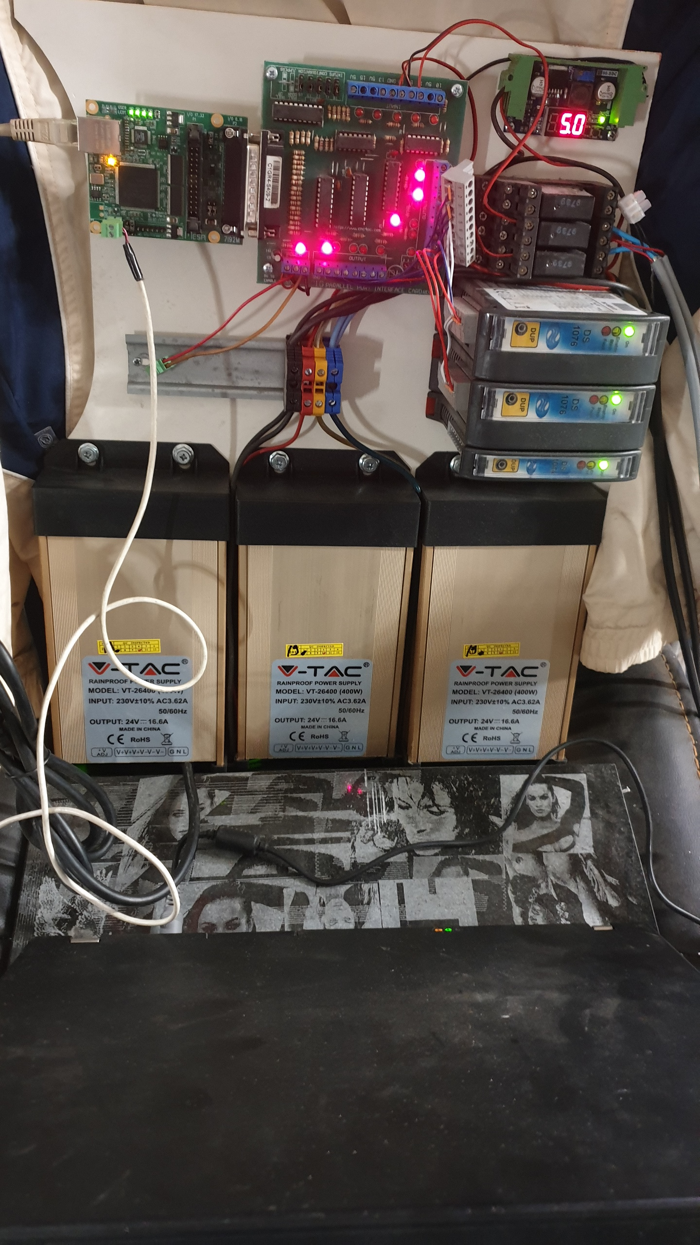

Awesome tommy. Can you share the lam technologies part numbers? I see 2 different sized boxes. Is one of them a power supply? What voltage are you using for the steppers.?

- Posts: 22002
- Thank you received: 7488
27 Apr 2020 20:08 #165866
Replied by tommylight on topic 2+2+3 More Plasma builds, double the joy ! 3X2M and 2.5X1.5M cnc plasma build.
These are power supplies, bottom thingies, 3 of them, 400W each at 24V, wired in series for 72V to the big drives and 48 for the smal one. 1.2KW of power, add two more and i could use them for plasma cutting at 16.7A !!!Awesome tommy. Can you share the lam technologies part numbers? I see 2 different sized boxes. Is one of them a power supply? What voltage are you using for the steppers.?
