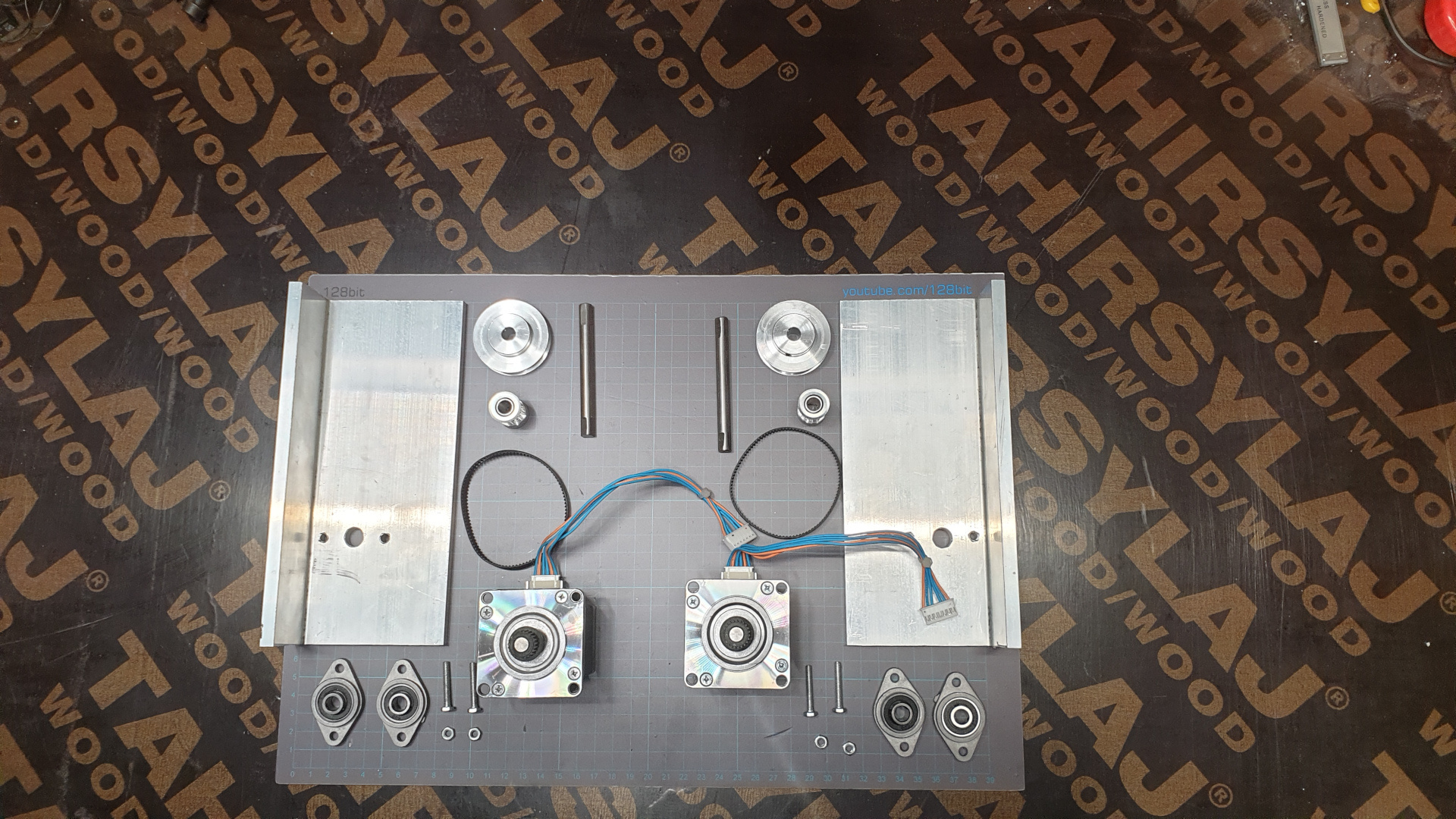

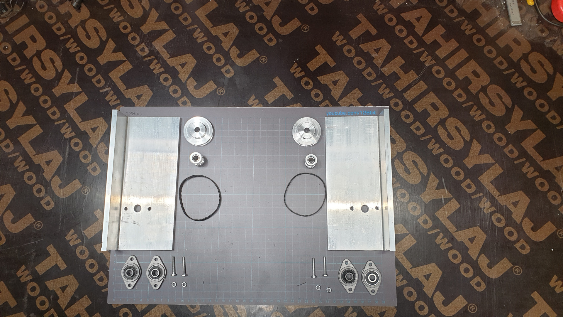

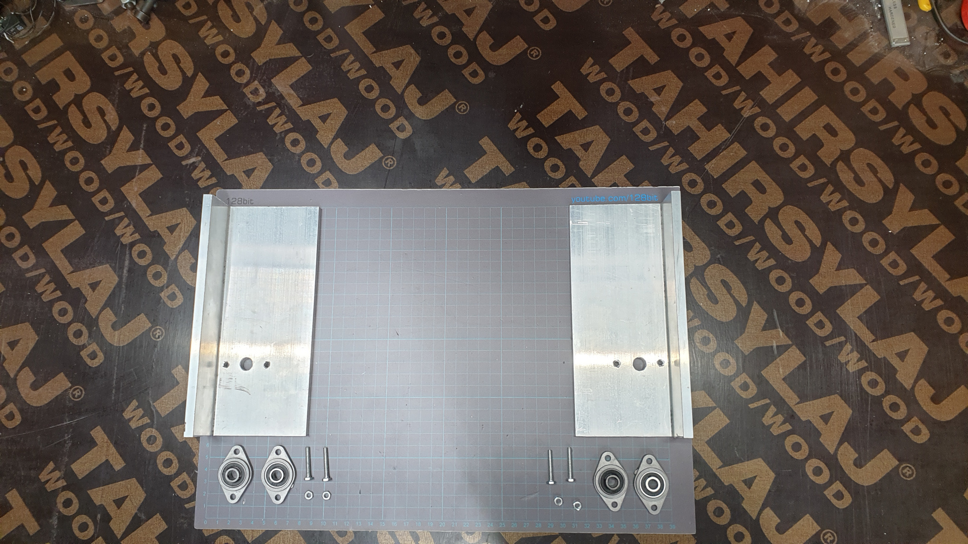

Built another two of the reductions for the big machine ( big = 3X2M cut area, small = 2.5X1.5M cut area ), so i took some pictures.

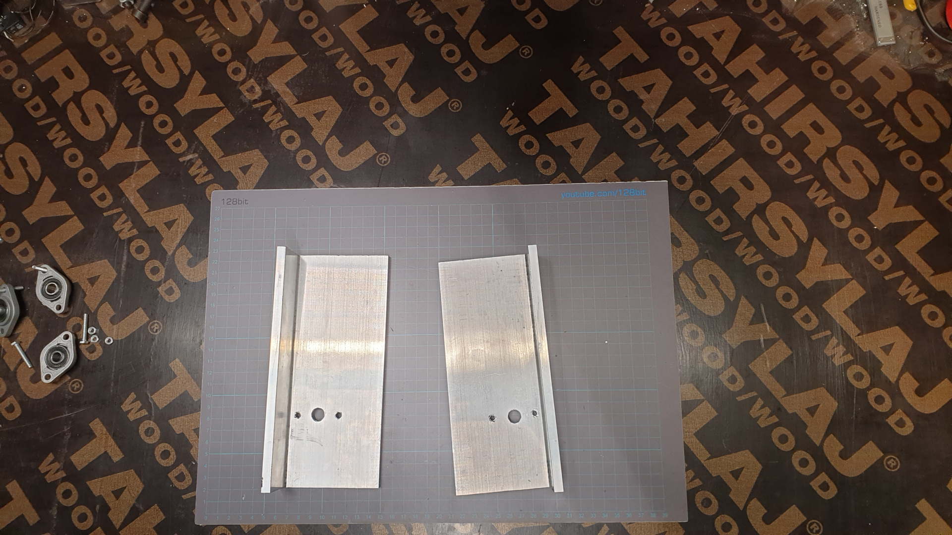

L shaped alu profile 90X50mm, 8mm thick, 200mm long, 2 pieces, holes drilled for the shaft and bearing screws:
Two bearing with holder and two screws/nuts for each side:

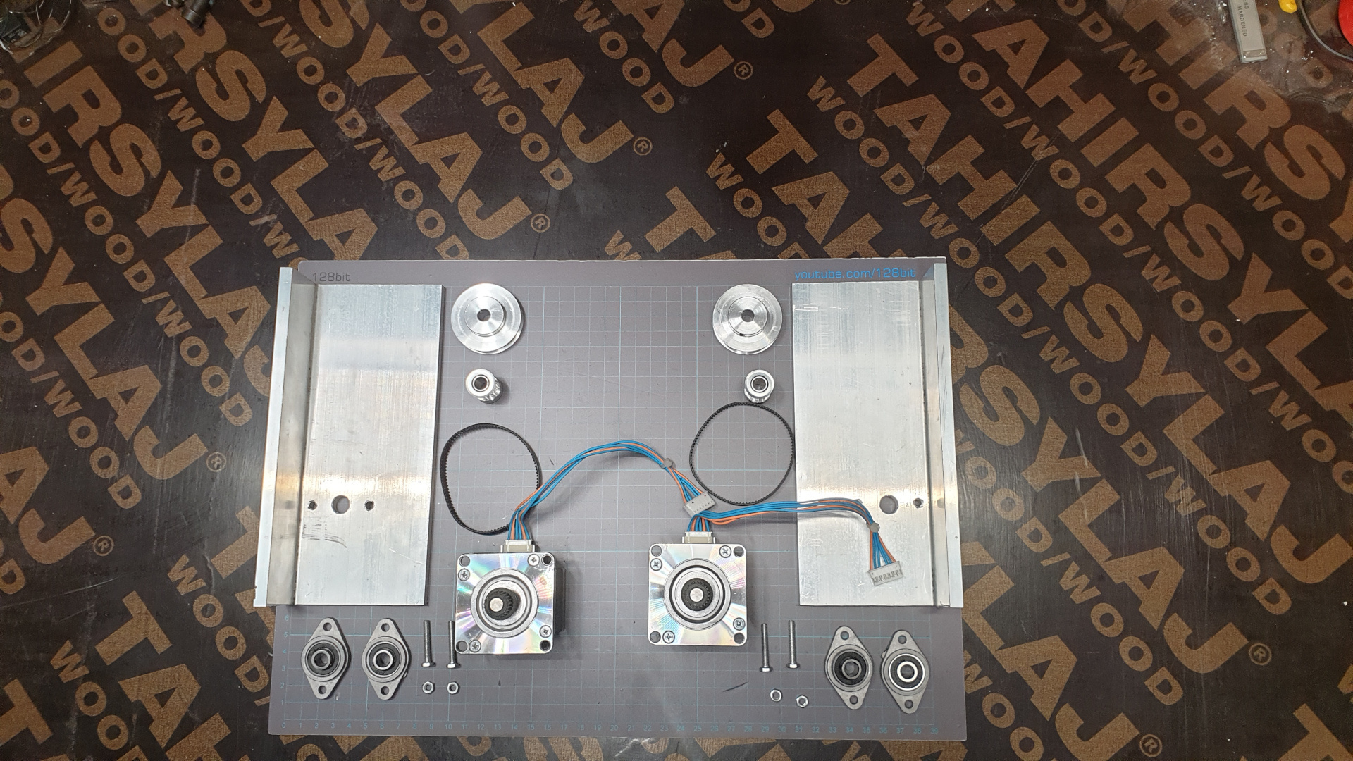

GT2 60 teeth for the motor side, motor pulley is already on the motor, and T3 15 tooth pulley for the driving side, for 15mm wide belt.
Two Nema 23 stepper motors, used ones till they are mounted on the machine, then new ones double length:
Two 8mm shafts, both sides have two ground parts to prevent slipping:

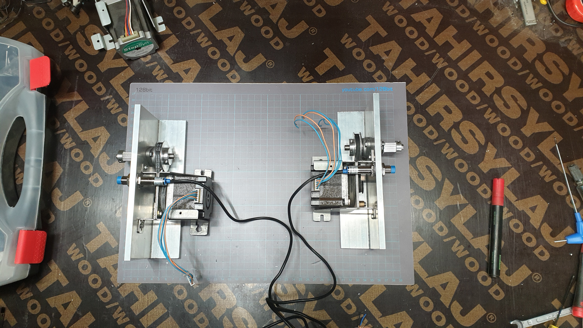

Finished gearing with the proximity sensor installed:

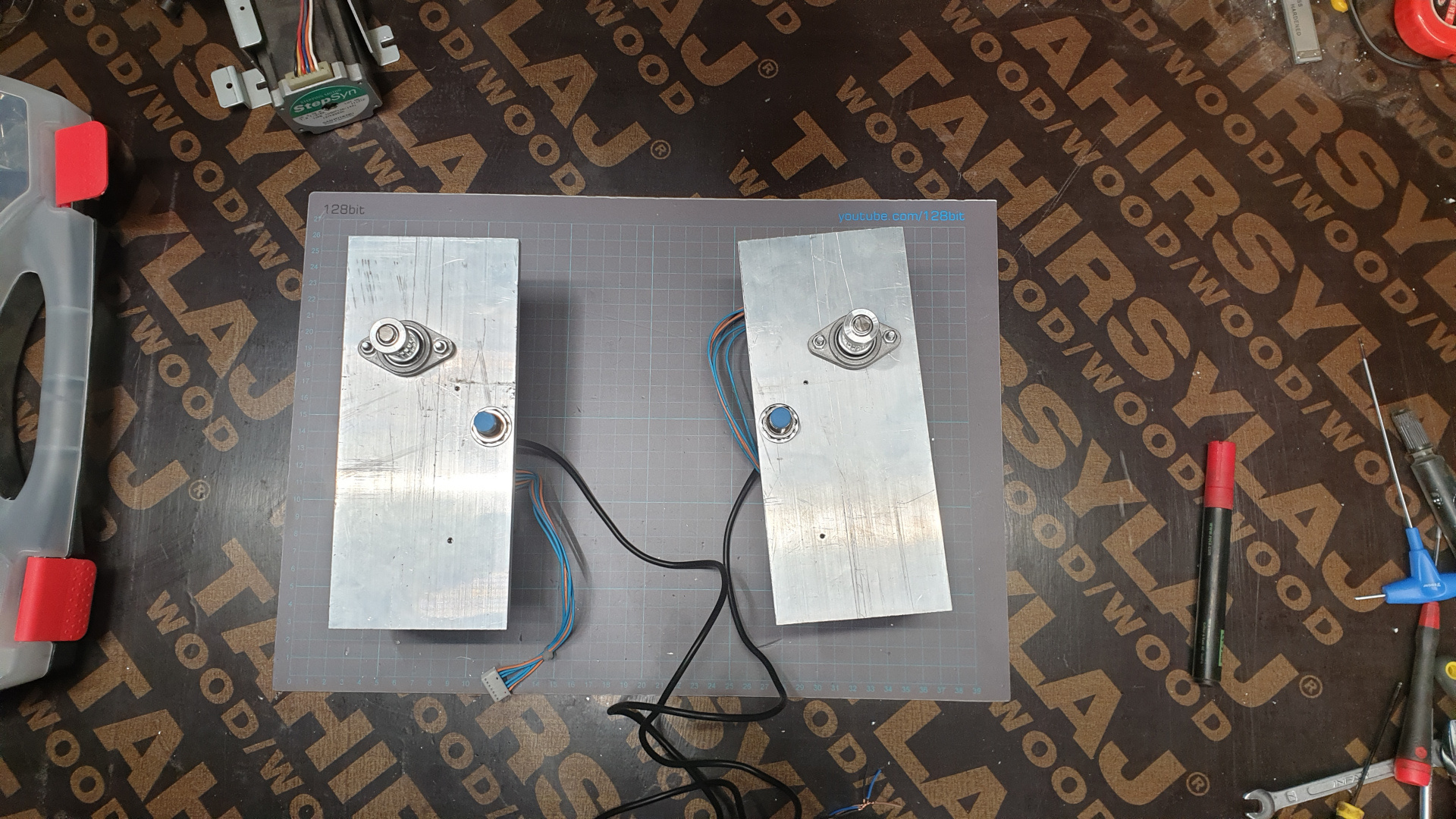

Another picture of the working side, missing an added 10mm thick 50X10mm alu part with idler bearings installed, out of bearings, so will do more pictures when i get to that:
On the small one i also installed the wide belt on the other side and sensors, will have to do some more cabling and sort the homing and limits for both sides tomorrow, see if i can pull that with just two sensors.

less is more with these machines i believe. lighter the better and you have it down to a science Tom. i had to watch the video twice just to figure out how you were driving the gantry
not only is it done to be light and just enough to do what it needs to but very cost effective in design. your a smart cookie

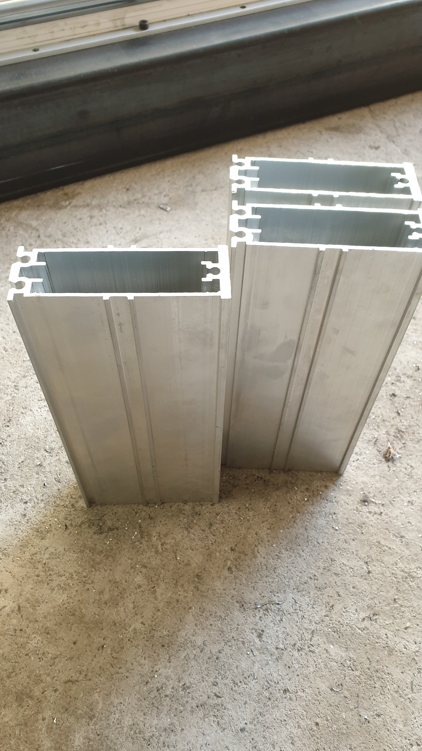

Tommy, what dimensions is that gantry extrusion. Is that what you are going to use?

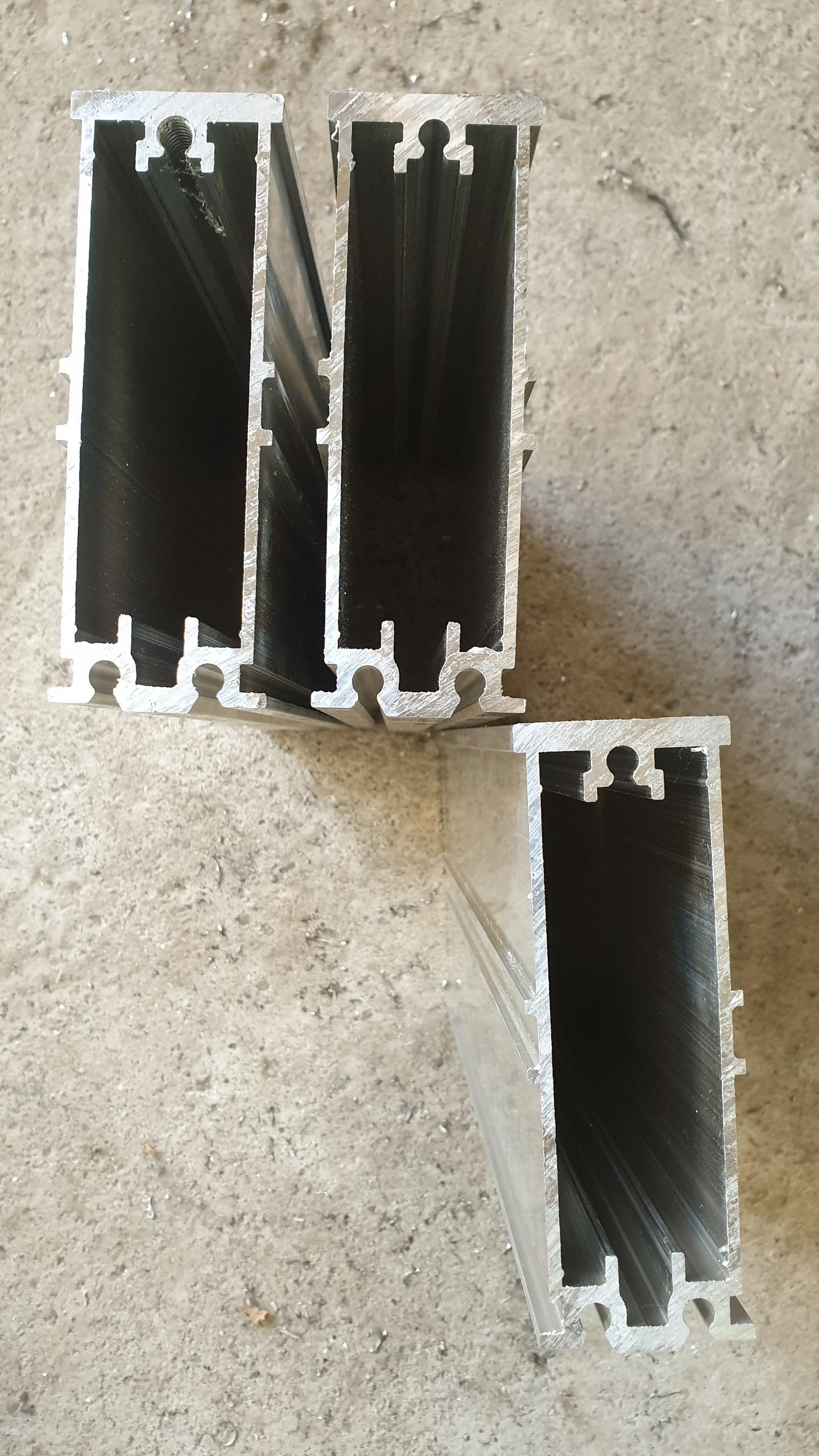

27 Apr 2020 10:52 #165786
if i ever get them in the lengths i need, they are 128X44mm, thin walls at 2.5mm and thick ones at 6mm, so at 210 and 270cm lengths should be plenty strong.
BTW i got the big guns out getting ready to do some damage! I mean the big Lam Technologies drives.
Replied by tommylight on topic 2+2+3 More Plasma builds, double the joy ! 3X2M and 2.5X1.5M cnc plasma build.
That is Bosch 45X45mm, and no i am not using that for the gantry, i will be using this:Tommy, what dimensions is that gantry extrusion. Is that what you are going to use?
- Posts: 12161
- Thank you received: 4151
27 Apr 2020 11:05 #165794
Replied by rodw on topic 2+2+3 More Plasma builds, double the joy ! 3X2M and 2.5X1.5M cnc plasma build.
cool, I used 80x40mm RHS. I think the wall was 4mm, but it could have been 3mm.
And hurry up ans slam the Lams. I wanna see them fly.

why the expensive AL profiles not a cheep Square steelbody 3mm wall 2x2"
