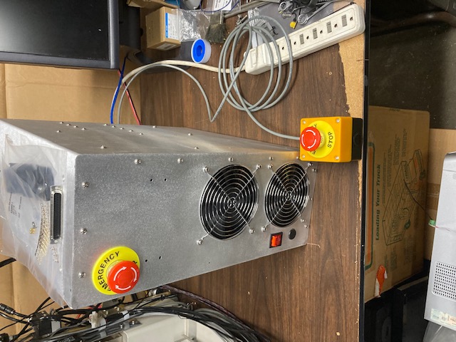

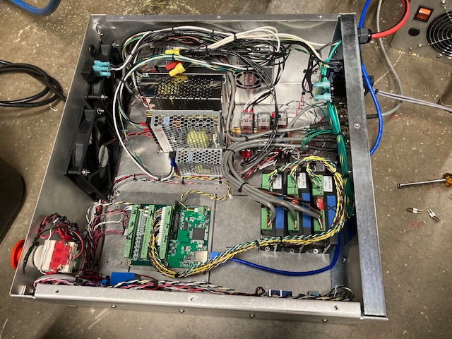

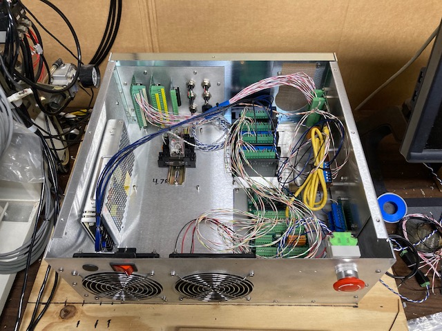

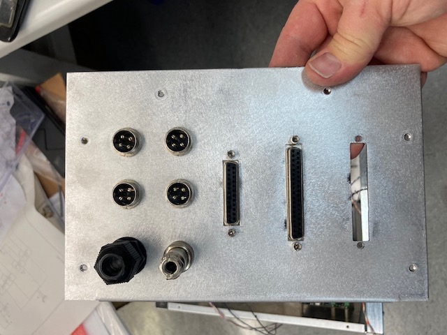

26 Jul 2021 23:36 #215995
by my1987toyota
Replied by my1987toyota on topic Manncorp ECM93 Pick and Place
IT'S ALIVE! AH HA HA HA.
A special thanks to PCW and Mesa Electronics for diagnosing, repairing, and returning
the board so quickly. Plus a New 7i71 found it's way into the return box . Now I can leave the one on the
PnP project and have one connected to my computer at my house so I can learn how
to get the feeder program working when I am at home as well. Theirs' so much to do.
Looks like it's time to get to work.

13 Aug 2021 16:06 #217689
by my1987toyota
After feeling like I have been beating my head against a wall getting Classic Ladder to do what I needed , it looks like I
FINALLY have a working feeder system. I will post a video of it working this next week.
Basically I use M64 P## to advance the feeder and M65 P## to reset for the next feeder. Below are the current codes
I am using. I hope to have a better system setup in the future using hal components and using M1## codes instead.
