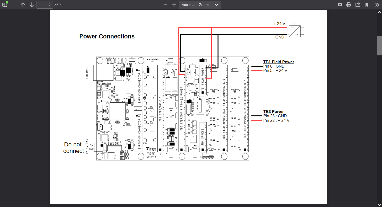

So just to clarify the below picture will work with the 7i76 and 7i76e board with the W1 jumper in the Left hand position
Otherwise connect TB1 pin 8 to TB3 pin 23 if using separate power supplies with the W1 jumper in the Right hand position .
Correct?
edit: DO NOT connect 24 volts to a 7i76 TB3 pins 22 and 23 . It will damage the 7i76.
Correct?

No, that will not work on a 7I76 . The 7I76 has only 5V power
on the logic section so if you connect 24V to anywhere on a
7I76 TB3 connector, you will damage the 7I76.

Thanks PCW . That saved an expensive mistake. TB3 pin 23 ground and TB1 pin 8 ground do still get tied together though correct?
- Posts: 18111
- Thank you received: 5330
03 Jul 2021 23:34 #213622
This would be needed if you are using the 7I76's 5V to power a MPG connected to the
field I/O section.
Replied by PCW on topic Manncorp ECM93 Pick and Place
Yes, if you want the field I/O common to be the same as the 7I76 logic section common.Thanks PCW . That saved an expensive mistake. TB3 pin 23 ground and TB1 pin 8 ground do still get tied together though correct?

Again Thank You PCW. I definitely wanted to get that answered before I go connecting things.
p.s.
After going back to the MESA 7i76e manual I can see why the above picture works for the 7i76e but not the
7i76. The 7i76e apparently has a Logic power regulator. The 7i76 does not. So yeah 24 volt to TB3 would
have been really bad.

Well I went ahead and ordered a 7i71 board so I can get back to getting the feeders controlled with Linuxcnc. I hope that makes
tommylight happy it wont be an Arduino. LOL . Looks like I will have to dive in the deep end on writing a hal. component and figure
what M code to use to trigger the feeders. My is throbbing already.
