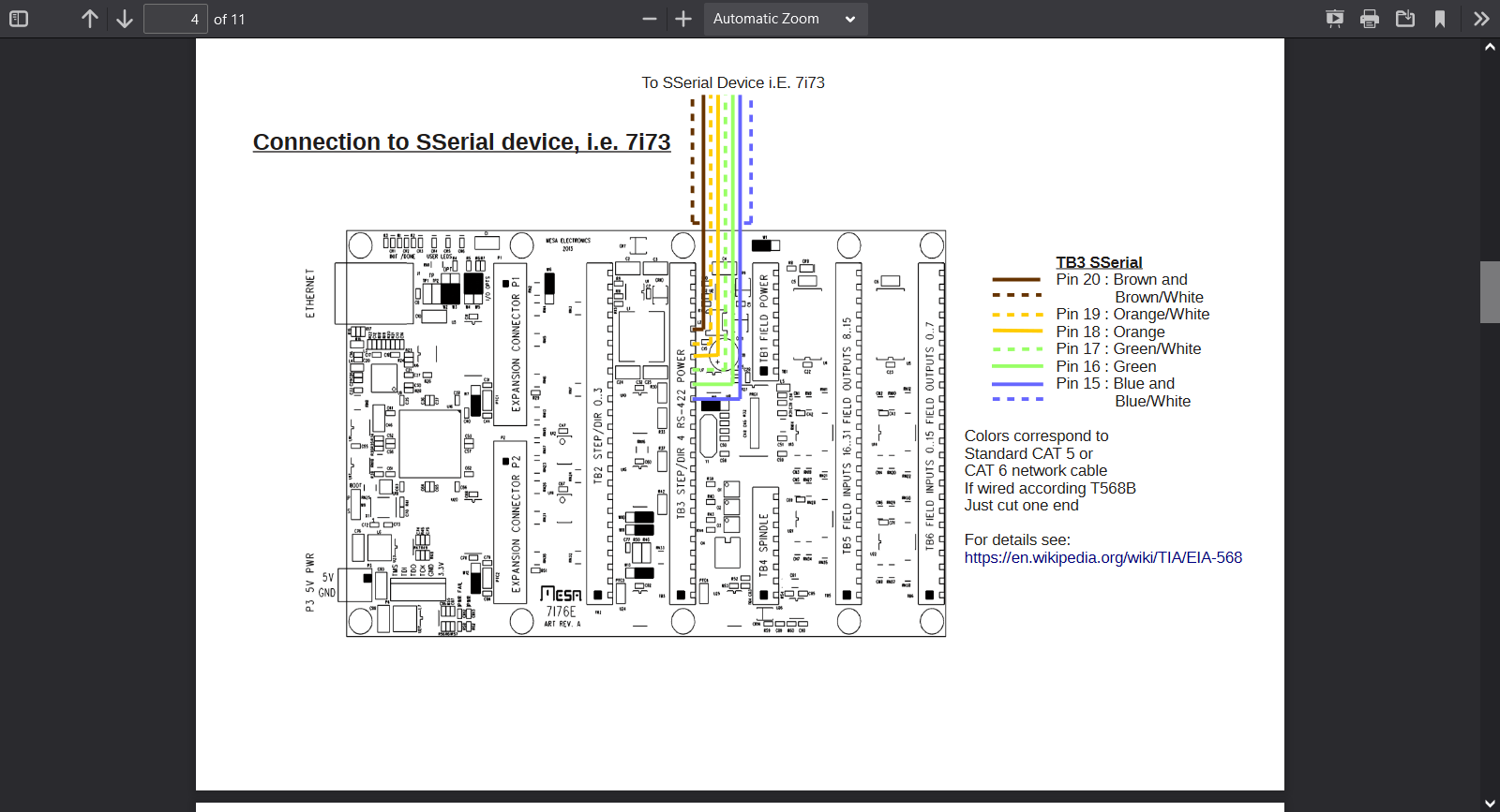

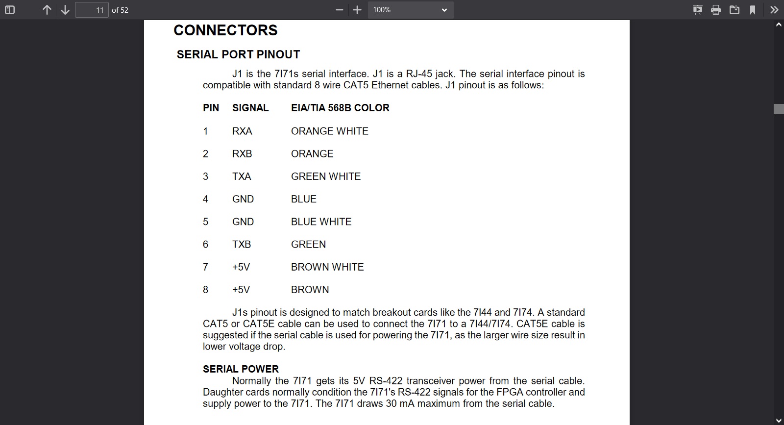

1. Do you have field power to the 7I71? (you should get a red fault light if powered)
2. How is the serial cable 7I71 connected to your system?
3. What is the hm2_pci or hm2_eth driver command line?
for rodw's question - I am wired as 568-B
for PCW in order-
1. Yes I have 24 volt field power connected. ( yes I do have the red light on )
2. see diagram
3. I think what your looking for is
loadrt hm2_eth board_ip="10.10.10.10" config=" num_encoders=1 num_pwmgens=0 num_stepgens=5 sserial_port_0=00xxxx"
This profile was as simple as possible to eliminate as many variables as I could.  Hence the sserial_port_0=00xxxx

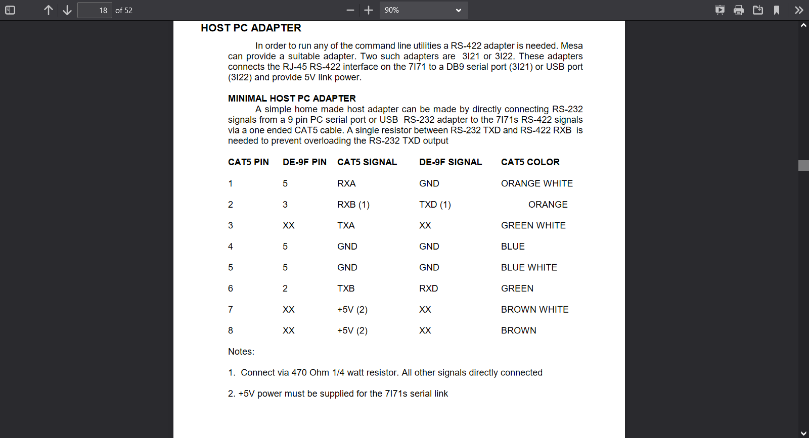

I have never updated firmware on any of my mesa card's . Is that were the " minimal host pc adapter " comes in that's
mentioned in the manual?
  My Avatar on Linuxcnc may say elite but I am still very much a noobie.
14 Jul 2021 23:48 - 14 Jul 2021 23:49 #214790 by PCW
Replied by PCW on topic Manncorp ECM93 Pick and Place
No, the host will never try to change the 7I71 firmware unless you run
the utility "setsserial"
Have you changed any 7I71 jumpers from default?
The PC adapter is no longer needed. We used to use it to change EEPROM
settings in the cards and update firmware before we could do this via the
FPGA card and Linux.

15 Jul 2021 00:33 #214795 by PCW
When I had received the board jumpers W2 and W3 were in the UP position( Weird ). Before I connected the board to anything I
moved W2 and W3 back to their default DOWN position. Other then that I haven't moved any of the jumpers.
W2 and W3 don't actually do anything so that doesn't matter ( only W4 is functional and must be up
for normal operation )
A red LED means the firmware is OK and a watchdog fault has been generated
which is expected when there are no host communications. You should also have a yellow
field power LED illuminated.
Basically the symptoms are that there is no communications, but it could also
be that a fault is present.
Can you start LinuxCNC from a command line to see if there is any additional
information reported? (not sure which GUI you are running and not all
report all errors)
