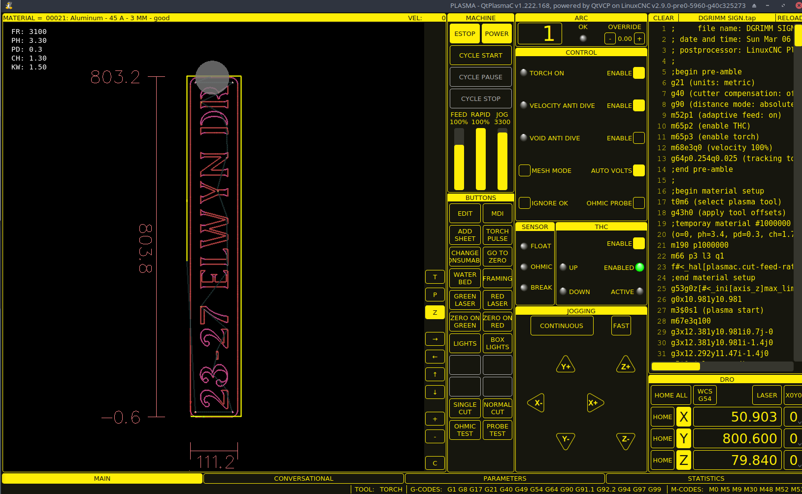

Still not working,
linux configuration safe height 20 (as per tommy suggestion), Sheet cam rapid clearance 30mm.
Z axis drives down, slows to probe, probes and cuts, goes up 8.4mm ( no idea why it only goes this high) travels to next cut, goes up, begins probe.

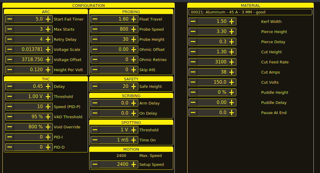

06 Mar 2022 05:31 #236478 by tommylight
Replied by tommylight on topic Homemade, cheap, plasma CNC
Post screenshots of "run" and "config" tabs please.
Jog the torch down to just under where the slats start (no material on table) then click on the "touch off" button, make sure Z axis is selected.
Also the Z axis and joint section of the ini file would help.

This SheetCam setting is not used, all Z settings are internal and set from the parameters tab.
It goes up because your Probe Height may be higher than your Safe Height.
Are you still getting the Safe Height warning? If you do when exactly are you getting it?
Can you post a backup of your config.

Yeah safe height is lower than probe height, it must be higher.
Safe height is where the torch is retracted to before G0 or before it moves from cut to cut.
I have it at 120 as my travel is 180 in total after homing, so i have space to spare.

06 Mar 2022 19:55 #236528 by RNJFAB
Replied by RNJFAB on topic Homemade, cheap, plasma CNC
Thanks guys,
I have changed the safe height to 100 and still get the same error.
The z axis only goes up to 8.4mm before travel. And gives the warning after the first cut of a job.
No doubt I have set something, somewhere and now I can’t find it to fix it.
